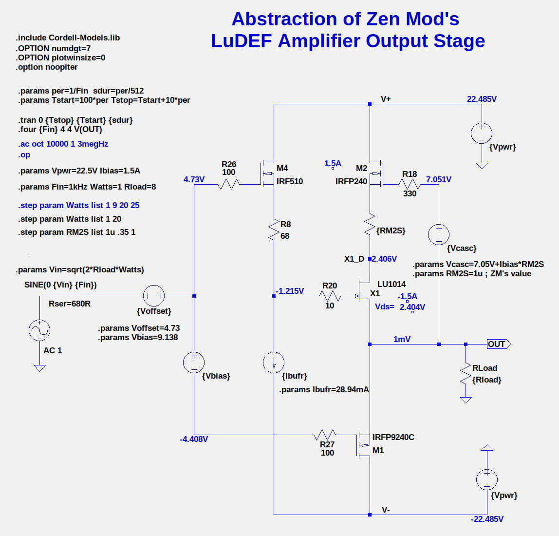

Here is have an abstracted version of ZM's LuDEF to allow both simple experiments and to more easily understand the essential parts of the circuit. Attached are 2 files: the LTSpice asc file, and the Cordell Models, needed for the IRFP9240. Place these files in the same directory as the files ZM provided in post #178.

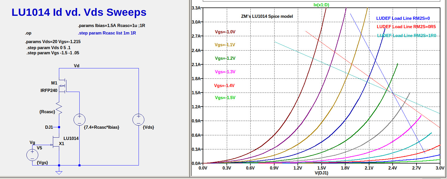

Here is another simulation file for plotting the triode curves for the cascoded LU1014.
The triode curves in plot on the right was generated by this simulation, but the load lines were manually added to the plot. The load lines were generated from the LuDEF simulation asc file.

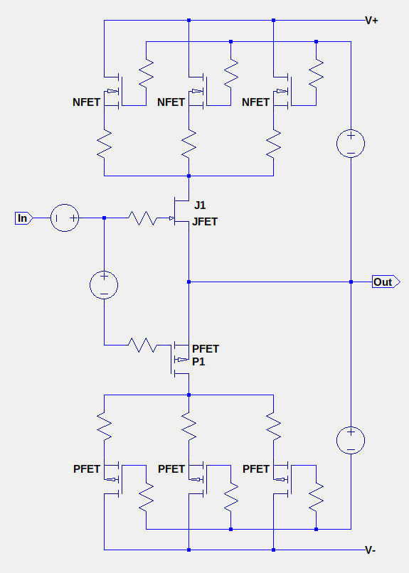

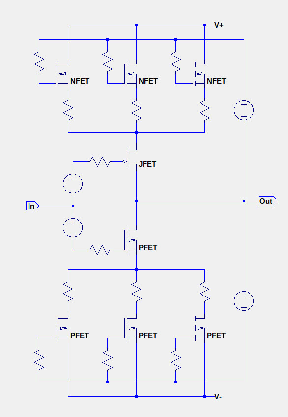

Oops. I just noticed that the PFETs in post #195 are upside-down (stupid default part orientation in LTSpice). Here is the corrected image.
More explanation about that topology. It allows for the driver FETs J1 and P1 to have low Vds values, but high idle currents, while the remaining NFETs and PFETs have high Vds and a fraction of the idle current. This allows for a high power amplifier to be driven by just the two undegenerated FETs J1 and P1.
I suspect this has been tried before, maybe in a commercial product. Anyone know?
