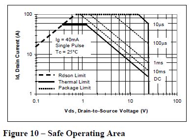

Running that much current through these things will require better heatsinking. They are tiny - much smaller than TO220. JPS64 and I are thinking of making an aluminum core PCB adapter that will allow these LU1014’s to be mounted and resemble a TO-247 package. It will provide a heat spreader to broaden the area for thermal flux to pass to the heatsink.
5A x 20v drop is 100w dissipation. I wouldn’t want to put more than 20w each on these so we are talking 5 LU1014’s in parallel for a 100w amp.

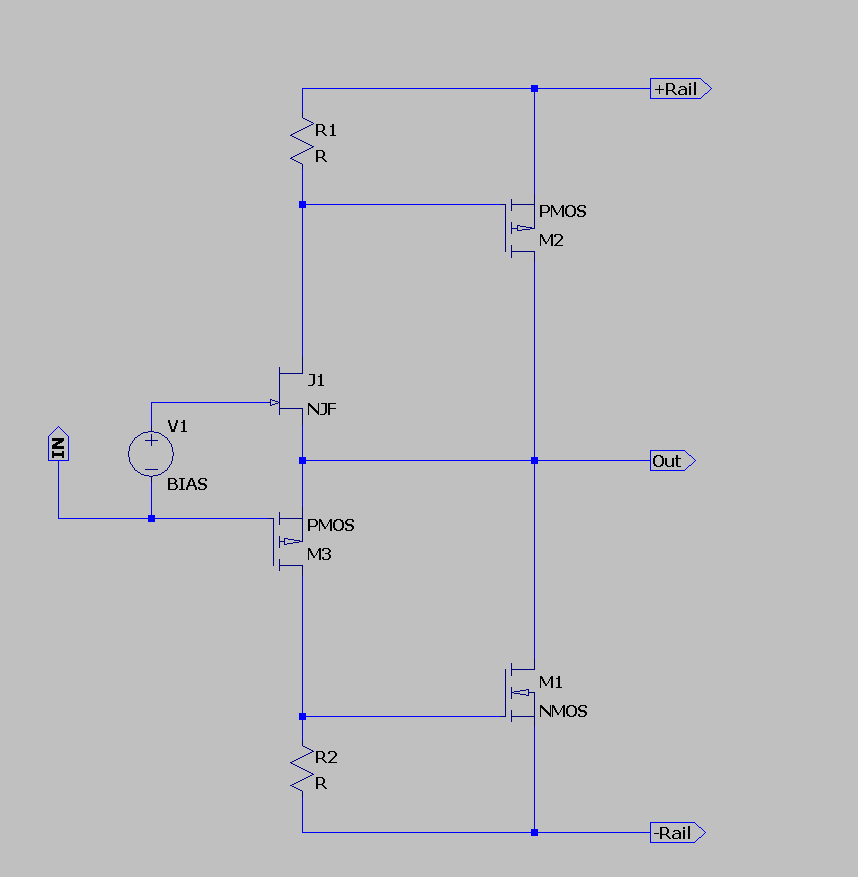

when I mentioned Stasis,this came to mind - adequately biased NP pair (of JFet + Mosfet) but also just one pair of big mosfet outputs, which is possible if we use big Pucks
at least logical for me - when going Square Law route, paralleling is either tricky or impossible, so using single pairs is pretty much sole viable solution

I'm not so scared of heat, as I'm scared of current through tiny bugger
for all sane currents, heatsinking is adequate and all you can do with any other arrangement is just going to ease mounting

I just found this article about the current limits of MOSFET bond wires:
http://www.aosmd.com/res/application_notes/mosfets/Continuous_drain.pdf
Based on the LU1014D datasheet, the circular cross section of the leads appear to be about 0.4 mm^2 which corresponds to about AWG 21 wires.
Magura had his LU soldered to copper sheet, then using massive Carbon heat spreaders, in his circular shaped beasties
Thanks for that. I sort of recall now. The copper blocks look nice. Doesn’t solve the problem with tiny leads. Hopefully the adapter/helper PCB will give substantial spots for leads to be soldered to.
Thinking about current hogging and bond wires, couldn't a parallel/tripled/etc F3 be done with separate output caps for each F3 clone, and tying them together after the caps?

well, make your mind - either low/semi power A class amp, finely tuned as Minarelli 50cc ...... or big honking/low rails/high current amp
hard to have everything ....... big pucks are not liking low voltages, IRFP sorta same , LU right there, but wimpy wires .......
of course, if you introduce output xformer, The World is your Oyster
it seems changing back to sane impedance drivers is simplest
American Wire Gauge Chart and AWG Electrical Current Load Limits table with ampacities, wire sizes, skin depth frequencies and wire breaking strength says 21 AWG should be able to handle 9 Amps; another chart I got elsewhere says about 7.25 Amps.
You have to adjust Vds against Ids to be at or near the sweet spot, and at those
currents you might find yourself at higher dissipation than you allowed for.
