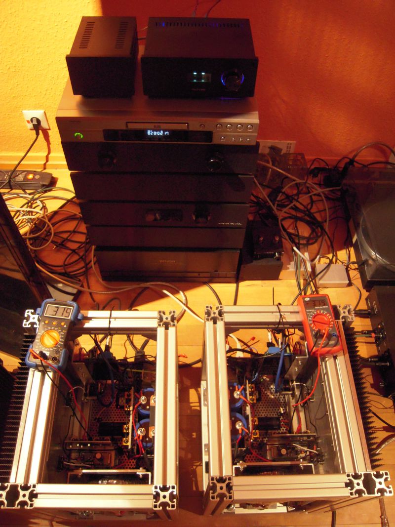

Could you show more views of your packaging? I am always interested in packaging techniques, particularly ones that facilitate prototyping.
- I suspect there might be FETs capable of 150W+ idle power dissipation, but extraordinary measues are required to carry the heat away from single devices. BTW: what IXYS FETs did you use?
- By paralleling 4X TO-247 FETs I limit the idle power dissipation to under 45W each and spread the heat across a "more normal" heatsink.
- You are correct to be concerned about all of the current through the tiny leads of the LU1014D.
- It should be deal with 6.6W-10W idle power dissipation of the LU1014D.
- Nelson used goop to anodized aluminum for the F3.
- F3 cloners soldered them to copper spreaders.
- Another option is goop to a copper spreader atteched to the heatsink with good and insulator.
If by packaging you mean how to mount an IXYS TO-264 to a Dell CPU cooler, more is shown here.
Clamp bar, flying leads, ceramic insulator, and goop. Photo shows second TO-3P BJT used with only 15W dissipation (part of cap Mx). So total dissipation was 165W. Noctua fan was on not lowest speed but one tick above. Still very quiet.
Get the Dell coolers with a big fat copper surface.
The IXYS was IXTK90P20P P-channel. This was for a slightly different config than basic Mofo.
Do those pucks operate within the SOA? Sounds like CPU cooler time for the pucks.
200W voltage envelope, still less than 10A which I believe is magic number
good thing that Physics ...... current peak is when voltage across device is on minimum , and the other way
XRK, by packaging, I think Lynn is referring to the slick modular frame system that you are using.
MakerBeam rocks!
