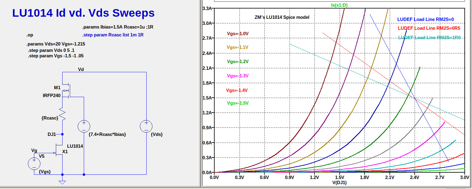

I am new to all this SIT business. So is the LU1014 kind of like a SIT in behavior based on these graphs?

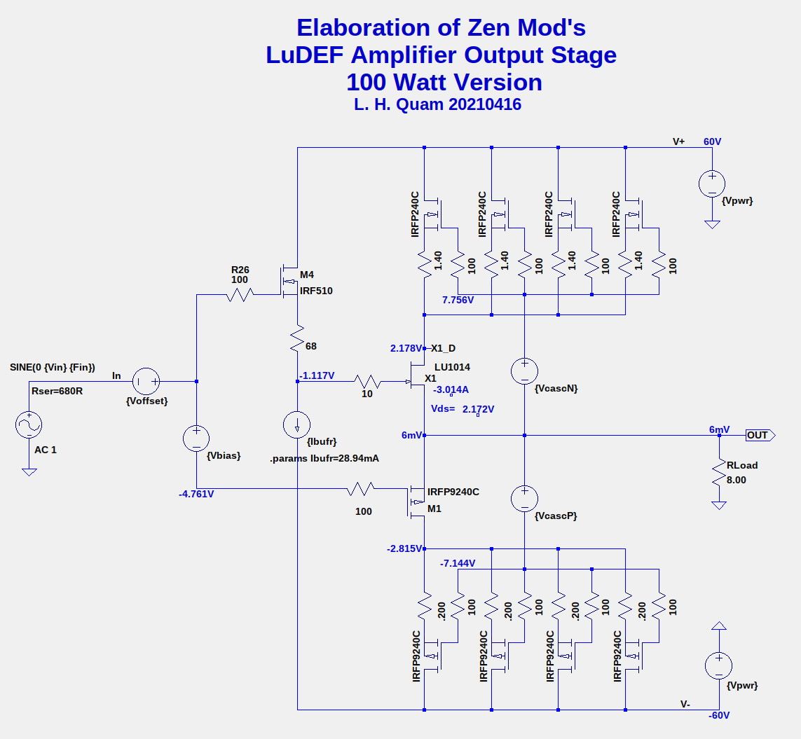

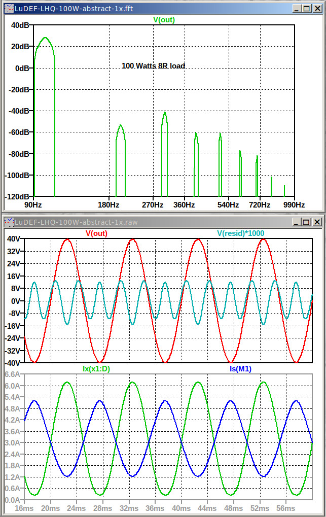

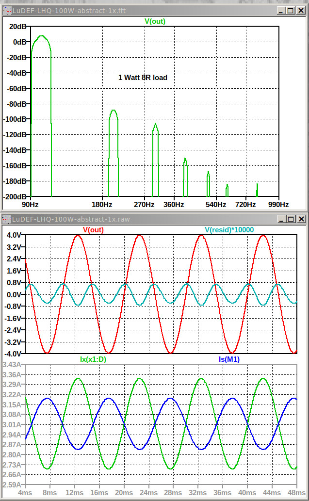

Here is a simulation of a 100 Watt (into 8R load) amplifier using a single LU1014D dissipating only about 6.6 Watts at idle. The results are hard to believe.
Attached is the fourier listing:
Looks like super result. But why are we paralleling 4x TO-247’s when the little pinner LU takes the full brunt of all that current?
I have used these before. They are small and do not have sufficient surface area to extract heat effectively.

  • I suspect there might be FETs capable of 150W+ idle power dissipation, but extraordinary measues are required to carry the heat away from single devices. BTW: what IXYS FETs did you use?
  • By paralleling 4X TO-247 FETs I limit the idle power dissipation to under 45W each and spread the heat across a "more normal" heatsink.
  • You are correct to be concerned about all of the current through the tiny leads of the LU1014D.
  • It should be deal with 6.6W-10W idle power dissipation of the LU1014D.
    • Nelson used goop to anodized aluminum for the F3.
    • F3 cloners soldered them to copper spreaders.
    • Another option is goop to a copper spreader atteched to the heatsink with good and insulator.

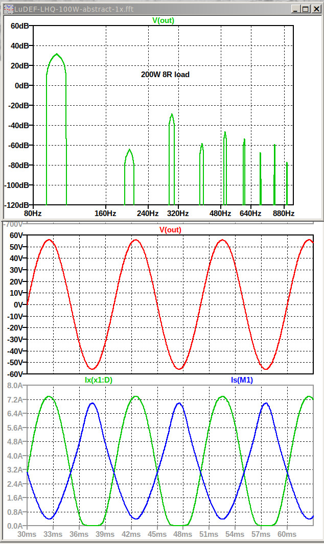

I ran the same simulation as before at 200W:
Harmonic Frequency Fourier Normalized Phase Normalized
Number [Hz] Component Component [degree] Phase [deg]
1 1.000e+02 5.594e+01 1.000e+00 -0.00° 0.00°
2 2.000e+02 8.962e-04 1.602e-05 -102.29° -102.28°
3 3.000e+02 5.292e-02 9.460e-04 0.46° 0.47°
4 4.000e+02 1.684e-03 3.011e-05 82.37° 82.37°
Total Harmonic Distortion: 0.094663%(0.095558%)
