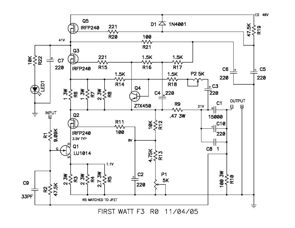

Just curious, what will be the matching parameters (Vds, IA) to use (for a sane build 😀) ?
Vds => 15V-ish?
ID => 1A-ish?
F3 schematic attached. It appears that the LU1014 lives at 2.4v Vds at 1.5A Ids. That will be where they are matched. While I am at it, I will measure Rds and DC transconductance at 1.5A. The measurements will be at room temperature for matching purposes. At operating temperature in your amp, the device behavior will likely be different. Hopefully the matching will remain. No guarantee. Should be much better than two random devices.

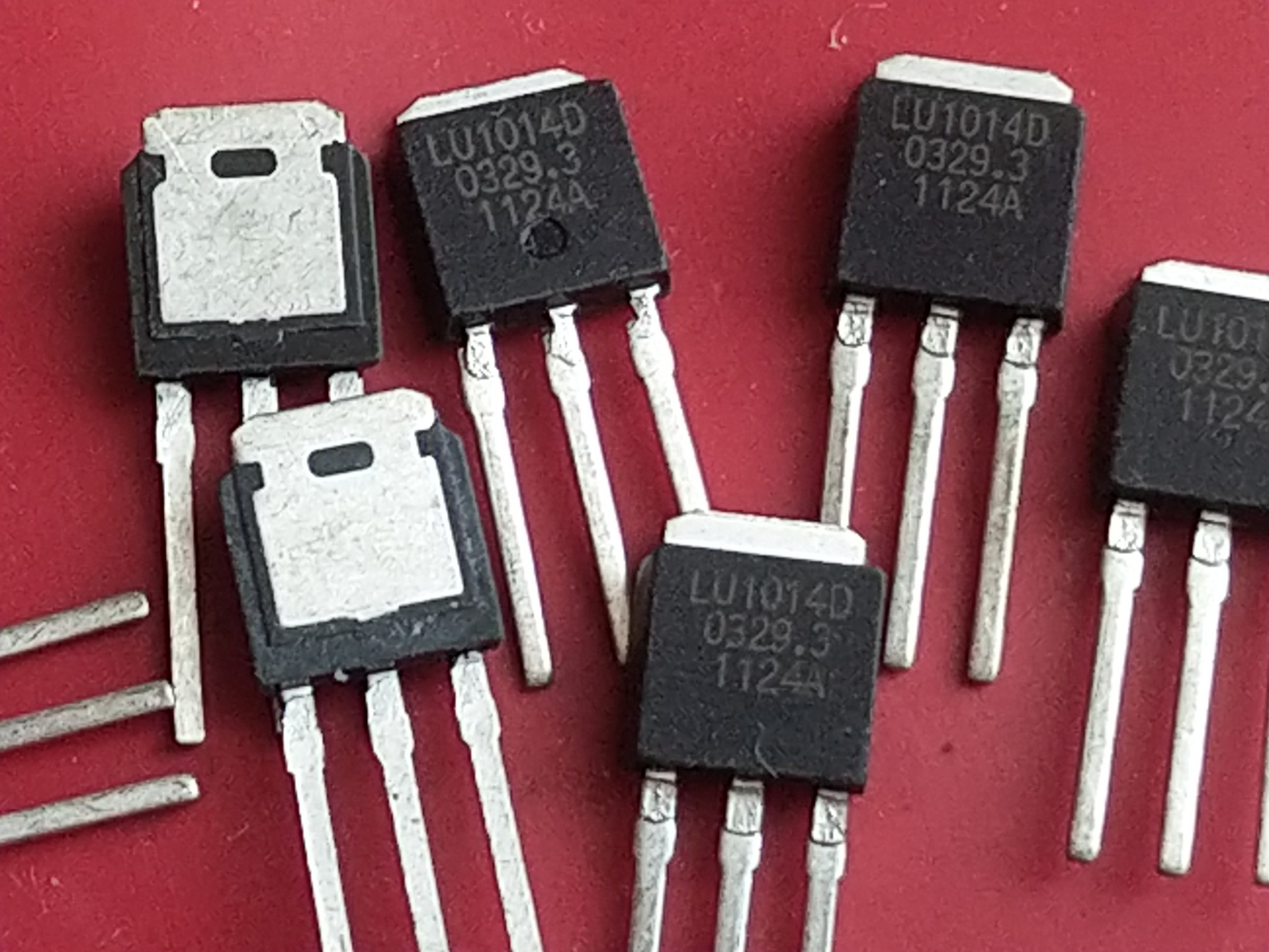

I bought some LU1014D on AliExpress.
They look refurbished, you can see that new legs have been attached.

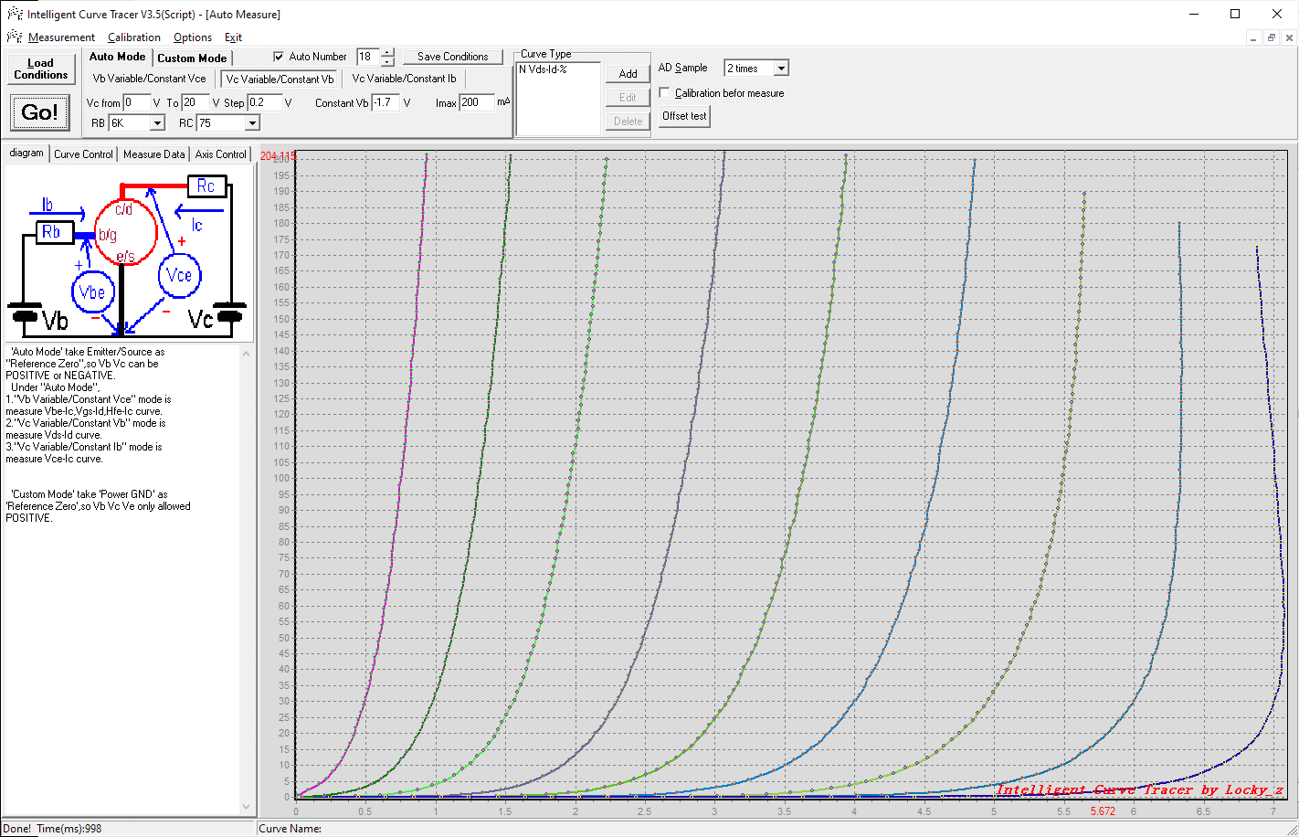

Here's a trace I did for one LU1014D:
Vc from 0 to 20v, max 200ma (without heatsink)
Vb -0.8 to -1.6v in steps of 0.1v,
so each trace corresponds to a different Vb
What do you think, real enough ?
That is exactly what my cure tracer produces. You also have the wonkiness after 5V that I observed.
