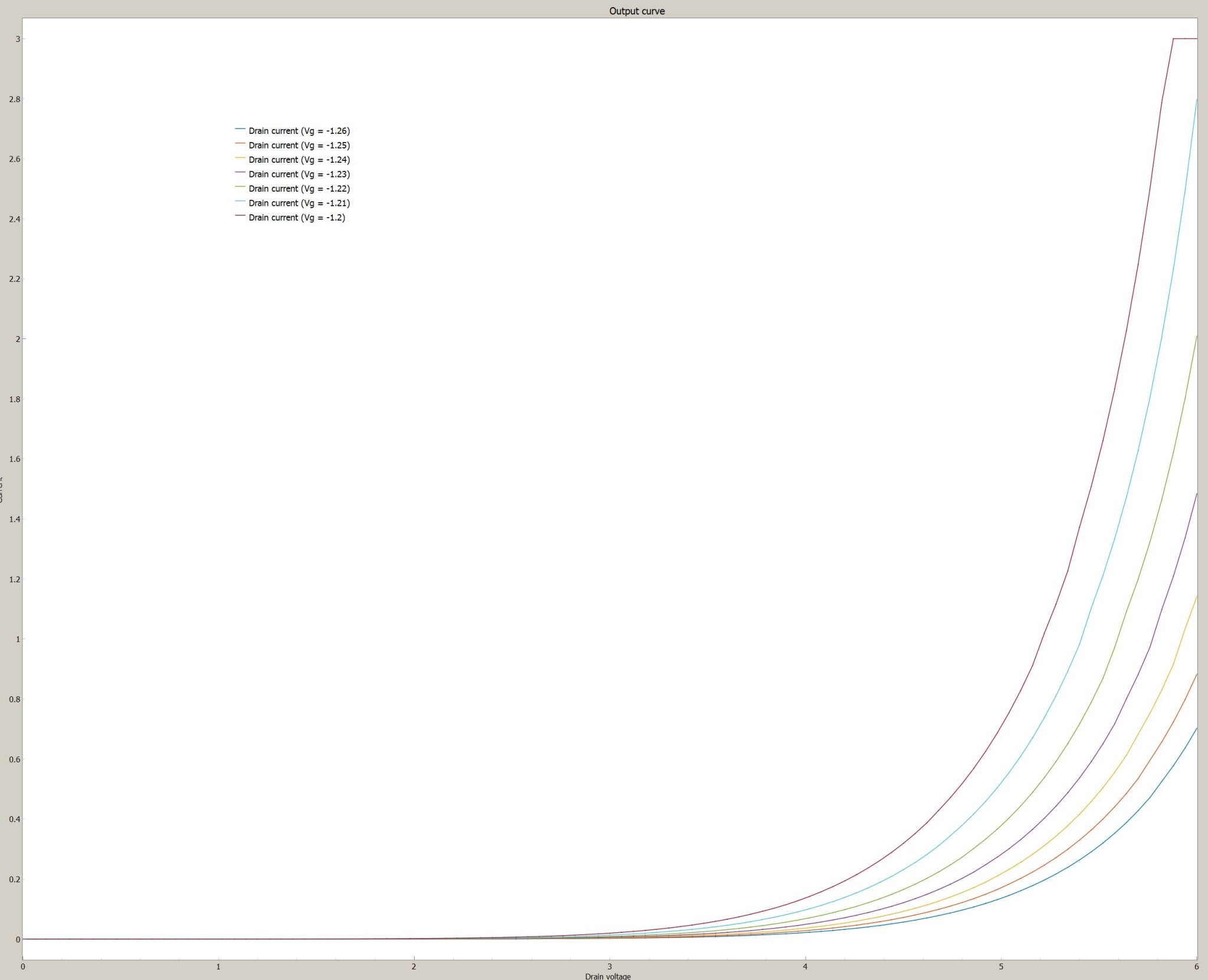

@lhquam That 5.1 Vds operating point in your measurement jig is not a good choice if you ask me. It may be fine for some parts, but for others it will be at the edge of the sane operating range. See attached example. I'd go with 3 or 4 Volts, which should be more universally applicable.
I agree. I redid some of the simulations and gm and mu decrease, but not a lot.
Even if the gm and mu values are as in that exhaustive list of measurements, there are ample numbers of LUs with gm over 7S and mu over 4, which results in gm[casc] > 5.1S, which is still good.

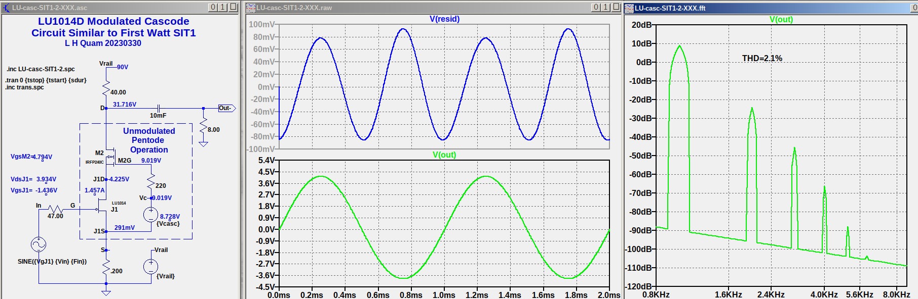

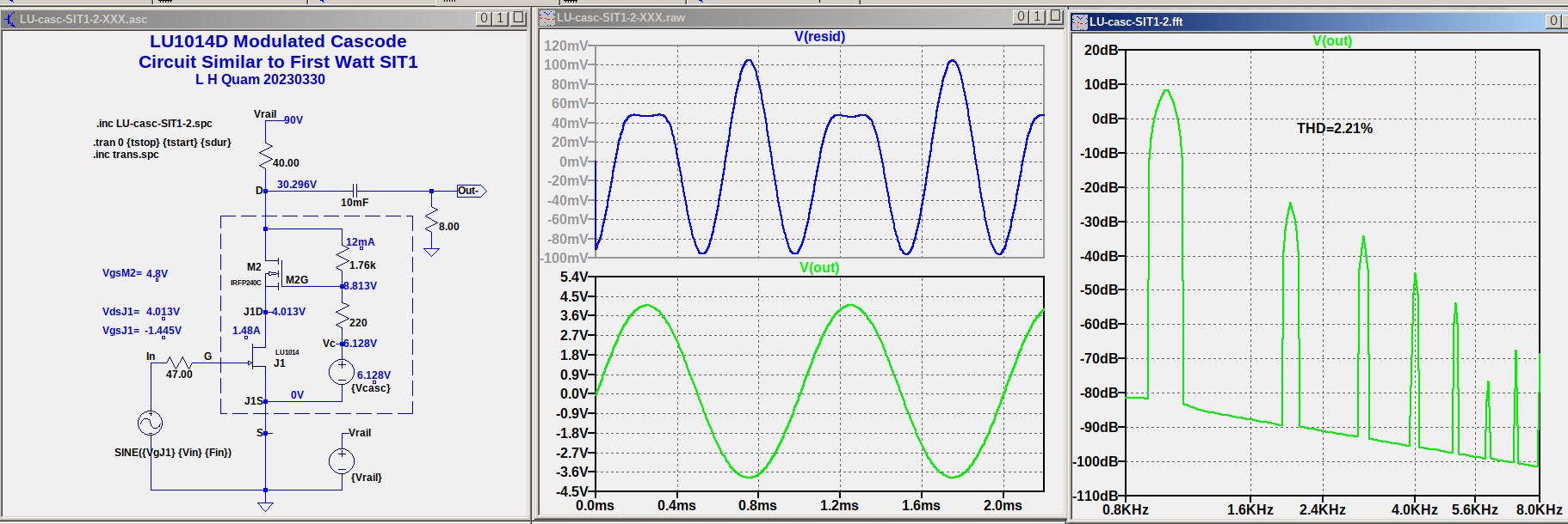

I have been simulating a single-ended triode circuit similar to the First Watt SIT1 using the LU1014D modulated cascode circuit.
(Note: I have introduced a new parameter A=1/k, which is the Vds expansion factor of the circuit.)
The issue that I am experiencing is the very high voltage gain of the circuit because of μ[casc]=A*μ[J1]. Without global feedback to reduce the gain (and distortion), this makes the distortion much higher that desirable.
In the images below I show two examples:
Image 1: A=9 Ibias=1.5A VdsJ1=4V
Gain=40 (32dB), THD=2.21% OK harmonic spectrum.

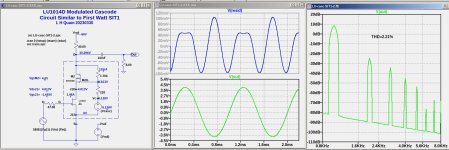

Image 2: A=inf Ibias=1.5A VdsJ1=4V Rs=0.2R
Gain=24 (28dB), THD=2.1% Better harmonic spectrum.
The cascode is not modulated => pentode behavior.
Source degeneration used to limit voltage gain to 28dB.
These are not very promising results for a SIT1 type amplifier.

https://www.passdiy.com/gallery/amplifiers/zen-variations-8
"In the case of JFET part LU1014, we note that with a gate voltage of –1 volt, the curve is concave below about 5 amps and 4 volts.
In this range it has that triode character, and this is the area of interest to us here."
The problem with this plot is that 90% of the information on the plot is not where the device would be used in a linear amplifier.
The attached plot shows ~2A from the top plot to the bottom plot with 60 mV traversed for a gain ~33.
The measurement of the LU1014D gain parameter requires a 4-wire Kelvin measurement. If you rely on the power supply to measure the voltage, you are placing the cabling resistance in the drain and source. This resistance knocks down the gain.
The curve traces look different when disabling remote sense (4-wire Kelvin)
