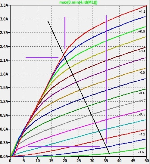

From eyeballing the curve plots:The Vg steps are from -1.6V to +1.2V by 0.2V.
- Current gain (fixed Vds) is about 1 A/V both for the LU alone and the modulated cascode
-Voltage gain (fixed Id) is about 1 V/V for the LU alone and about 10 V/V for the modulated cascode.
Why/how does the IRFP240 contribute to the voltage gain?

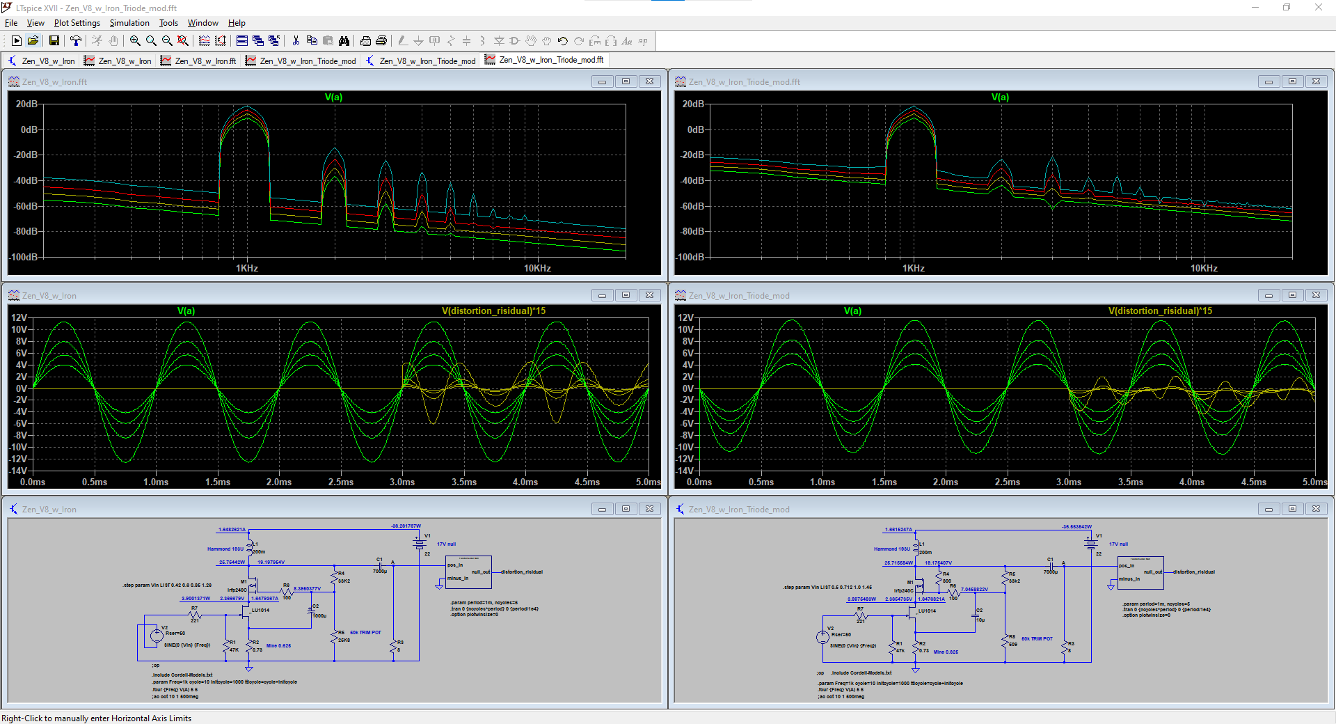

Here's an example of an actual amplifier.
I've been listening to what I call a LuAmp for a while. It's NP's Zen Variation 8 with choke loading instead of the light bulb loading (Choked F3?).
Look at what the modulated cascode does. Sim is 1W, 2W, 4W, 8W
It lowers the distortion by half and is more H2, until H3 rises at 8W. Also notice the phase of the H2 is different. I would flip speaker polarity to get -H2 after this Triode mod.
I had to fiddle with to find a capacitor value that worked for my existing bias pot arrangement.
Thanks for the work on this triode idea.
Cinco
Cinco
Gain = - ( ∆ Vout / ∆ Vin ) = - ( (35 - 20) / (1.0 - -1.4) ) = - (15 / 2.4) = -6.25x [16dB]So what is the gain ?
Load line = (35 - 20) / (2.2 - 0.2) = 15 / 2 = 7.5Ω
(approximations)
A lower output impedance: Zo = (42 - 20) [V] / (1.8 - 1.3) [A] = 22V / 0.5A - 44Ω
As a 'pentode' (common source circuit) 40 / 0.1 = 400Ω (visual approximation)
No, as an amplifier (common source circuit).
It resembles a V-fet, the drain is a low impedance amplifying output.
The curves bends wrong compared, and there is less linearisation.
The much sought-after electronic holy grail.
