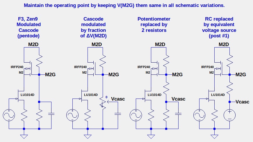

Perhaps this image will help explain Vcasc.
The left schematic shows a fragment of the F3 (or Zen9) modulated cascode which has a voltage divider between M2D and ground with a large capacitor across the lower resistor.
In the remaining schematics the cascode is modulated by a fraction of the AC voltage of the drain of MOSFET M2,
with the 4th schematic being that of post#1.
In all variations, the quiescent (idle state) voltage at M2G is the same, maintaining the same operating point (bias current and LU1014 Vds).

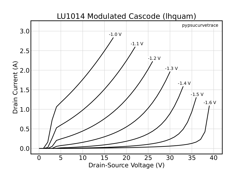

Don't worry. I built the modulated cascode circuit as described and gave it to my curve tracer. Once the magic smoke was out, and new parts were in, the curves looked as in the attachment. Pretty cool!
Did I just build a holy grail?

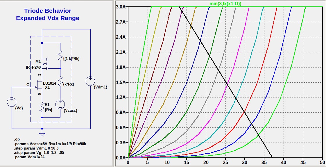

Here are even better triode curves with Rs eliminated (Rs=1m). Be very careful to limit the current range or will will have more smoke. Also shown is an 8 Ohm load line.
See measured curves in the attachment. There is something funny going on a low voltages, and the curves are compressing at high voltages.
Poor man's SIT, with an easier gate to drive. :djinn:
..... if you can keep the oscillation under control.

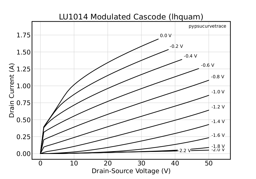

Well, the LU is a SIT, but it's cheap and abundant. I am not concerned about oscillation, since my build is a rat's nest with looong wires and looooops. It seems to behave ok.
