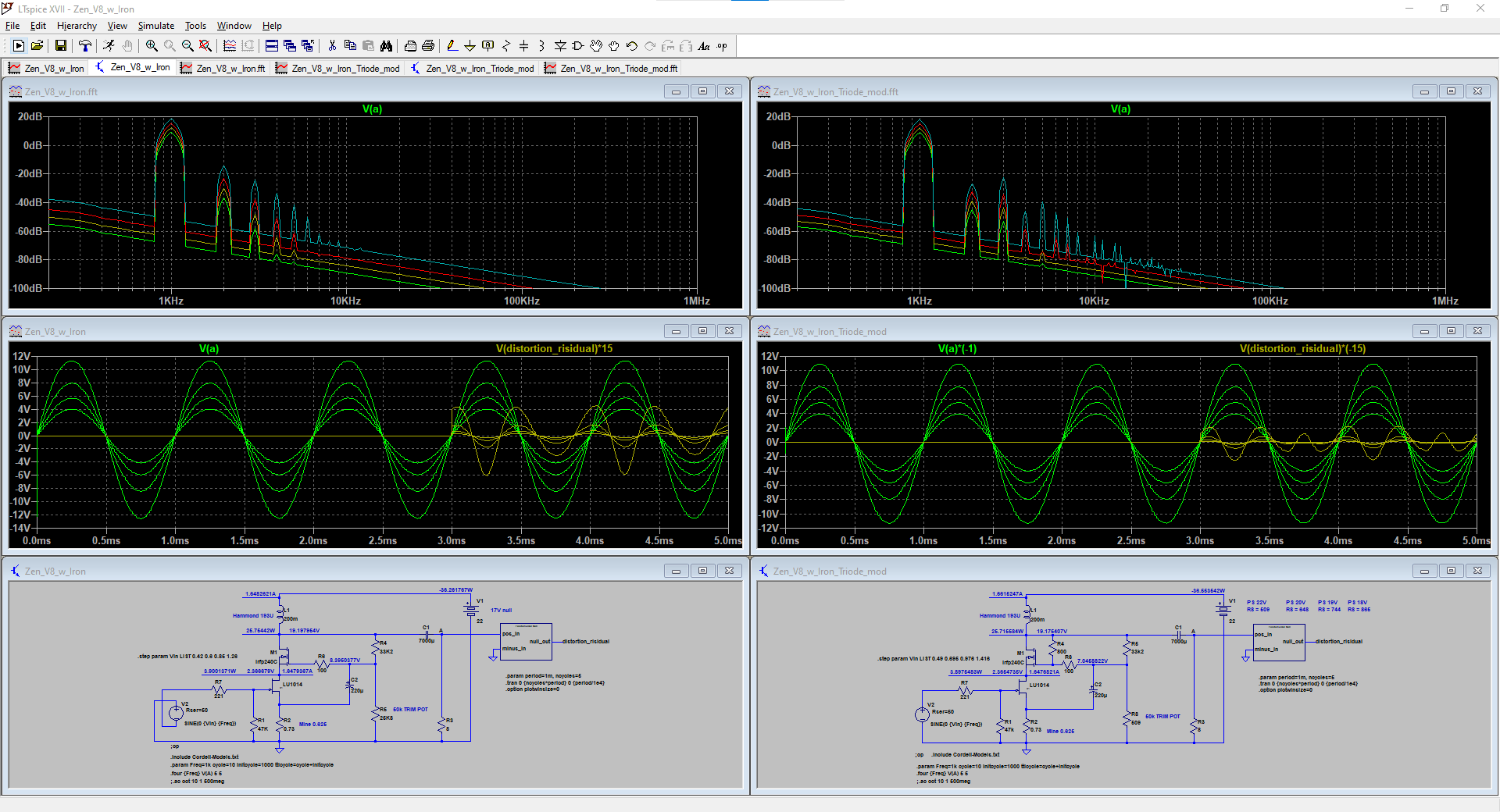

I revised my sims from post #31 with a 220uF cap, the 10uF was too low and rolling off the low end early.
Yep, it'll be SET driving efficient loudspeakers when I try this in vivo... I think I'll like the sound even better at half the distortion. :cheerful:
I inverted the scope plots to show speaker polarity inversion, maintaining -H2 for the triode mod.

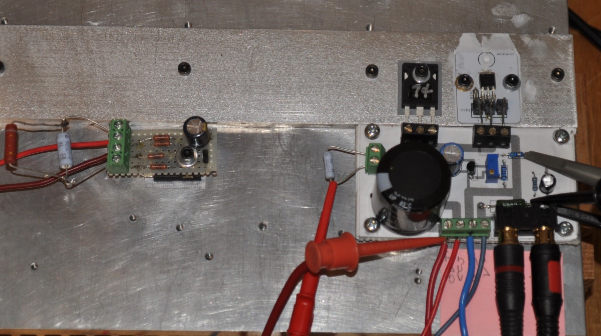

I have performed both simulations and bench tests of the LU1014D modulated cascode in a SIT-1 style amplifier, shown in the first image below, where a constant current source (CCS) is used in place of a chain of resistors, primarily because I didn't have suitable resistors for the bench tests.
It is easy to measure the voltage gain of an amplifier driving different output load resistances. From those gain measurements one can calculate the output impedance (Zout), and the voltage gain without a load (Vgain[inf]) as follows:
Zout=(Rload_1*Rload_2*(Vgain_1-Vgain_2))/(Rload_1*Vgain_2-Rload_2*Vgain_1)
Vgain[inf]=((Rload_1-Rload_2)*Vgain_1*Vgain_2)/(Rload_1*Vgain_2-Rload_2*Vgain_1)
Measurements:
Simulation:
30.6 gain with 4R load​
43.2 gain with 8R load​
Zout = 5.6R​
Vgain[inf] = 73.4​
μ[casc] = 73.4​
Rd[casc] = 5.6R​
gm[casc] = μ[casc]/Rd[casc] = 13.1S​
Bench Tests:
26.1 gain with 4R load​
39.4 gain with 8R load​
Zout = 8.31R​
Vgain[inf] = 80.3​
μ[casc] = 80.3​
Rd[casc] = 8.31R​
gm[casc] = μ[casc]/Rd[casc] = 9.67S​

Holy Grail turns into Fools Gold
I thought I had something really interesting when I first simulated the Vds range expanding LU1014D modulated cascode and discovered that it preserved the triode behavior of the LU. The Holy Grail?
What I didn't consider at that time were the resulting triode parameters and their effect when used in an actual power amplifier.
Bottom Line:
Main problem with this modulated cascode is that the voltage gain μ[casc] is way to high, being magnified by a factor A = 1/k = 9.15 in these examples. The amplifier works, but the distortion and noise level is considerably higher than that of the FirstWatt SIT-1.
The only ways I know of for reducing the amplifier gain are global negative feedback and source degeneration, both of which defeat the purpose for having a triode. A FET with pentode behavior will work quite well, as with the First Watt F3 and F8.
