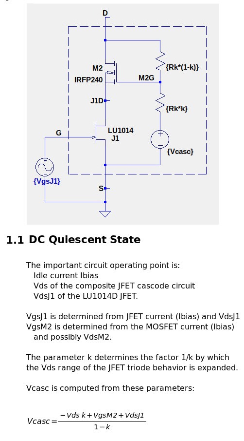

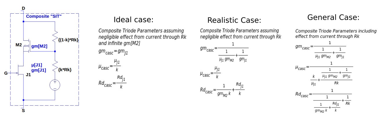

My intent with the LU1014D Modulated Cascode, which perhaps I failed to make clear, is to create a three terminal circuit that preserves the triode-like properties of the LU1014D over a more useful voltage range. This post gives some more detail about the circuit.
The first image defines the triode equations of the circuit. Sorry ZM.
The second image shows the quiescent state DC conditions and how Vcasc voltage is derived.

There is a surprising result in the gm[casc] equation in post #63 which is verified in simulations. I previously thought that the cascode FET needed have a very high transconductance, more than a single IRFP240 could provide.
In the equation gm[casc]=1/(1/(μ[J1]gm[M2])+1/gm[J1]), gm[M2] is multiplied by μ[J1]. At 1.5A the IRFP240 gm is about 5S and the LU has a μ[J1] of about 8.5, resulting in gm[M2]μ[J1]=42.5S. The LU has a gm[J1] of about 27S at 1.5A and Vds[J1]=5.1V.
The final result is gm[casc]=16.5S, which is excellent.

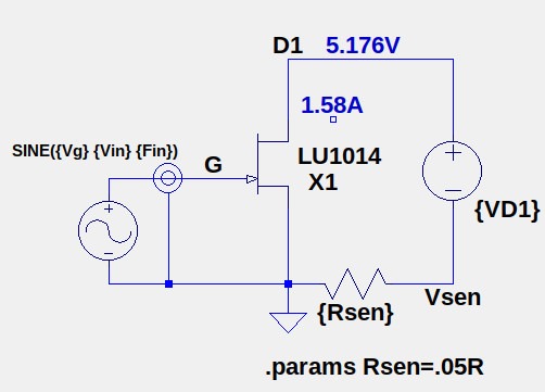

I am designing a measurement test jig for the lu1014. The simplest approach requires a rather small sense resistor making requiring the measurement of small AC voltages. Both increasing the value of the sense resistor or increasing the AC input to the gate cause the gm measurement to much lower than if the AC current were direct;y measured.

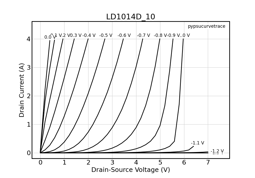

@lhquam That 5.1 Vds operating point in your measurement jig is not a good choice if you ask me. It may be fine for some parts, but for others it will be at the edge of the sane operating range. See attached example. I'd go with 3 or 4 Volts, which should be more universally applicable.
