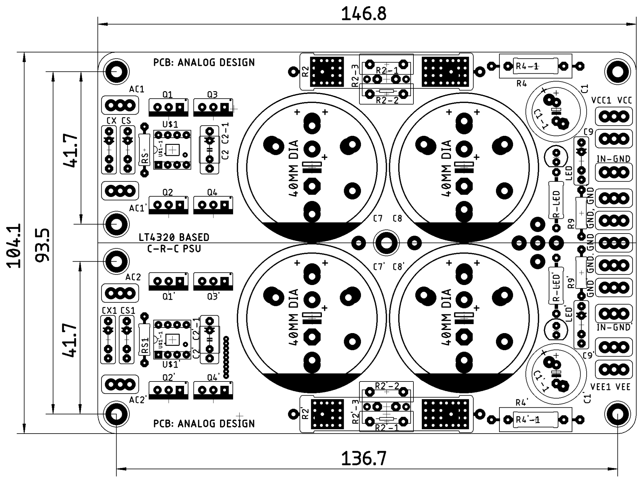

Hi Prasi:
I see you have posted the dimensions of the PCB. Can you please add the dimensions for the mounting holes (size and location)?
Thanks,
Steve
Hi Steve,
here are mounting dims both in pic and 1:1 scale pdf.
