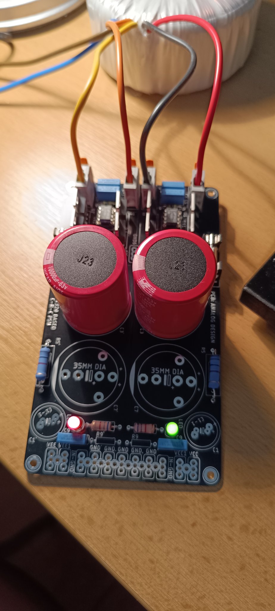

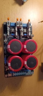

My active PSU in black for Q17, ...R5 (1k/3W) is very hot at about 50 to 60 degrees.

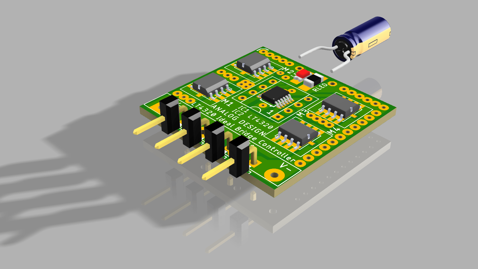

Prasi,
Understand that the current GB is for the CRC PSU with LT4320 active rectifier option.
Do you have any GB for the LT4320 active rectifier add-on PCB that can be used with your other PSU PCBs (that are designed for bridge rectifiers)? A pic is attached for your reference.
