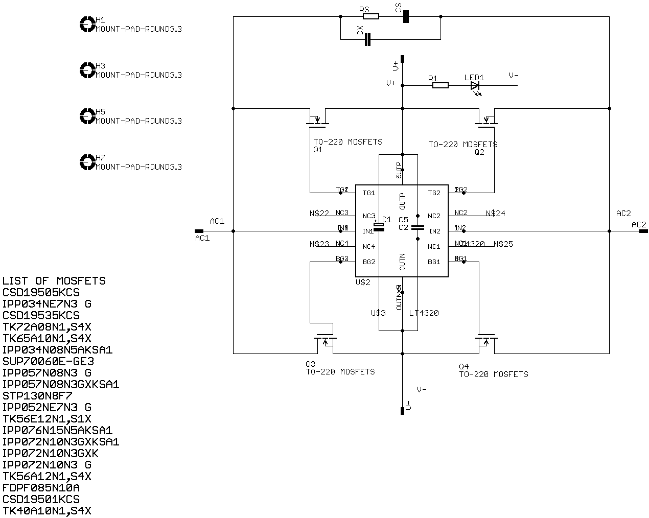

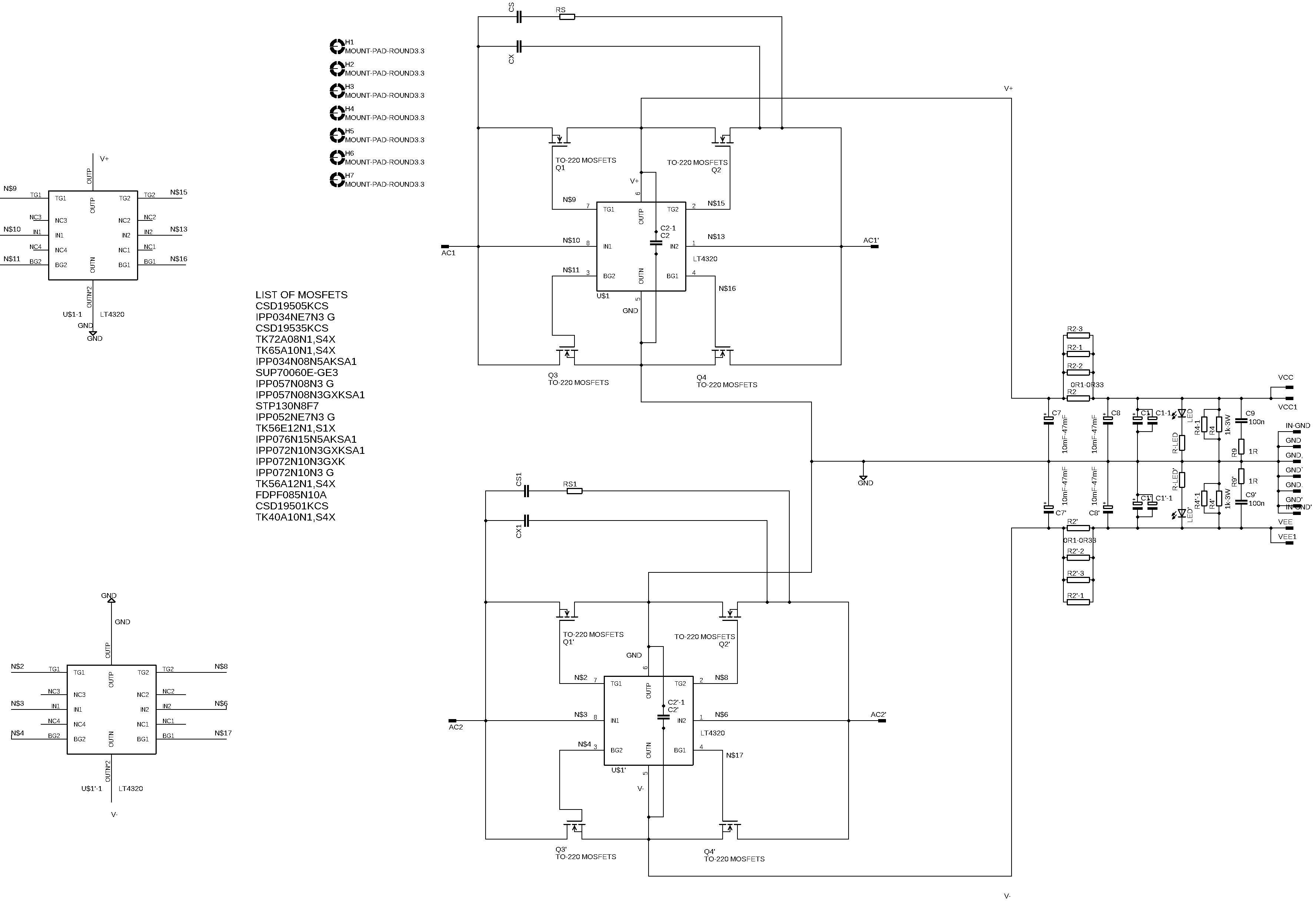

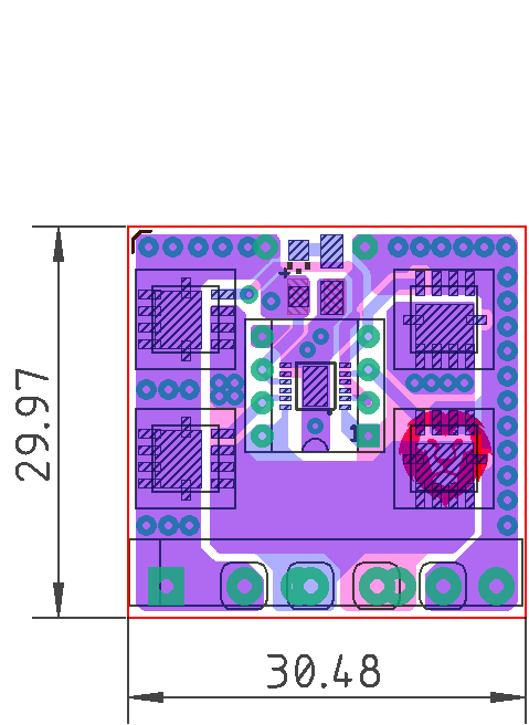

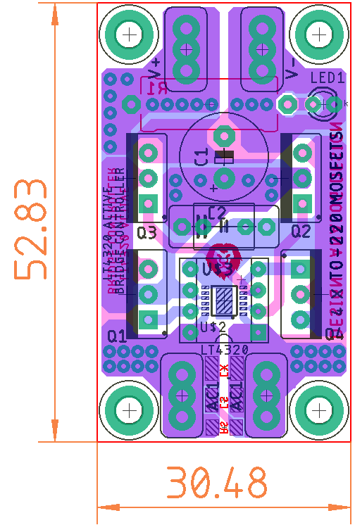

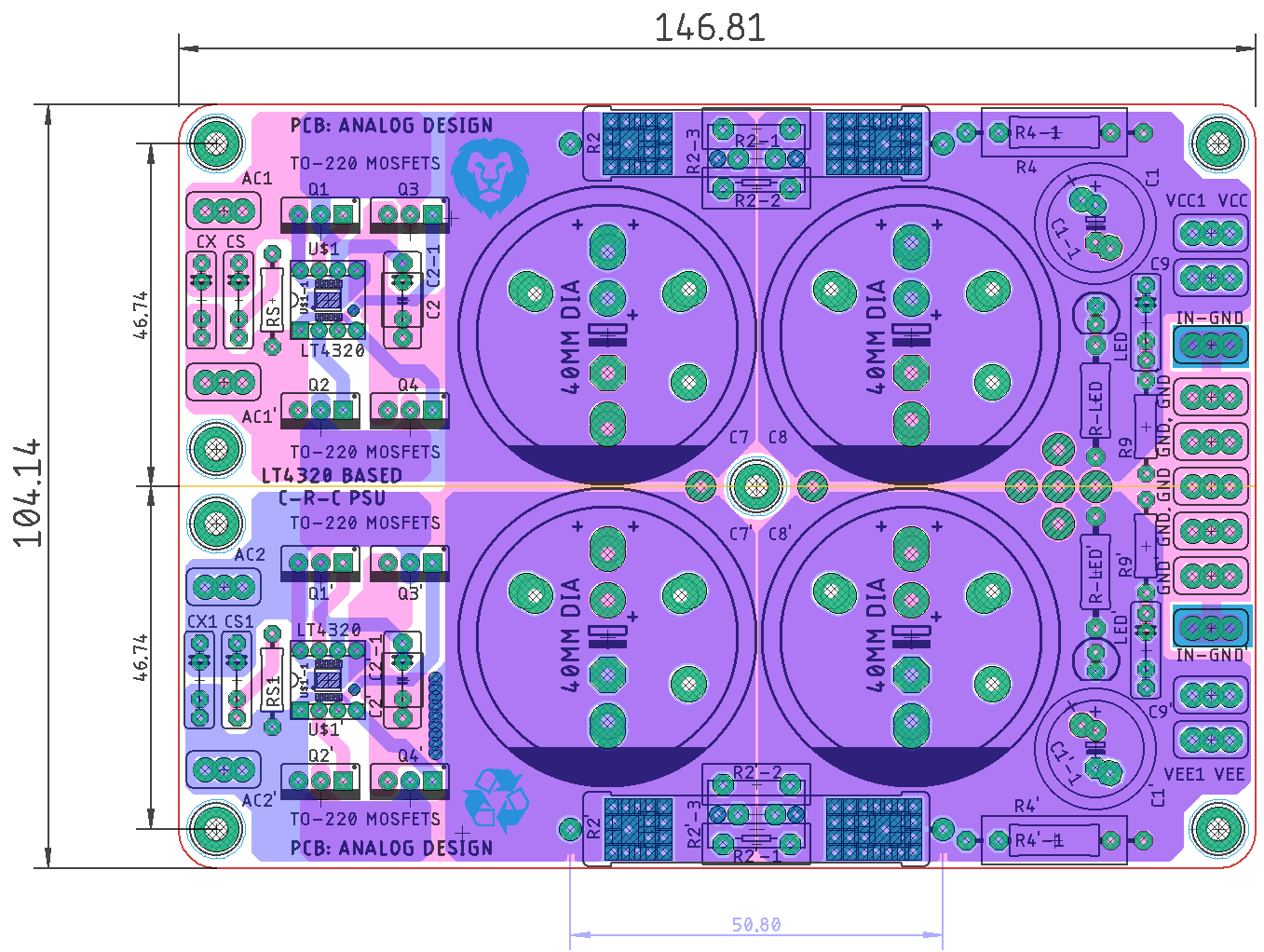

here are sch and stuffing guides
1. smd rectifier pcb (sold in pair- 2 usd per pair)
2. tht rectifier pcb (sold in pair- 3.5 usd per pair)
3. crc psu pcb (sold in singles- 6.5 usd per pcb)

Hi Prasi, Pehaps this is a stupid question, but I'll ask anyway:
What is the max RMS AC voltage that these rectifiers can take across the 2 input pins? Is this actually 50V AC (RMS) across the inputs?
What's the max DC voltage that they can output? Is it +72V and - 72V at the outputs, or a total value of 72V. Ie +/- 36V?
Could 2 be used in parallel to allow double the working voltages?
Many thanks
