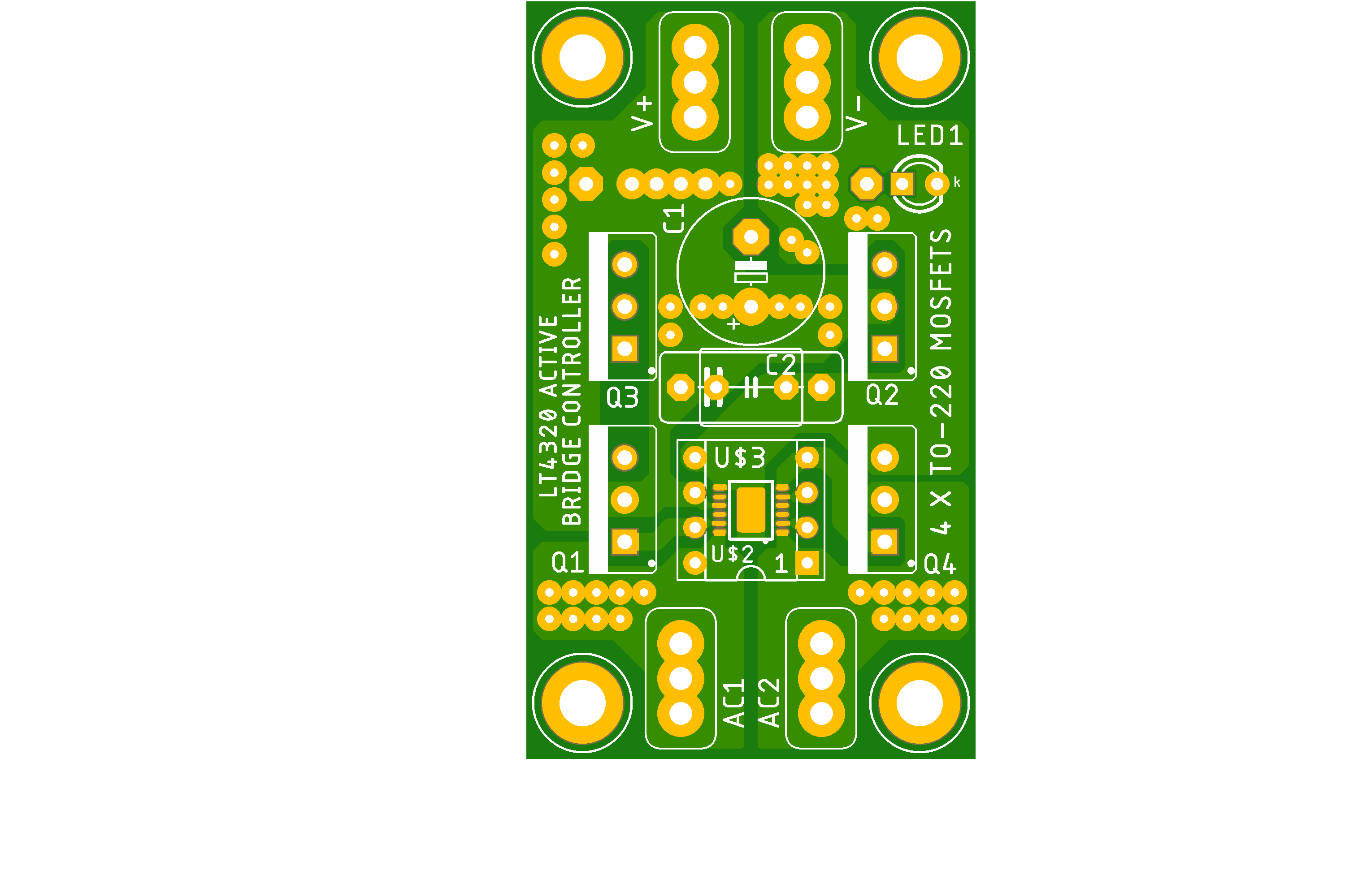

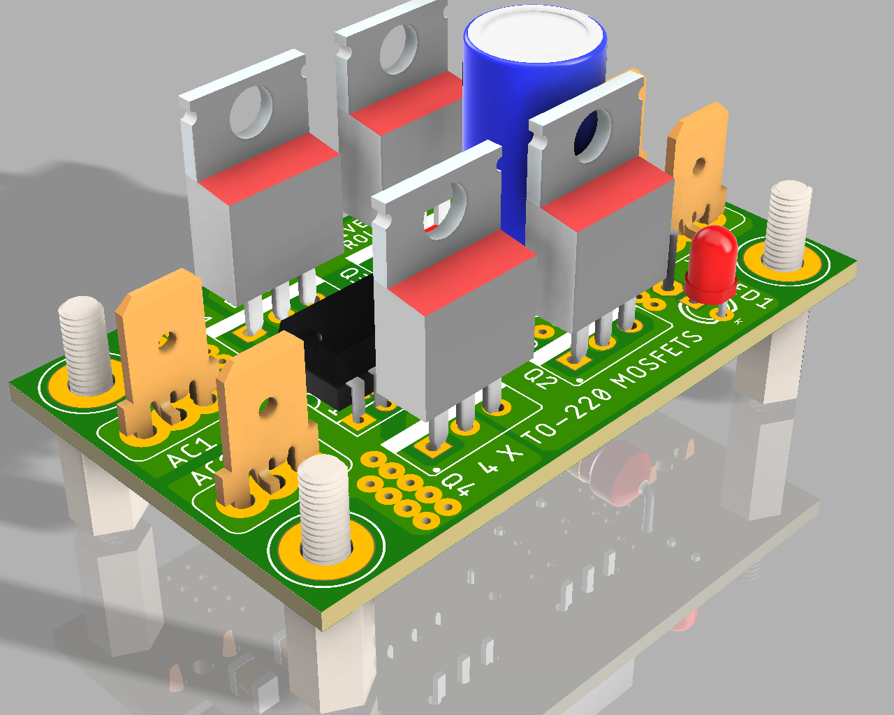

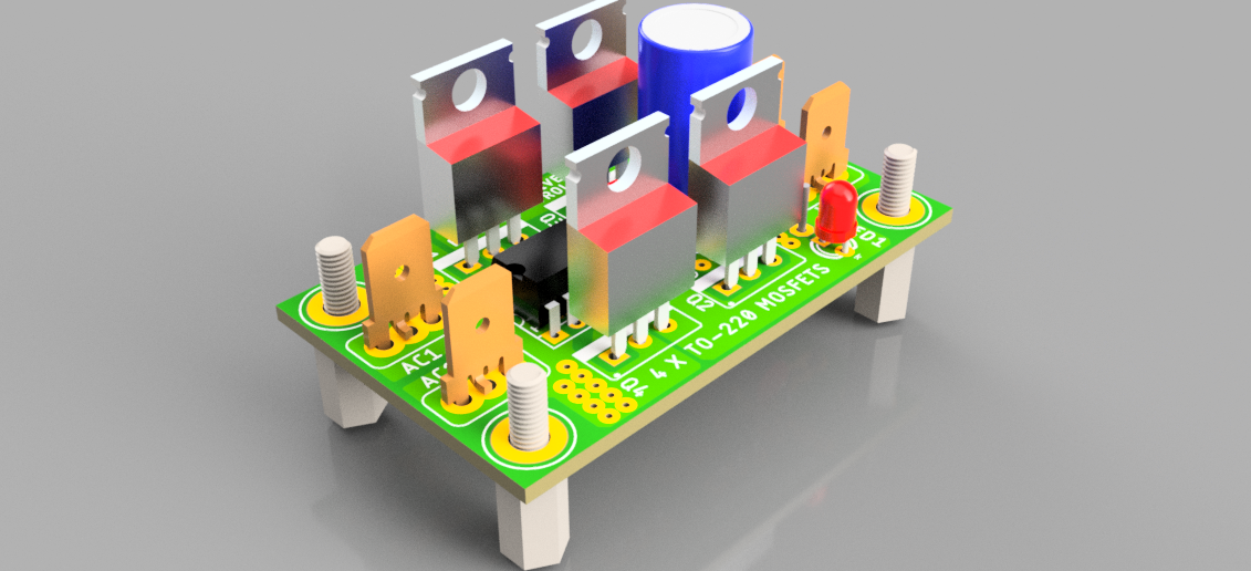

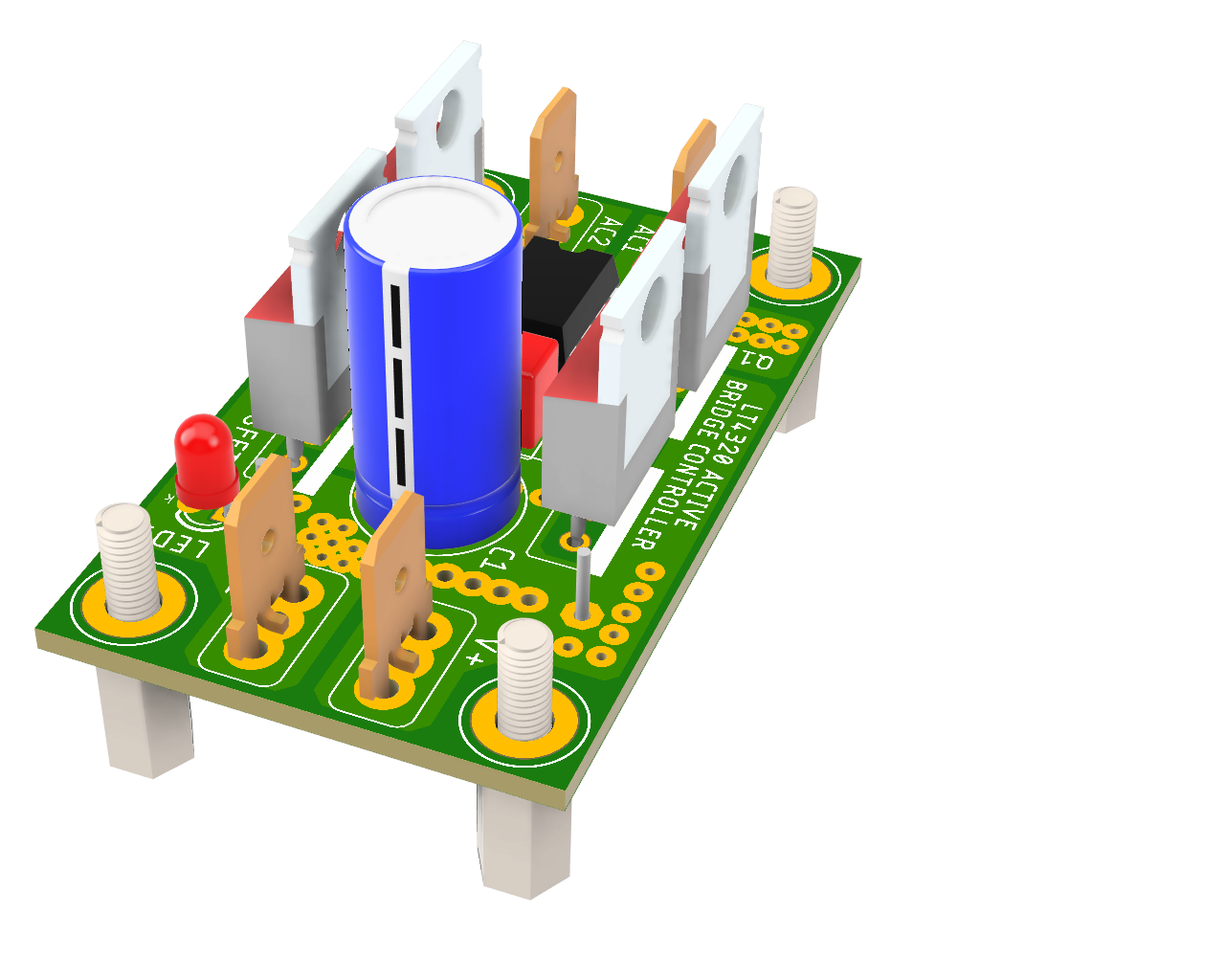

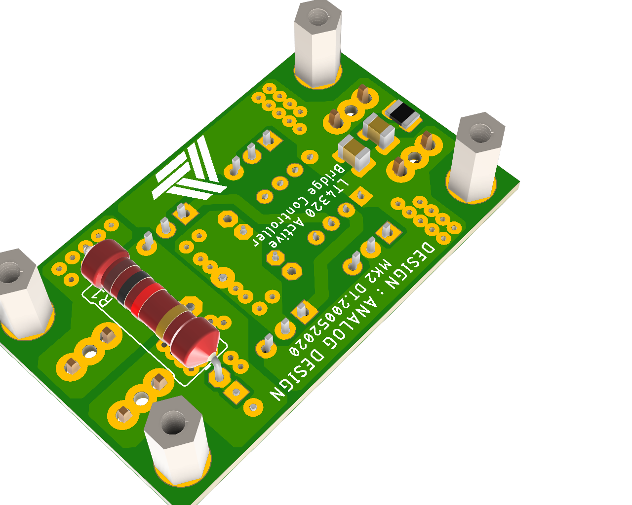

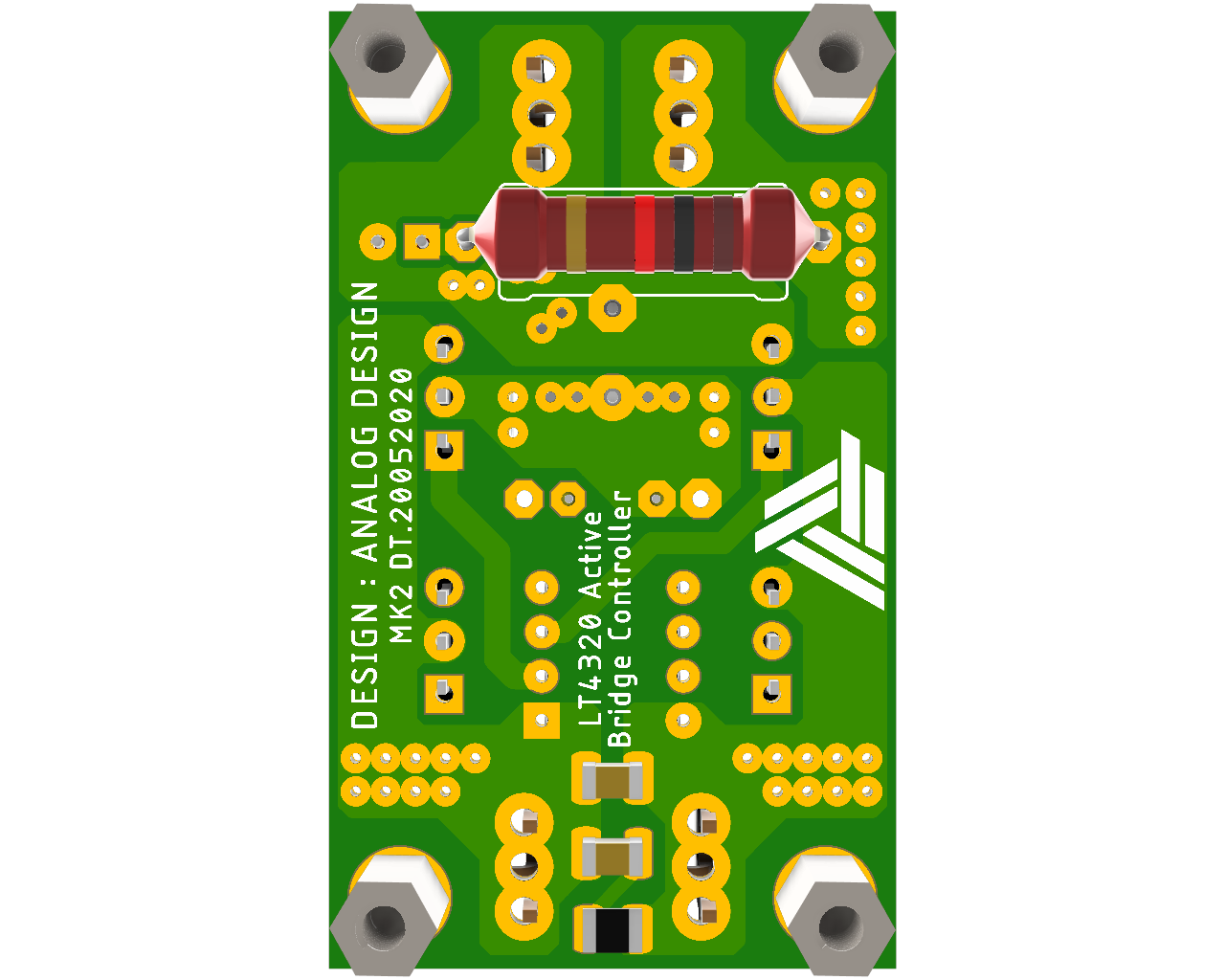

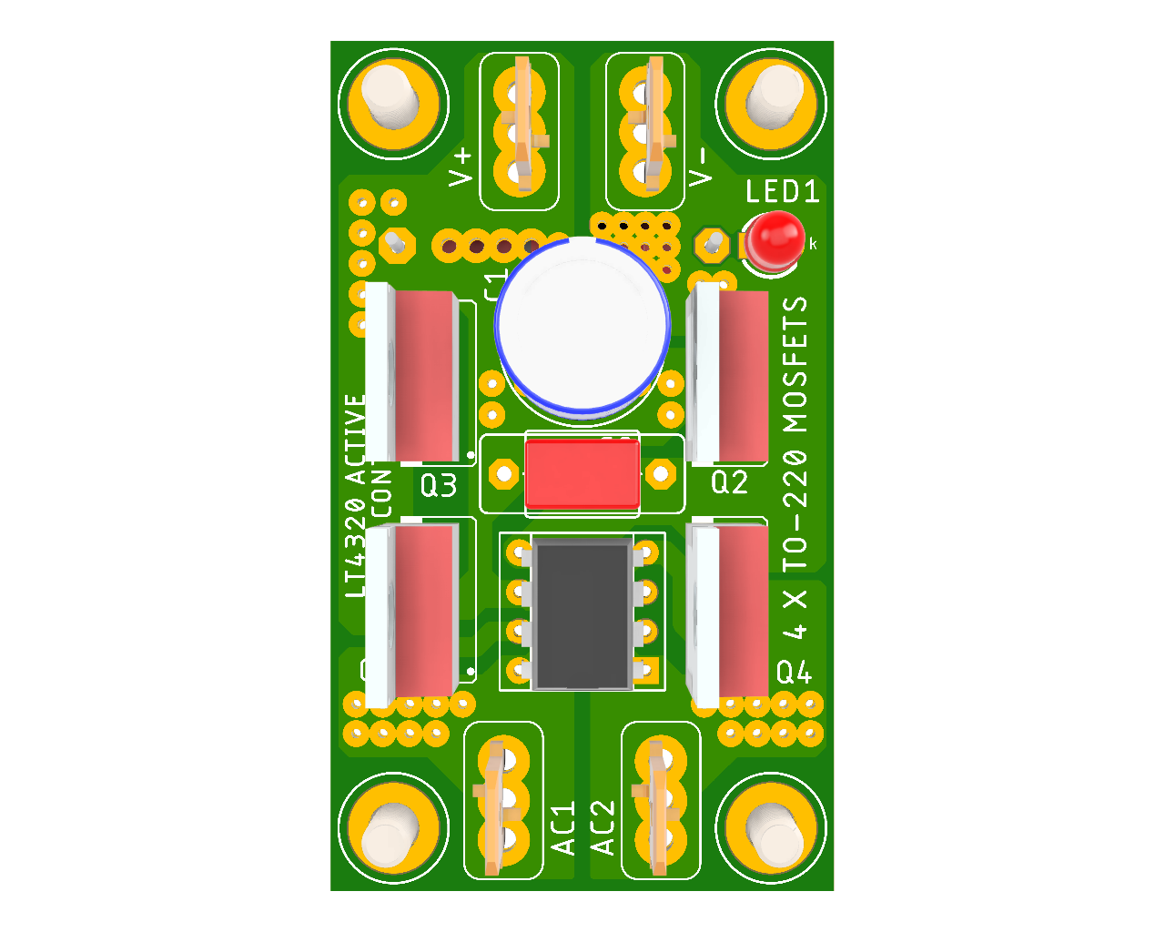

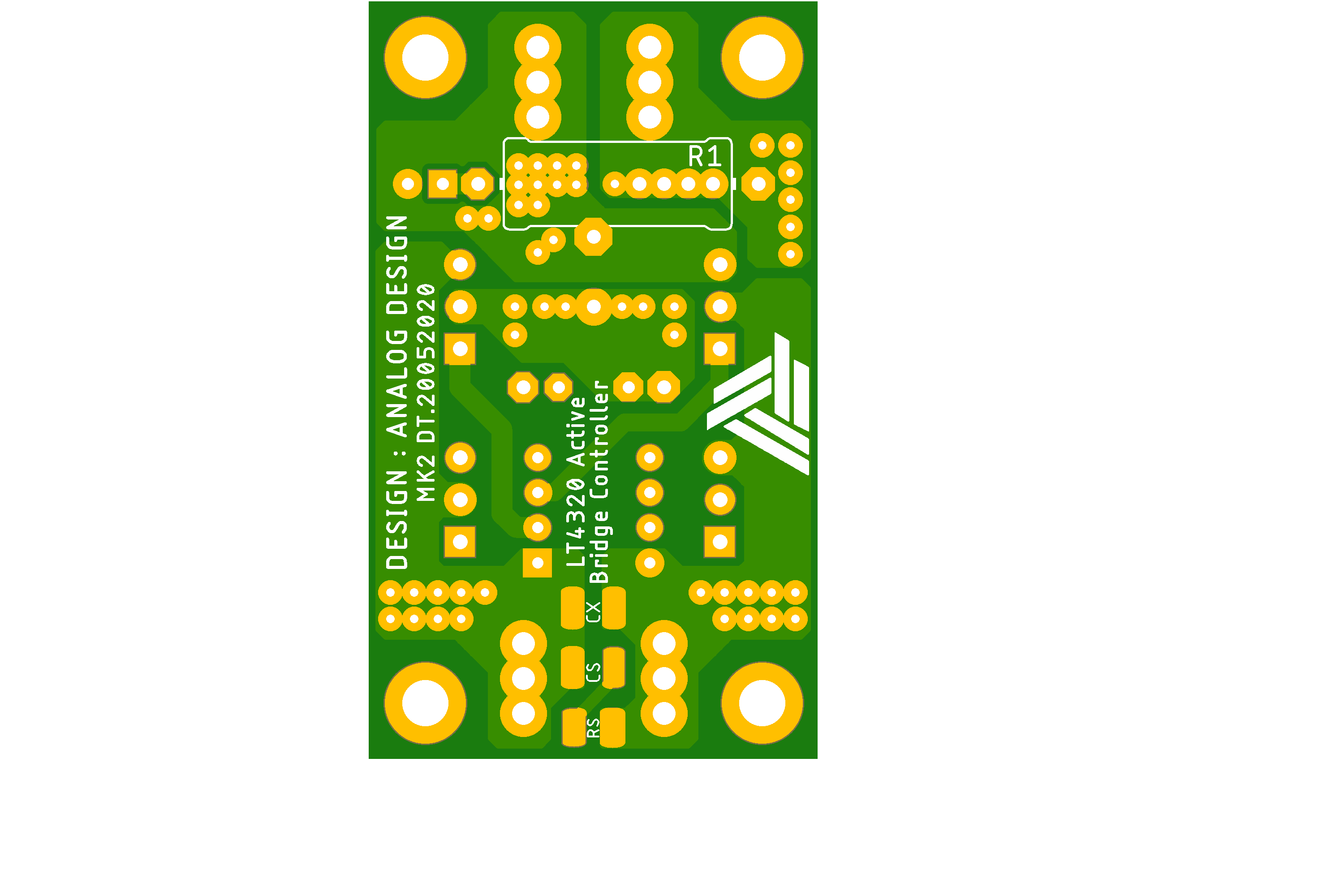

I am getting ready to assemble my boards. I know it is a pain to rearrange things, and this may have been mentioned before without me noticing.
In what I think is the latest revision to your THT boards, you've re-routed the traces for Q4, which does not correspond to the excellent renderings in post #765. Thus, Q4's alignment now "matches" Q2. I saw this immediately on the boards b/c they note the proper orientation on the silkscreen, and I checked with a DMM. However, this may trip up some builders.
If it is of limited trouble, could I suggest that post #1 be updated to point to a current rendering. Again, I know this might seem silly, but it may help out another builder.
:cheers:
Patrick
Hi Patrick,
Good point. It was my laziness and rendering takes long time (I had an old i3 laptop, slower than snail then) . So didnt do latest rendering.
I am attaching here correct renders for THT rectifier version.
regards
prasi

Hello all, Can someone please direct me to the post where it's explained why one of these rectifiers can't be used by itself to supply a power amp from a single transformer secondary?
In This Post I tried to explain what I found to be why it doesn't work with center tapped secondary in constructing a split rail PSU.....it is because the bottom MOSFETs stay conductive most all the time during the AC cycle instead of turning on/off in sync with the top MOSFETs. I attempted a circuit trying to make it to work but it seems too much complexity would have to be involved in order to get it work properly under all possible conditions.
