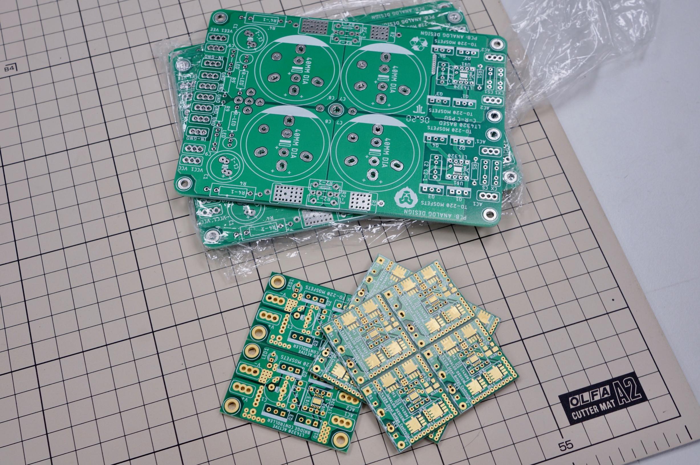

on the tht rectifier pcb its still there on bottom as smd foot print. ,
on the smd rectifier pcb, its removed.
In this post, I thought you were offering ICs, when I read your previous answer today I figured these were the PCBs. Anyway, do you also offer these chips as well? If not can you or anyone plz direct me where to find the cheapest prices yet reliable source for these ICs.
Kindly find below my order:
1. CRC PCB: x1 pcs
2. THT PCB: x1 pair
3. SMD PCB: x1 pair
pl pm me your paypal email, complete postal address.
regards
prasi

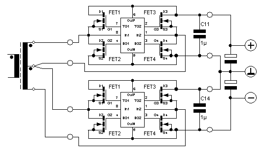

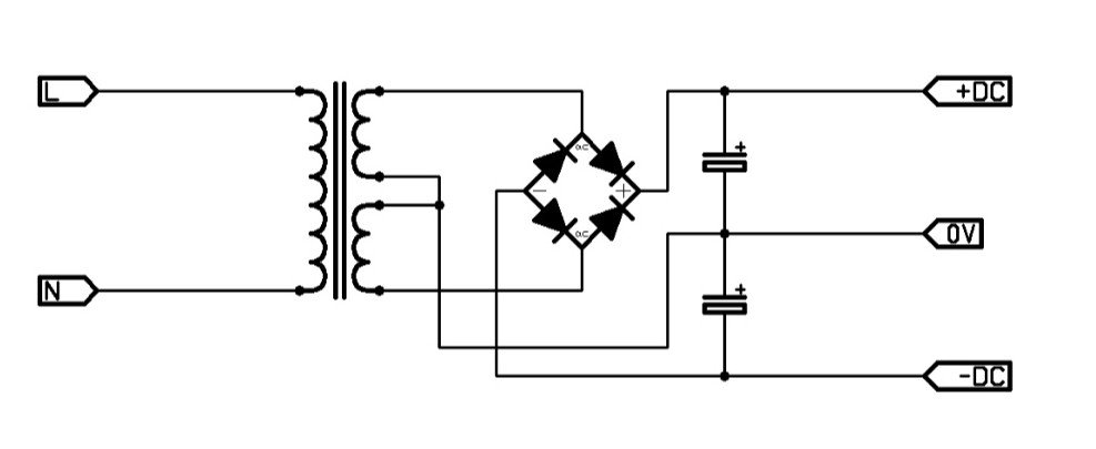

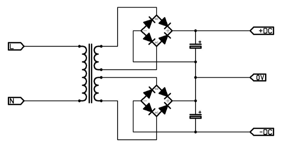

Will this CT rectifier work or burn??
I have read many many postings, lots of words, but did not find a final answer to my specific question: Will the following configuration work with the 4320 or will it fail?
Please note that the two winding sections are indicated to be wound in sequence (i.e. they are in phase), so my conclusion from previous discussions is that the configuration should work.
So I'm just simply requesting a yes/no answer, as the transformer is what I have (part of a purchased item) and if the answer is no, the diodes rectifier will just stay in place and two secondary winding snubbers will be implemented.
Thanks and Regards,
Winfried

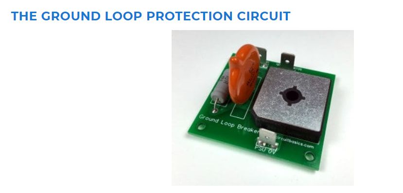

chassis discoonect network ... Power Supply for Power Amplifiers or some use a cl-60 between psu ground and chassis.
RB and RB- you can use 3300ohm also, its not critical. it determines how fast your caps are discharged when powered down.
For the chassis disconnect,
If using dual mono PSU boards, should each board get its own "ground disconnect network" each attached to a common star ground,
Or can one "ground disconnect network" be connected to both boards?
Thank you,
David.
Something like this.. there is no best single solution. depends on how you build it. are they single mono blocks? or everything in same case?
example understanding star grounding
read this excellent article by hifisonix
http://hifisonix.com/wordpress/wp-content/uploads/2019/02/Ground-Loops.pdf
Everything in one case.
Thanks for the links, will read up!
Thanks and Regards,
Winfried
No, this will not work with LT4320.
However, I have designed a synchronous bridge that is able to work in any configuration, including centre tapped tafo - look for Saligny HVHF.
Tibi

No.
Alternatively, see Variant C on the Saligny Standard datasheet.
https://evotronix.eu/main/wp-content/uploads/2021/01/SalignyS.pdf
Tibi
Tibi
Hi Tibi,No, this will not work with LT4320.
Tibi
and thanks for your clear answer. The HVHF solution may work, but at the stated cost it seems much more economic for the application to invest into a new 30VA transformer with separate secondary windings. Now, just by pure coincidence, I've just got hold of a separate secondaries transformer matching the application and this way working with the 4320 active rectifiers I already own.
Thanks again,
Winfried
