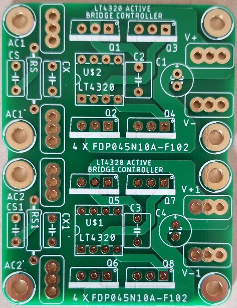

Don't use the snubbers on either the THT LT4320 Bridge Controller or the Compt-CRC board (CS, CX, RS)?
I have read the stuffing guide, studied the schematic and have been reading as much as I can about power supplies to try and not ask too dumb a newbie question.
What are the variables in the schematic that need to be adjusted for different sized/voltage transformers?
Lets assume a 300VA 35v dual secondary transformer.
To me it looks like,
- the obvious, the big main caps (C1..C4) have to be the correct voltage (i.e. 63v caps for 35v transformer)
- snubbers (CX, CS, RS) based quasimodo jig, or left out if using your LT4320 based active rectifier
- LED resistor (R10, R11), based on transformer voltage
I meant to say, when you use lt4320, you can do without the snubbers. i have given the option of use of snubbers based on some member's request
with normal rectifiers + if you have quasimodo jig, then you can determine the value of snubbers and use them.

Since I was asking about CS, CX and RS on both boards,
I understand that CS, CX and RS should/can be used on the Compt-CRC board if used by itself with a standard rectifier, using the values from the Quasimodo jig (I have one).
I also understand that if using the LT4320 board, not to use CS, CX and RS on the Compt-CRC PSU board.
I was wondering about if CS, CX and RS should be used on the LT4320 board itself?
I may have answered my own question (don't use them) as I don't see CS, CX and RS on a later version of the board (just noticed that).
Thank you for your patience!
David.
1. In later version (latest) of tht lt4320 pcb, the option is still present with smd snubbers on bottom.
2. in smd lt4320(latest) pcb, i have removed it because if someone wants to experiment, he will use them on his main caps psu pcb(e.g. compact crc that you had originally asked about). because this smd rectifier pcb will be used as a plugin rectifier with some other bulk cap pcb like the compact crc psu pcb with pb35xx rectifier footprint
3. in the tht lt4320 crc psu pcb that is offered via gb, snubber option is present....
so in summary for you, dont use the snubbers initially... if you feel up to it, you may experiment to any extent with the options provided....
