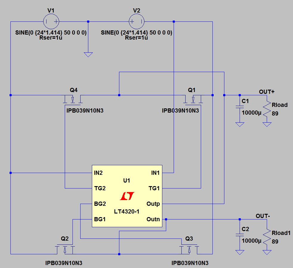

Following the instructions, the positive supply shows some 50mV TT ripple. However, the negative supply holds about 4V TT ripple. This was also the case when two separate active rectifiers were used for positive and negative supply (with the positive connected to the negative to set a common ground). As a test, both active rectifiers were wired as only positive supplies, and then a low ripple can be seen again.
Yes, the secundaries are in phase as per instruction.
What do i miss?

I included the reference to the post 678 to illustrate that exactly that setup is used. If the detailed photo in that post is not enough, of course I can draw the schematic.
Summary: the setup comprises a transformer with two separate secundaries wired in phase. One end of the wires are connected into a ground. The other ends serve as the AC-input for one single active LT4320 rectifier.
After the rectifier which yields about +/- 20V I have added a simple LM7815-LM7915 in order to get current flowing through the active rectifier. Otherwise it won't start, as mentioned in post 678. After the LM7815-LM7915 the positive voltage is fine, but the negative voltage contains a small hum (probably because of the high negative ripple of 4V).
Before, I have build many dozens of linear regulators. The only difference here is the two secundaries are wired in phase, instead of the classical 'out of phase' for a positive / negative supply.
I wonder what can be tried to further test the setup?
Ok. So, it is as expected.
In this particular connection the 4320 works as a half wave rectifier, as i have mentioned many times in these threads. The ripple is obviously much higher.
Using an amp as a load is not a good idea if you want to take measurements. Rather use resistors or active loads, so it is certain that the current draw through both outputs is equal. Under these conditions the ripple on + and - will also be equal.
Here is a circuit illustrating a symmetrical PS with half wave rectification.

Only having half wave for a dual supply with one active rectifier, I get it now.
The link of Prasi has some use, resulting in a question:
A dual supply can be made by two separate full wave rectifiers with each its own winding. They can can be wired on top of each other by connecting the positive of the lower one to the ground of the top one. This is my favorite setup for a dual supply.
This dual scheme may also be applied on the active rectifier. One active rectifier with its own separate AC winding will yield full wave rectification resulting in a positive voltage. For a dual supply two of such active rectifiers can then be connected on top of each other by connecting the positive of the lower one to the negative of the top one. This will result in a dual supply with full wave rectification. Question: Correct?
@Analog_sa: I will redo the test of post 853 by only adding capacitance and a suitable resistive load. Measurements on ac and dc will follow.
