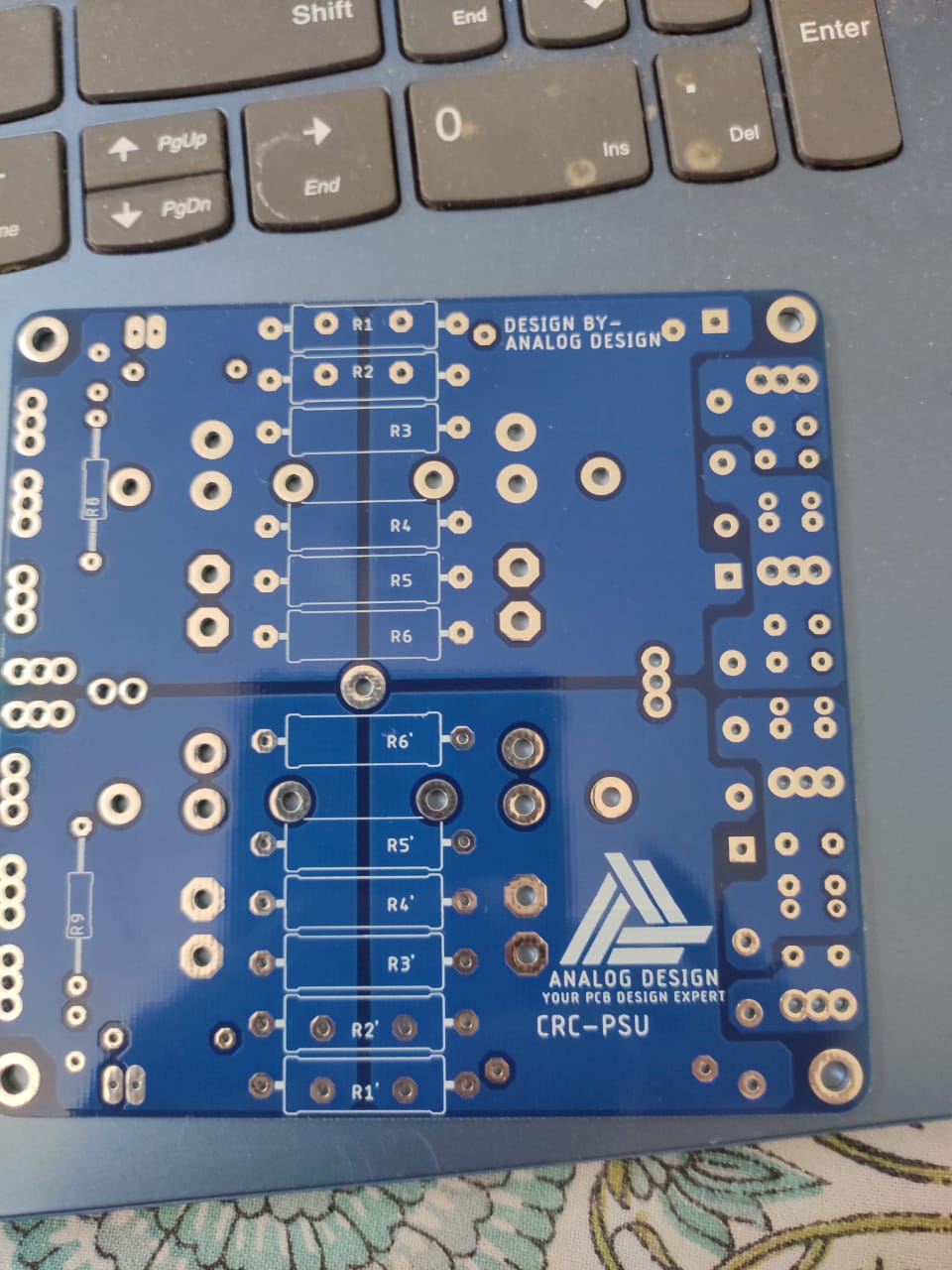

I have created an order link on the pcbway. if anyone wants to manufacture pcbs for themselves, they could use the below link and I will get 10% commission on the pcb manufacture cost (0.5USD for 5USD pcb cost), (barely) enough for a cup of tea on a roadside cafe...(pcbway donates the commission to the author without any extra cost while placing the order, so thank you pcbway...)
COMPACT CRC PSU-FOR ITHER DUAL SECONDARY OR CENTER TAPPED TRANSFORMERS - Share Project - PCBWay
I had placed an order on pcbway and got it today. as usual very nice pcbs from pcbway. i see that total 3 orders are placed using the order link, please dont forget to confirm delivery and leave a feedback. it will ensure i get the commission $$😀

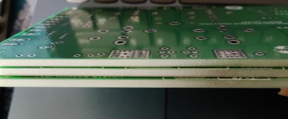

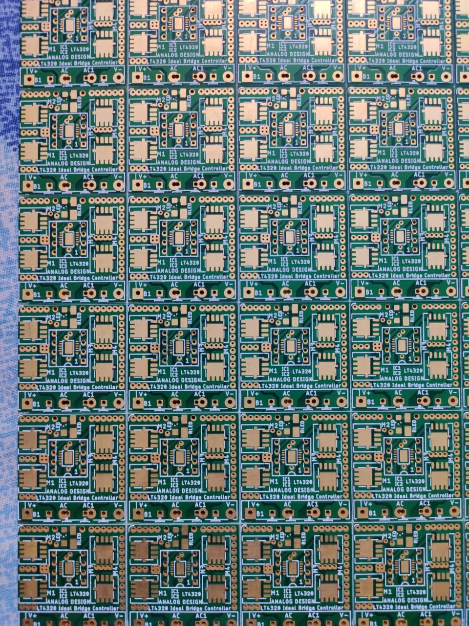

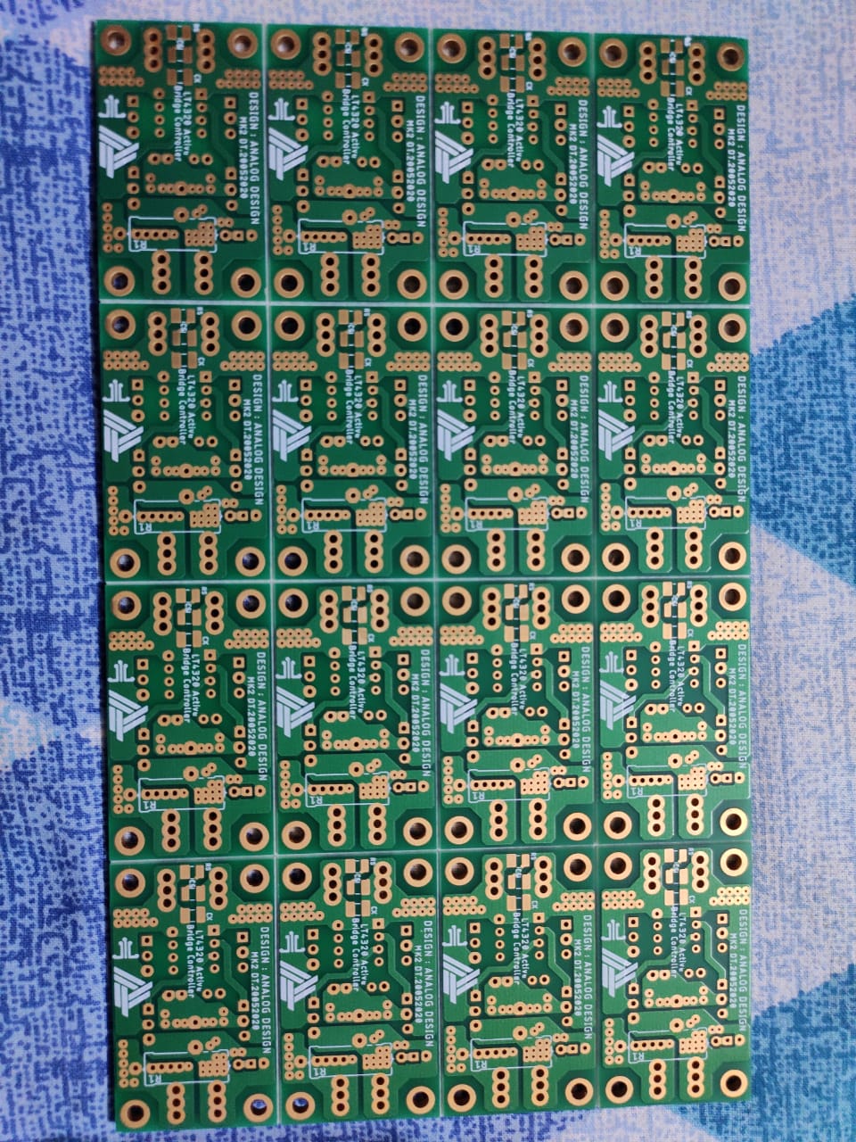

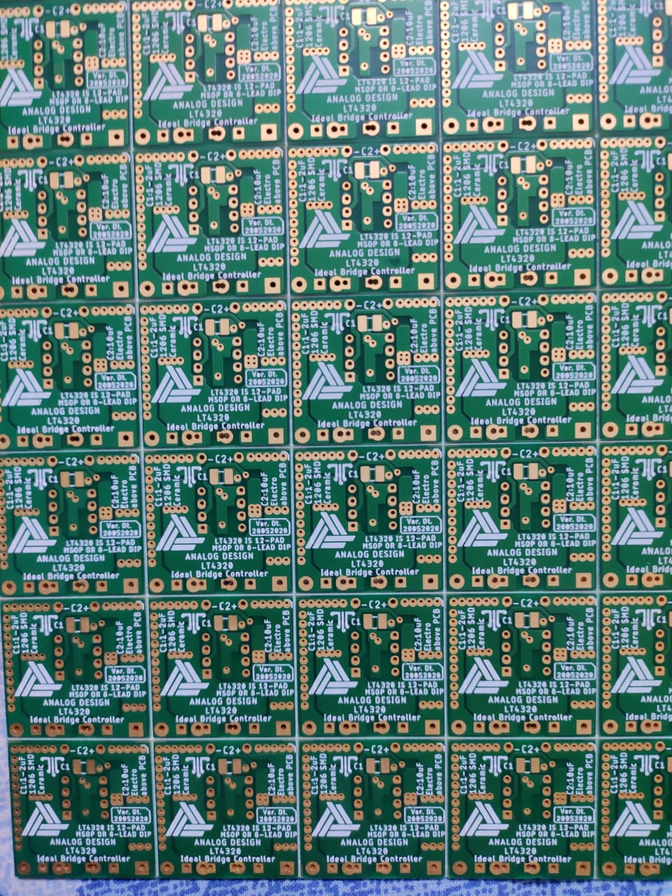

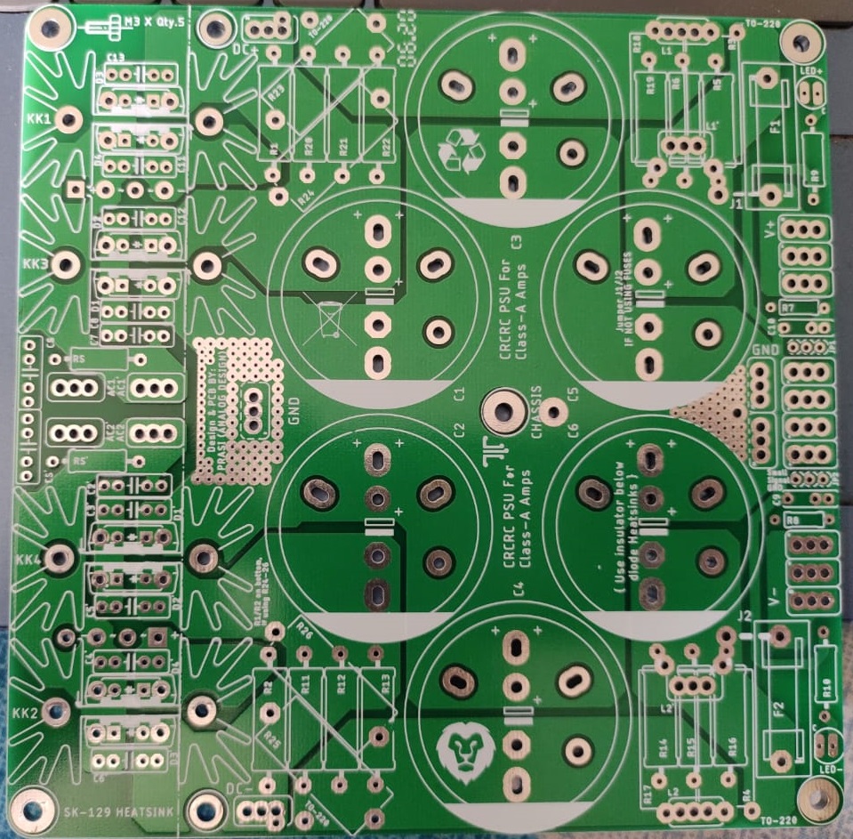

LT4320+CRC PSU PCBs and CRCRC PSU PCBs received.
Still waiting for rectifier pcbs.

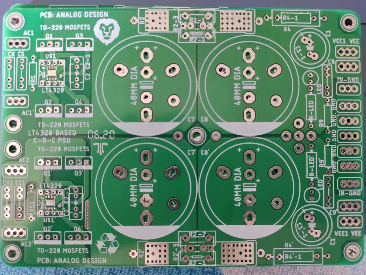

Hello i need some help,
i have the LT4320+CRC PSU PCBs and i want to use them to power a mosfet class ab amp.
my ideia is use one LT4320+CRC PSU PCB for each channel.
is the merlin el mago boom ok? the amps have 120 watts per channel. the trafos are +-40v 250 va. right now i have a normal ps pcb with diode bridge and two 22000 caps and get around +-55 vdc.
thks for help.

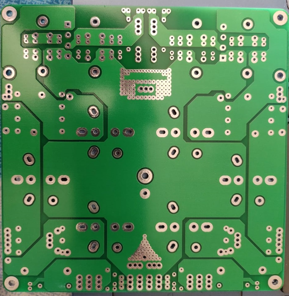

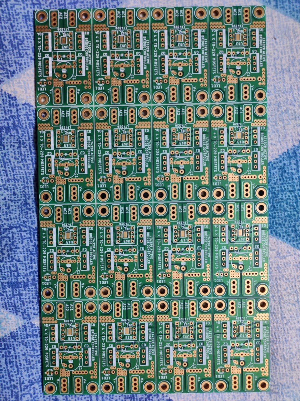

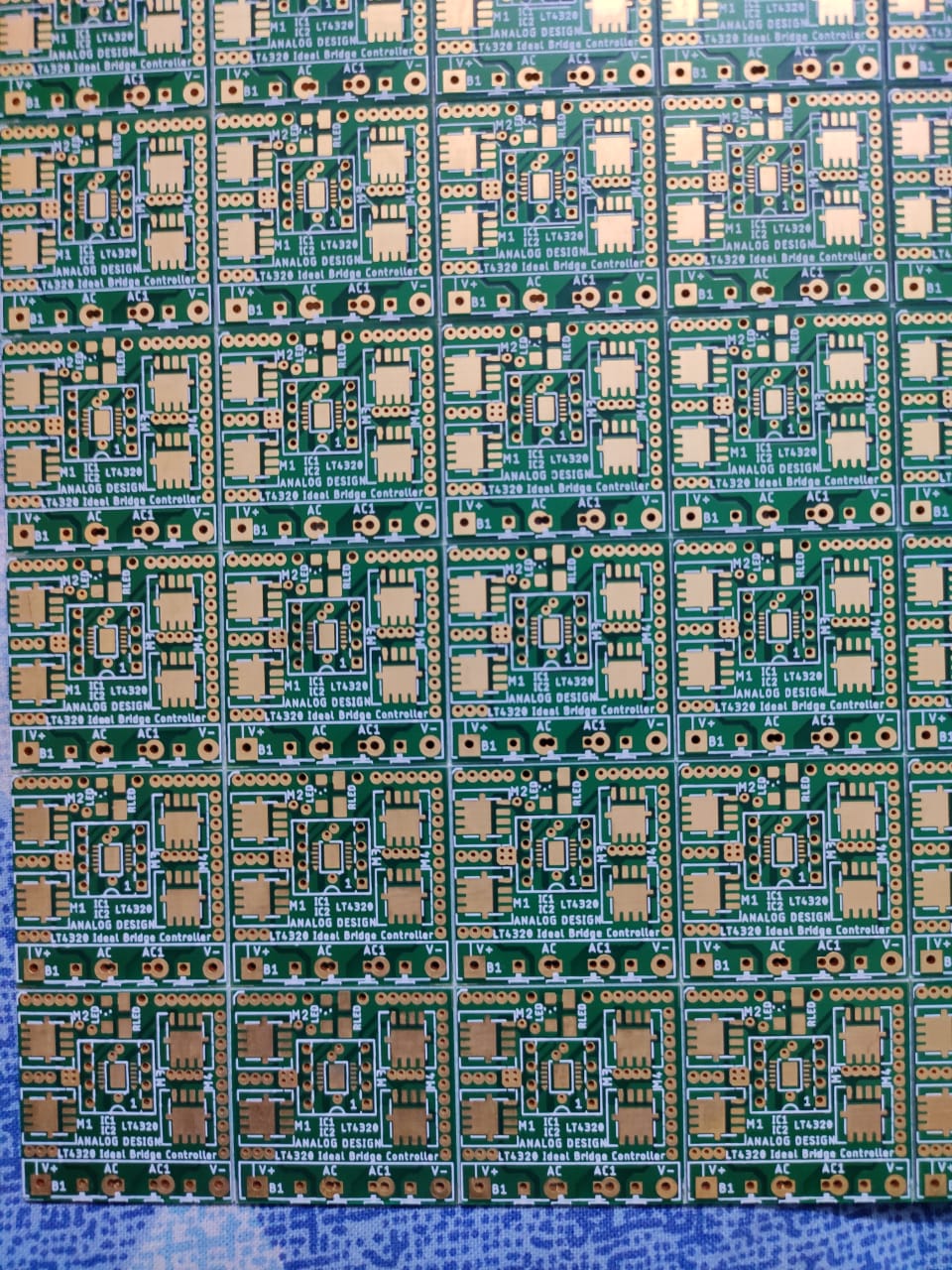

PCBS for the lt4320 tht and smd received. late by more than week.
but still international shipping no news. i have started shipping pcbs to local members.
