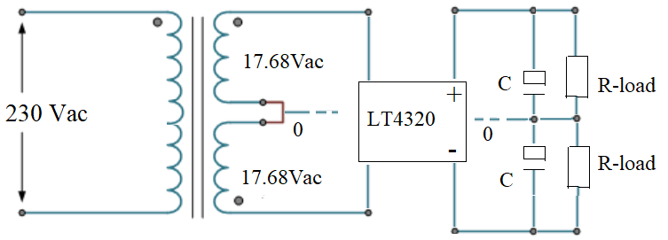

The measurement will be done twice, each on a different newly soldered active rectifier. The active rectifier is wired for dual supply as summerized in post 855. Measured by two different voltmeters, and a scope with AC in: 2 x 17.68V. After the capacitance and resistor is added the result will be reported.
I'm a bit lost with that post 855 on how you've set up the active bridge with this is phase, out of phase connections.
As I understand, you've used each single winding of the transformer to feed each LT bridge, yes, and you're getting wildly different results, yes but what current are you passing thru what load after smoothing with what capacitor/resistor?
And, have you joined the 2 supplies, after the bridges to get your + & - rails?
As there appears to be no schematic of my setup in this thread, herewith you will find my sketch (sorry, don't have the proper software at hand now). The capacitance will be 2 x 10.000uF per side, the second capacitor is selectable to see the effect. The first test load will be set for about 100mA.

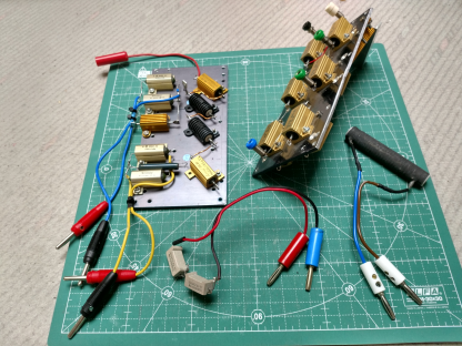

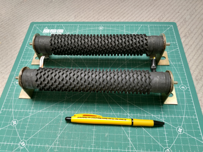

Herewith some pictures to illustrate some of the loads I use for various purposes. Yes, including 2 x 8 ohm in rather high wattage (see on the photo the ball point for comparison of the size).

Also a picture of the rectifier unit with 2 x 10.000uF to be used for the test. Prasi may recognize the board. Of course, for the test of the LT4320 the rectifiers on the board will be bypassed.
Foto Power supply rectifier unit - Small.png Foto R-Load 2 x 8 ohm Small.png Foto R-Load Various resistors Small.png
I've been following this thread for a while, since I am on the list for some of prasi's boards. I am baffled by the whole discussion around in-phase trafo windings, half-wave rectifiers, etc.
If your goal is to produce dual voltage outputs with low ripple, why not just use the dual windings as intended and separate full-wave rectifiers - more parts of course, but this is well established best practice.
Using a single bridge with a center tapped trafo (which is by nature out of phase) is less efficient. And I am fairly certain that using ideal rectifiers in half wave configurations defeats the idea behind them.
Am I missing some obscure design goal here?
3. From an audible perspective - as raised already by analog_sa in post 861 - it may be interesting to opt for a half wave rectification. I intend to compare half wave and full wave rectification with the LT4320 design. Over-thinking, and over-listening; oh well.
A prerequisite is to have no hum in either setup, which appears to require quite some capacitance for the half wave setup. That is how I got into my quest here.
At the moment the test is at 20.000uF on 2 x 75 ohm load (almost 300mA). A 50Hz ripple of 220mV TT on both positive an negative. With a resistor of 0.47 ohm between the two 10.000uF capacitors the ripple is with 150mV again somewhat lower. When then connecting a standard regulator - an extra 2.200uF and LM7815 / LM7915 - this results in no hum on the scope, just about a mV 'generic' noise. Finally. The negative supply still remains somewhat restless, though. Full report to come.
