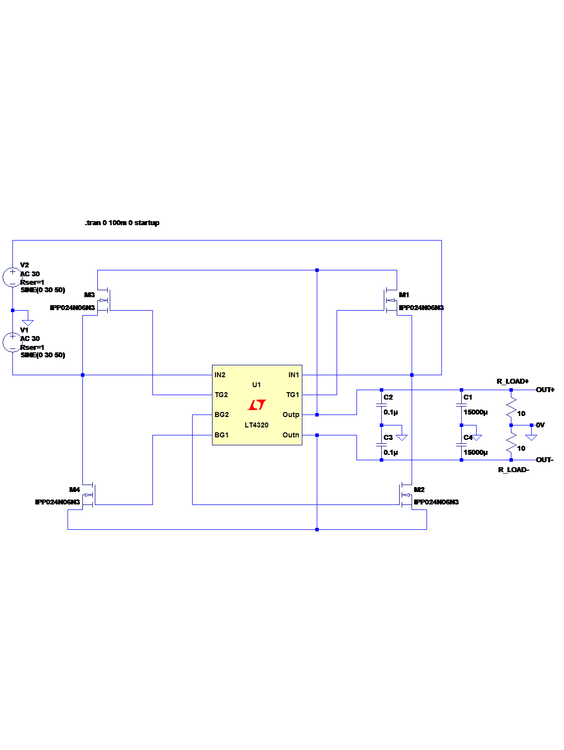

Just to close the loop on the CT-Discussion...I found this comment from Analog:
"but you could use the LT4320 with both windings out of phase. In this configuration, the center tap would be ground to your load while the LT4320 would have a separate local ground that would the be the "lowest" potential. These nodes are completely separated, with perhaps 10uF of biasing capacitance between them.
IN1 would connect to pin 3 on your transformer, and IN2 would connect to pin 6. The circuit would then use only two MOSFETs to rectify the positive output, these MOSFETs would connect from transformer pins 3 and 6 to OUTP. Then two diodes are connected from OUTN to each input pin to assure OUTN stays low. These diodes will not conduct the load current. The bottom gate pins are unused in this configuration. Finally, the load is connected between OUTP and the center tap."
...not sure how exactly the schematic would look like to be honest...what tyoe of diodes ? just some 1n4007 ?
LT4320 with center tapped Transformer - Q&A - Power By Linear - EngineerZone
Hello, Blitz,
I planned center-tapped single LT4320 configuration, but I encountered asymmetric problem.
LT4320 may not be work fine with dual rail configuration.
You should use two LT4320 with individual (separated) transformer wiring.
Edit:
Re-upload schematics.
Add last line.

Hi Prasi
Thank you for these great concepts.
I have added myself in the google docs, how will I proceed from there?
And, for a complete PSU, I'd need (in Boards) 1 LT4320 CRC and 1 pair of either SMD LT4320 or THT LT4320
thanks
david

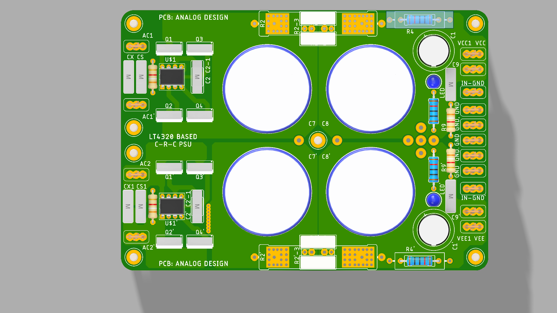

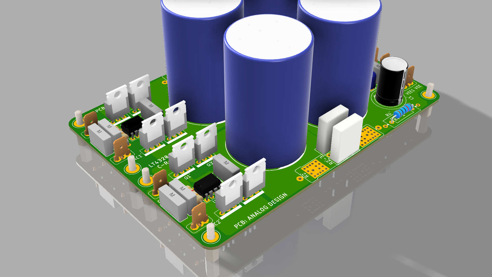

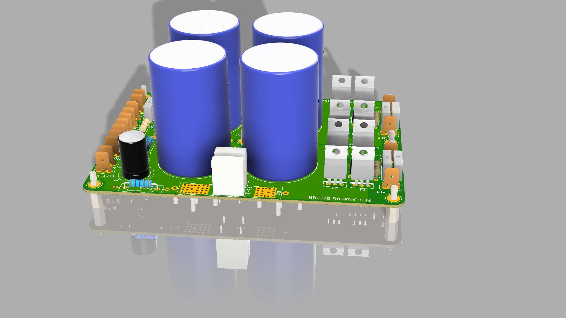

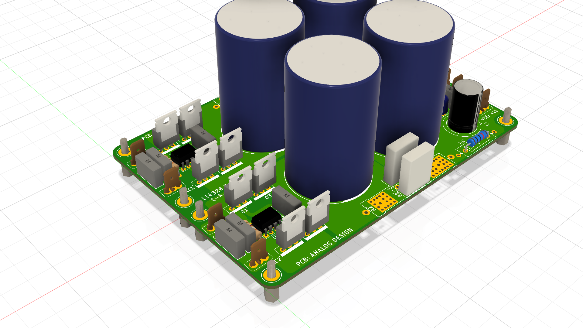

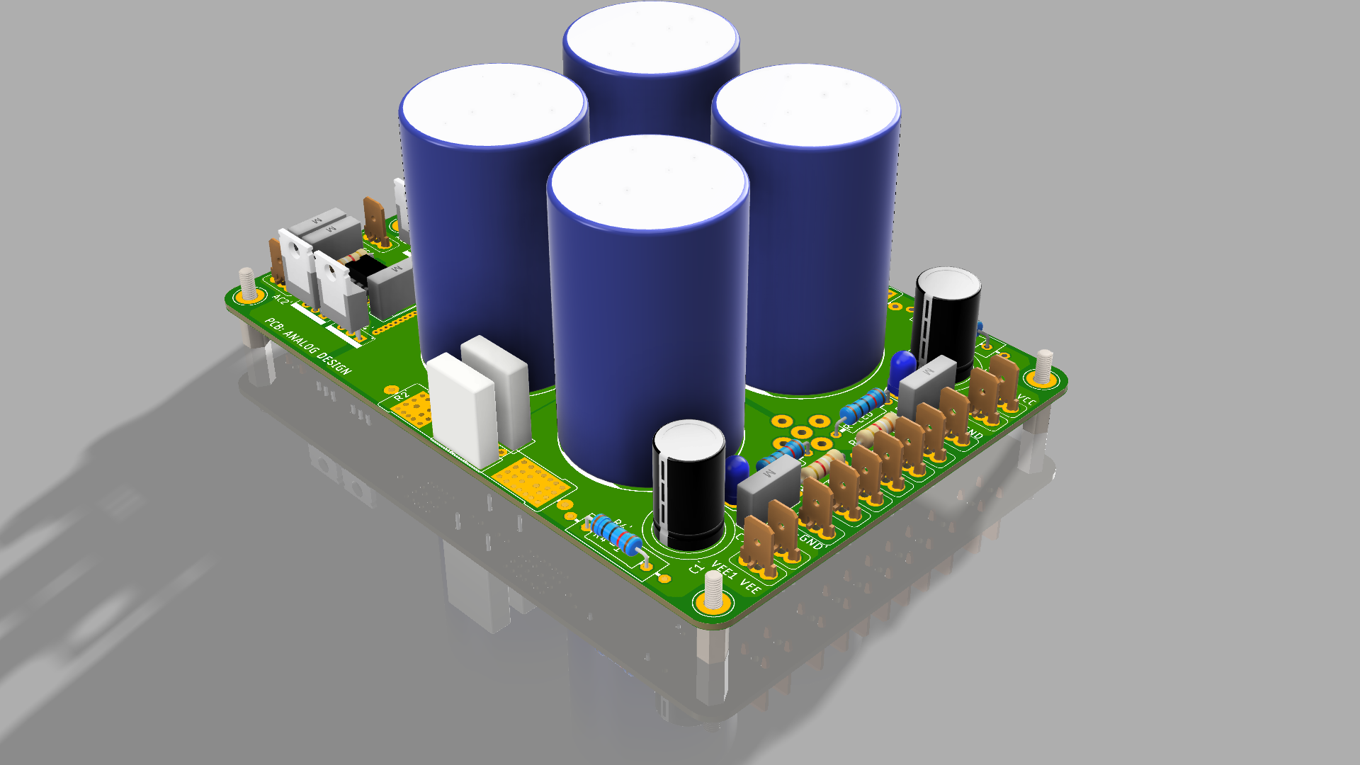

Hello David,
think of SMD LT4320 AND THT LT4320 as simple rectifiers. This can be used to replace your regular rectifiers in existing PSU. e.g. THT LT4320 can be used to replace https://www.vishay.com/docs/88612/gbpc12.pdf and SMD LT4320 can be used to replace https://www.mouser.in/datasheet/2/427/pb3506-1767492.pdf
The LT4320 CRC PCB is a complete CRC PSU PCB with front end rectification by LT4320 chip.
please refer the schematic on page 1 and 3D models views attached here.
SMD LT4320 RECTIFIER 3D LT4320 based active rectifier
THT LT4320 RECTIFIER 3D LT4320 based active rectifier

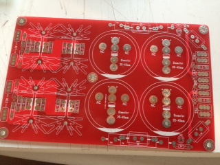

Hi Prasi,
I have a bunch of these CRC boards. Will they work with the LT4320 THT & smd boards from the GB's. If so, have you an image or guide as to how they would be connected.
MMView attachment 849897
Yes, they will work.. please refer this image by Shaan. you need to scratch off the solder mask at marked places. You simply bypass the rectification section on your red boards , And instead use the lt4320 rectification. But remember, you need a dual secondary transformer and a pair of lt4320 rectifiers to get +/0/- supply.
