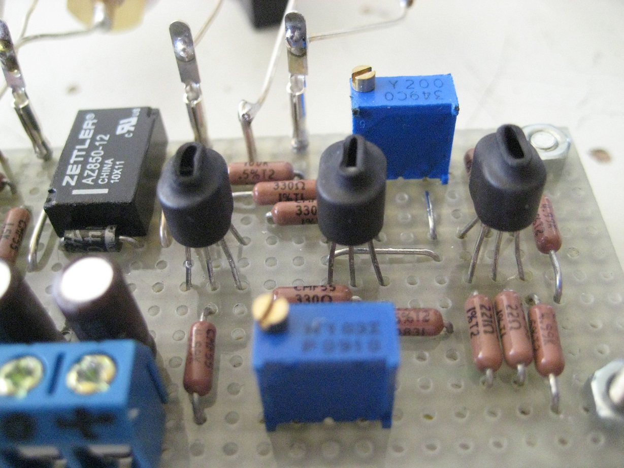

Last night I thermally coupled both CCS JFETs, wow, that solves it! Still learning....
Now offset wanders just a few mV. No big changes in offset when I blow a little air over it.
Only issue is that when room temperature varies, because of sun shining in my room offset wanders slowly +20 a 30 mV. When I re adjust with the potmeter it is good.

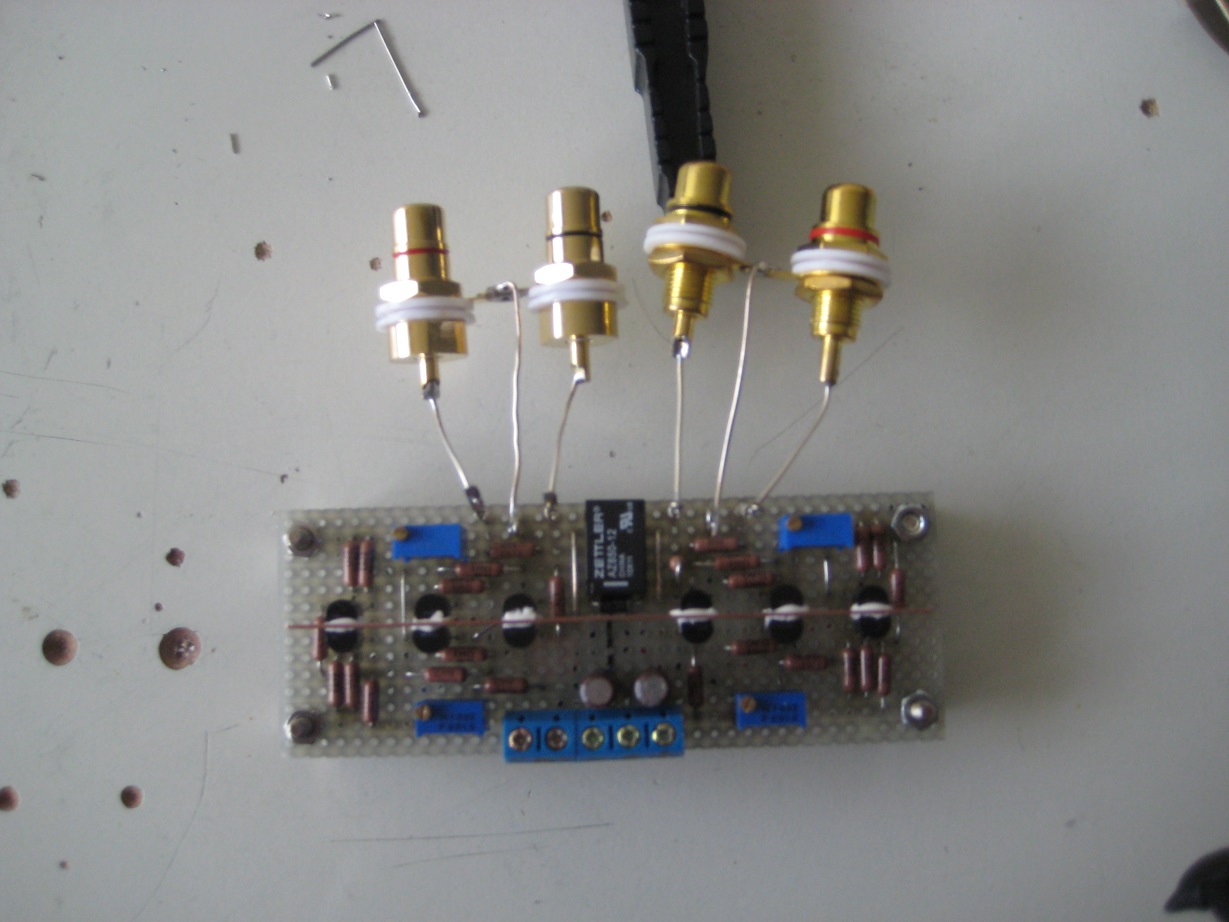

This little amp sounds lovely, almost as transparent as the DCB1 and gives me just about 13 dB extra gain which is sometimes needed for high resolution audio recordings.
With the relais I can switch the BAF2013 in en out the signalpath when needed.
Offset is still a small problem, the last picture is giving me the best results. Varies between 0 - 20 mV.
If the BAF2013 is in the final enclosure I will decide if I put an output capacitor after it, or not.

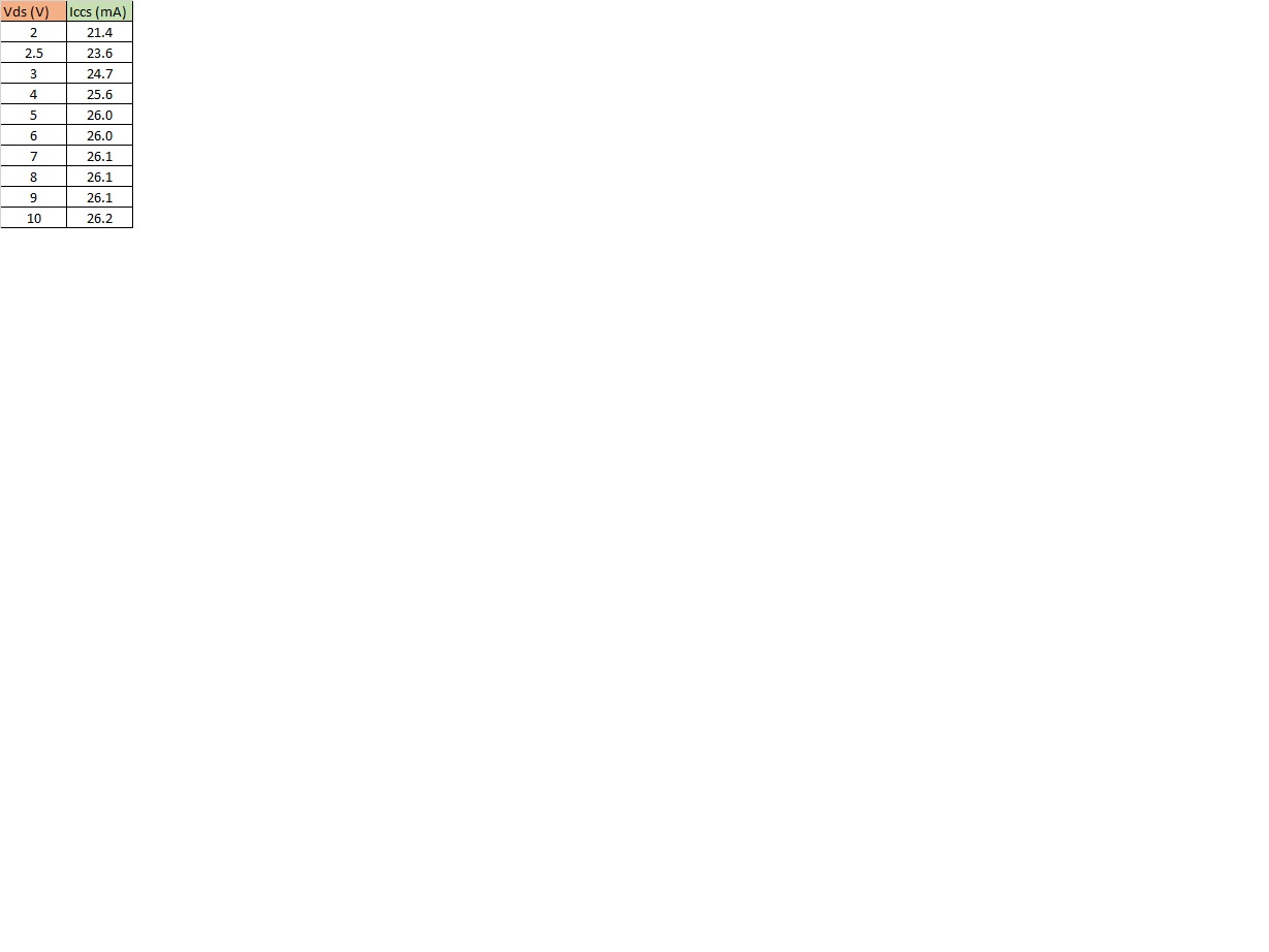

Walter you solved the offset issue but if you look at datasheet you`ll see that J310 do not work as a CCS at such low Vds voltages especially at such a high current, BUT there`s a little Vds voltage change in this case so it does`t matter as much. You could try bc5xx/led ccs, maybe would be better sounding, but you made the whole thing, so enjoy!
I think you are right...did some testing with the CCS:
Vds (V) Iccs (mA) 2 21.4 2.5 23.6 3 24.7 4 25.6 5 26.0 6 26.0 7 26.1 8 26.1 9 26.1 10 26.2
Between 5 to 10 Volts the CCS is working correctly. So if I raise the rail voltages to 12.5 - 17.5 Volts I'm OK?
Juma said Vout = around 7Vpp with the 10 Volts rails, so this will become higher also...that's a good thing....
Only downside is that I can't use the DCB1 rails and have to build a separate PSU
