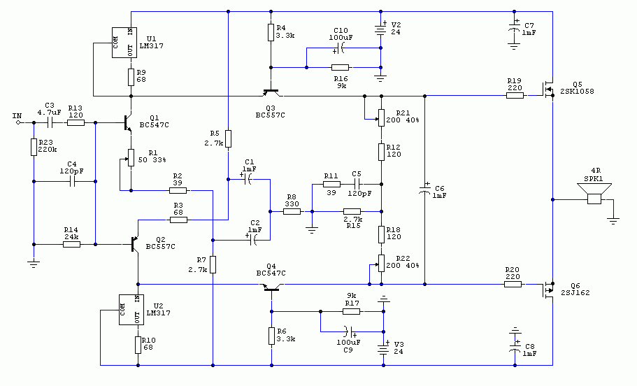

Haven't powered it up yet because I am not too sure of the 200 ohm trimpot settings (minimum or maximum value) at start up. Juma said it sounds 'velvety'!!
If I were you I would set it up 1/2 way at 100ohm and install a light bulb in series with mains power.
Look schematic, 200Ω/ 40%.
Thanks zeonrider, I saw 40% on schematic already. But just wanted to slowly ramp up bias, just in case..... Since Juma might be busy and has not chimed in here, I will set the trimpots to about 50% and then see which way to turn. Juma said 1.2A in post #118. Thanks again.

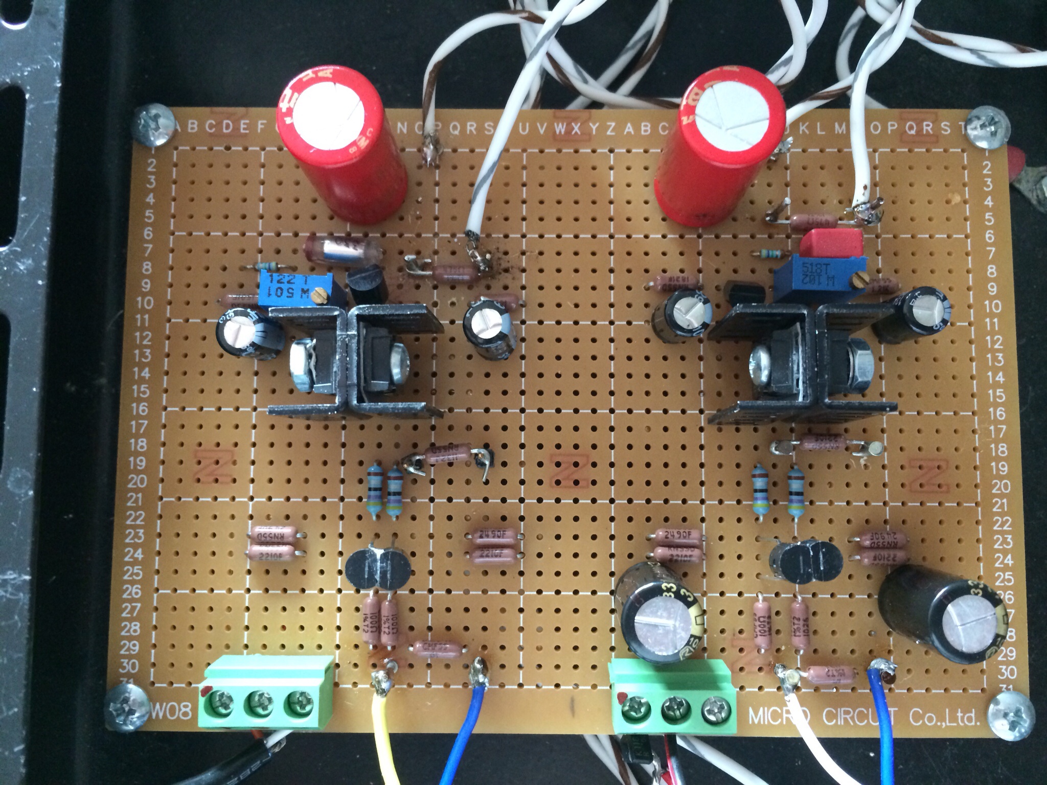

Yes, pots to minimum resistance before turning the amp on.Juma, I have assembled the board for the amp shown below. Would like to know whether 200R trimpots are to be set at minimum for setting bias of 0.7Amps?
Boards for the attached preamp is also ready but not yet assembled. Thanks.

juma,
i am curious to know what is the reason to choose a resistor value of 220 for r7 ( on the schematic post number 1).
wouldnt a higher value give less distortion? is it aquestion of dc offset?

Well, I have assembled a single channel of Juma's Amp at post @118, schematic of which is attached herein.
It is fabulous. I will reserve my further comments until I complete the other channel and get it all tidy in an enclosure.
In the meantime, I have a question since I can hear audible noise/hiss through my 94db Fostex speakers even with PSU caps totalling 22,500uF per rail (CRC) and front end supplied through diode and filtered with 3300uF per rail.

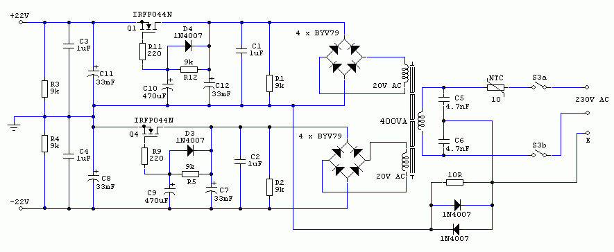

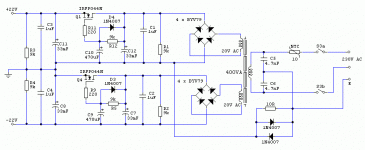

I want to use a capacitance multiplier capable of atleast 2 Amps current and low noise (100uV or lesser) for the output section.
I am also attaching a schematic of a PSU to multiply and regulate supply for the front end.
My question is, what should be the value of R21, 22 to make it suitable for the front end of Juma's Amp?

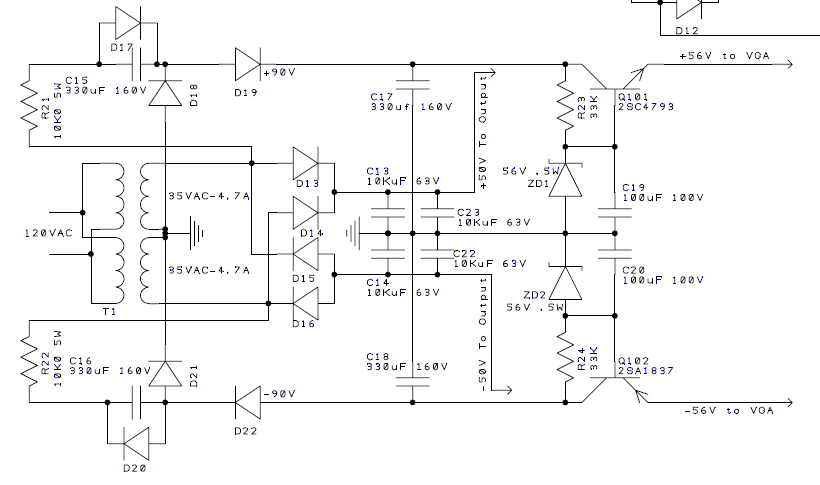

Thanks dobrivoje, that is also a capacitance multiplier but it needs about 4-6 volts headroom. I am thinking of using a BJT series pass which needs 2.5 volts of headroom for the output stage.
My question is regarding the cap multiplier-regulated supply for the front-end, tapped off the same main transformer. I measured Juma amp front-end and IIRC it draws a little over 120mA!
Any help? Thanks.
Any help? Thanks.
Those resistor are not necessary. The circuit will work well without those.
I am using the same circuit with 10ohm resistors and it works great.
