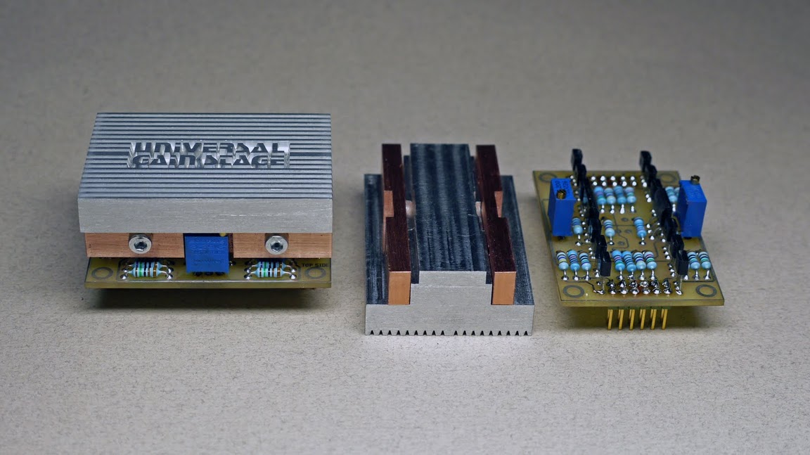

couple them all ........ or use servo

better to clamp them all

first,
i d try to couple the ccs jfet only and the rest of transistors...simply close to each other(ideally face to face).
2 cents...
2 cents...

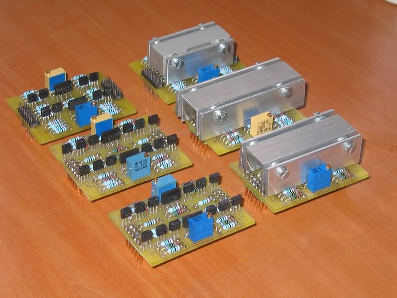

Coupled the devices as I did (shown in post#440), it didn't drift with time but still drifted with temp change. Five degree of ambient temp change easily caused a few tens of mV drift. Although this is not really dangerous but annoying so I used coupling caps.

...François Torres' UGS 3/4 ....better known as CheffDeGaar...there is a thread here on some of that.
Actually ZM is only half right....he is half French half Portuguese ( ...the Torres part ) 🙂
