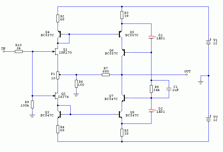

I didn't got the time to work further on that circuit so I can not offer any new suggestions but it'll do very nice as it is. Practical build will show if some additional adjustments are needed - current ranges of CCS and thermo coupling but those details are alredy known.
I played with the idea to use the current mirror instead of resistor/CCS in the BAF 2013 preamp circuit and I protyped attached circuit. Besides current mirror I decided to introduce the feedback loop (R7/R6, sets the gain to about 3,5V/V i.e. 11 dB).
The preamp now sounds (I think) a little bit better, the Zout is lower (about 270R, due to the feedback) so the bufer is not needed for most of the systems.
DC offset is behaving better too. With +/-12V PSU this pre will swing about 10V_peak at the output.
I used the JFETs with Idss of 7.5 and 9 mA and after setting the DC offset with P1 the Id through them is about 7mA and 11mA flows through the folded cascode (Q6/Q7). JFETs with other Idss values can be used but then R3/R5 have to be changed in order to set at least 10mA through Q6/Q7 (there is also about 1 mA going through LEDs).
Anyway, I think it's worth a try. :)

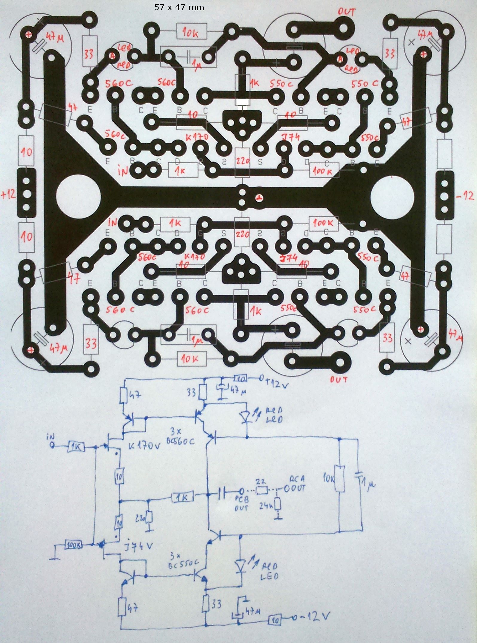

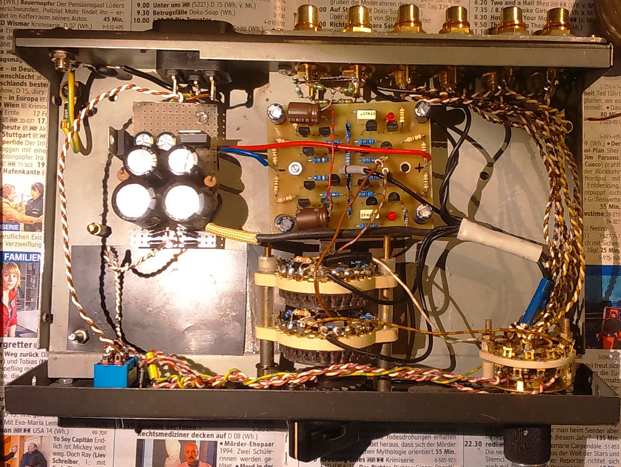

I forgot to put the pictures of the lovely preamp from the post #485 so here they are.
You'll notice that emitter resistors in current mirror differ from one schematic to another (it's the same gain stage used in Cubie2 amp). That's because the current through JFETs depends on their Idss and it can vary wildly since all grades can be used here (GR, BL, V - only important thing is that both JFETS should belong to same grade). At the same time we want the current through Q6, Q7 to be in range from 12 to 15 mA (depending on PS voltage, +/-12 to +/-18V which will cover all the usual needs, except driving the F4 to full power). To achieve that, current mirror emitter resistors have to be chosen in accord with JFETs at hand.
I didn't bother to null the DC offset - I don't mind using the coupling cap here. Of course, you can use 20 R trimm pot instead of JFET source resistors and add the P3 (known from F5 sch.) to set the prefered "harmonic structure". The trick with small trimm pot in current mirror (see Cubie 3 sch.) can also be used - it's all about experimenting, testing and finding what one likes the most...

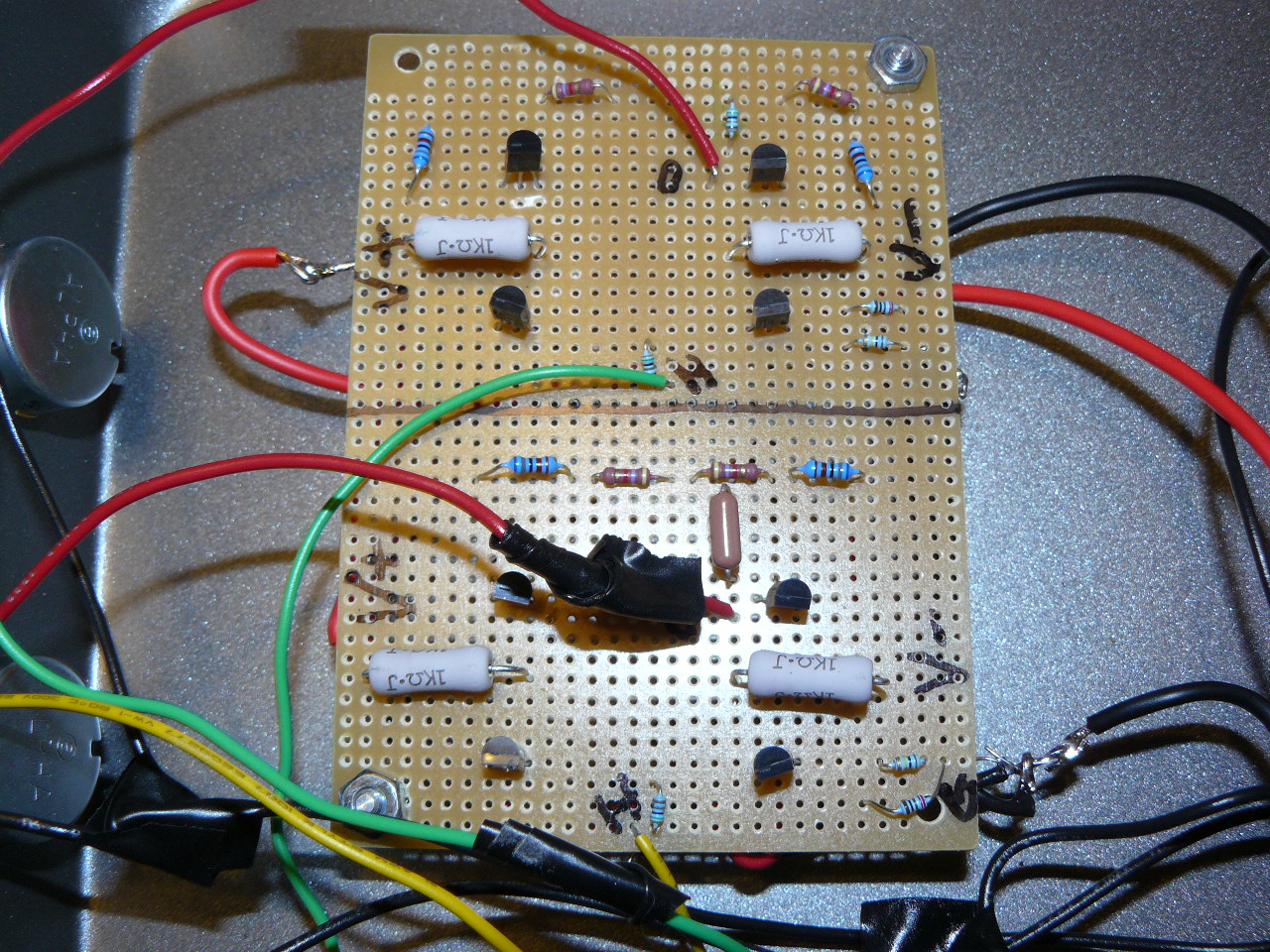

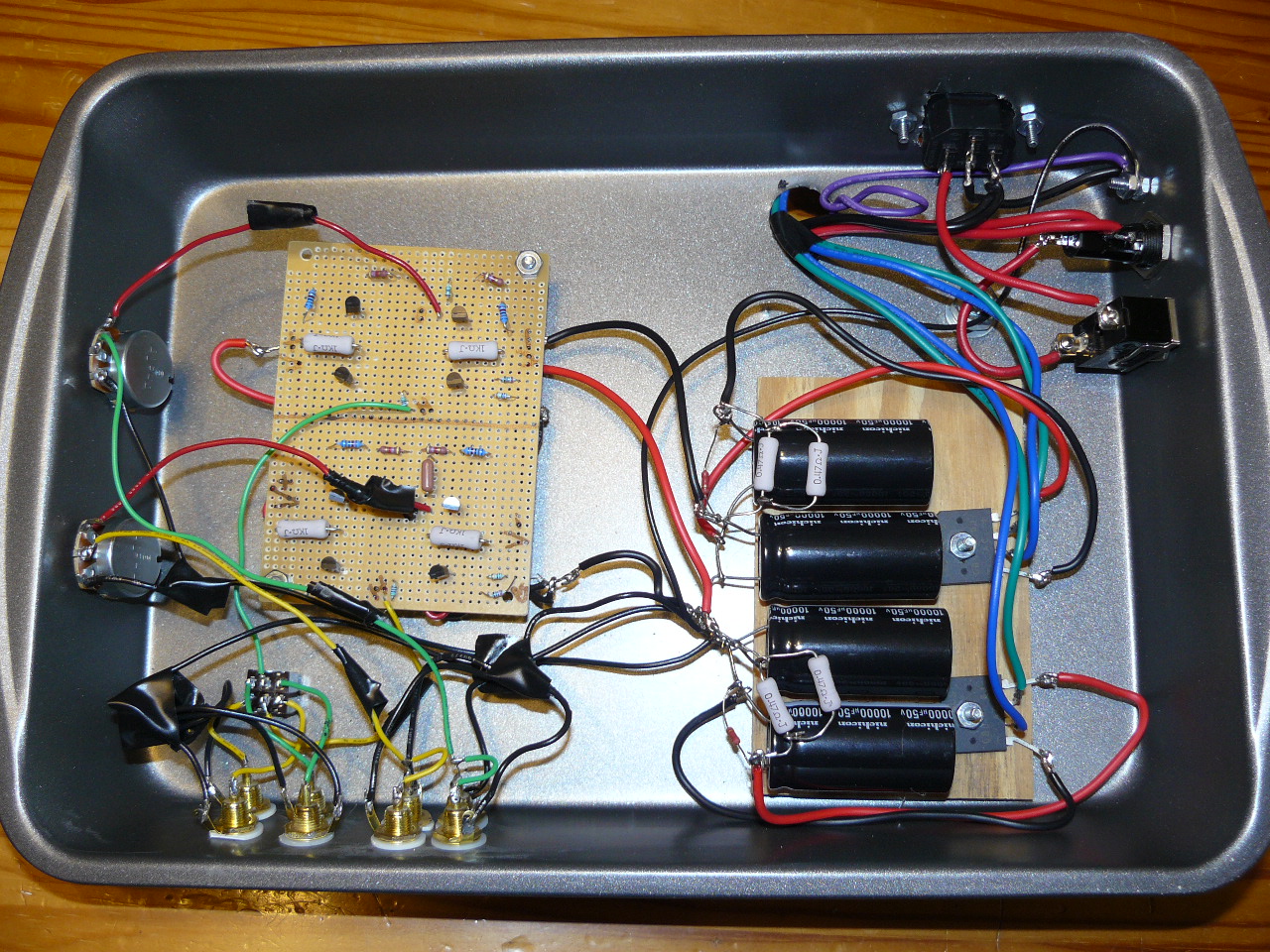

I think it is important for Mr Pass to know that there are some cheap diy'ers building the designs he has went to the trouble of providing for the diy community. I just finished building this linestage following the schematic and instructions at the BAF 2013 to go along with my just finished V-fet amplifier. I used an Antek AS-1232 100VA 32V rail transformer and just a typical FW PS using 20K uf for each rail in a CRC fashion. No regulated PS. My voltages were 46V unloaded. I used some of the LSK J-fets I bought last year matching them as close as possible with the 8 in the set for each one you purchase in our store. I was pretty close to the 15 iss value with most matches within .1 tolerance. It sounds fantastic. Carol Kings voice never sound better. I have not done any comparisons yet being I just fired it up this morning. The build was pretty straight forward on the protoboard which is not my most favorite way to build. I can get confused going from installing on top and hooking up on the bottom but this build did not give me any problems other than forgetting to hook up the pots to begin with. They go on the output which differs from the usual setup and I forgot about them. I usually work from the input then pots on back.
I do have one question. What value pot is considered correct for this build. I thought I had read at one time 10K was what was suggested. I use 2 pots to have some balance control, my listening position is off to one side, and I just used what I keep in stock some 250K and there is too much turning with nothing much happening before I get it balanced correctly. I realize I do need to some lower resistance pots.
I now realize I should have said perfboard instead of protoboard. The picture tells the story though.

I decided this morning to move the pots to the input just to see.... In my opinion this is where they need to be. I like it much better this way. I also installed a couple of 4uf film caps to the power supply just because. I plan to compare this pre to my BA'3 one in the future. Last night I did a brief comparison, this is before the pot change, and I thought the BA'3 had a warmer sound. I do not have any way to measure the 2nd harmonic of each one so it is not a fair comparison.
I can say with my new V-fet it sounds great. My first thought was the bass was tighter and stronger with this pre, probably just in my head.
