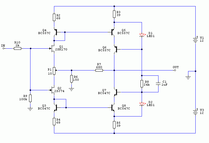

I played with the idea to use the current mirror instead of resistor/CCS in the BAF 2013 preamp circuit and I protyped attached circuit. Besides current mirror I decided to introduce the feedback loop (R7/R6, sets the gain to about 3,5V/V i.e. 11 dB).
The preamp now sounds (I think) a little bit better, the Zout is lower (about 270R, due to the feedback) so the bufer is not needed for most of the systems.
DC offset is behaving better too. With +/-12V PSU this pre will swing about 10V_peak at the output.
I used the JFETs with Idss of 7.5 and 9 mA and after setting the DC offset with P1 the Id through them is about 7mA and 11mA flows through the folded cascode (Q6/Q7). JFETs with other Idss values can be used but then R3/R5 have to be changed in order to set at least 10mA through Q6/Q7 (there is also about 1 mA going through LEDs).
Anyway, I think it's worth a try. :)

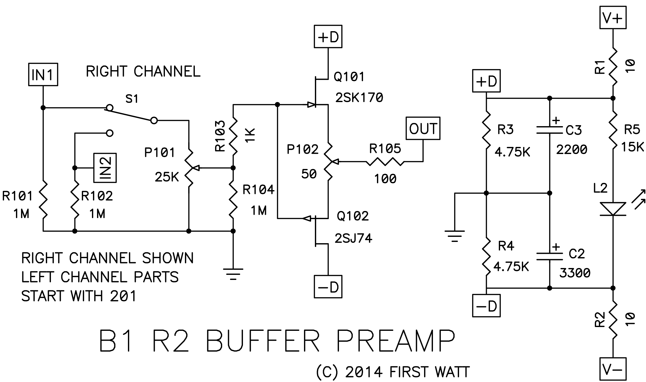

I thought I would mention I am using a $10 24V switcher I bought on Ebay for power and using Papa's B1 R2 trick to make 12V + and - with ground. Quiet with 103db horns. Makes it a cheap build for a diyer.
Update on the $10 switcher. It was quite with the F4 but when I tried it with my other amps it was too noisy. I replaced it with a Meanwell switcher and it is now acceptable. This pre deserves a proper PS so I am going to build a regulated transformer powered PS for it.
Use the B1 R2 trick of Nelson's. Switchers do not have a CT or what is called ground so you make one with this circuit. With a 24V source you will have +12V and -12V and a ground. This comes in handy when testing circuits with a switcher before building a proper PS. If you measure between D+ and D- you still have 24V but in reference to ground 12V.

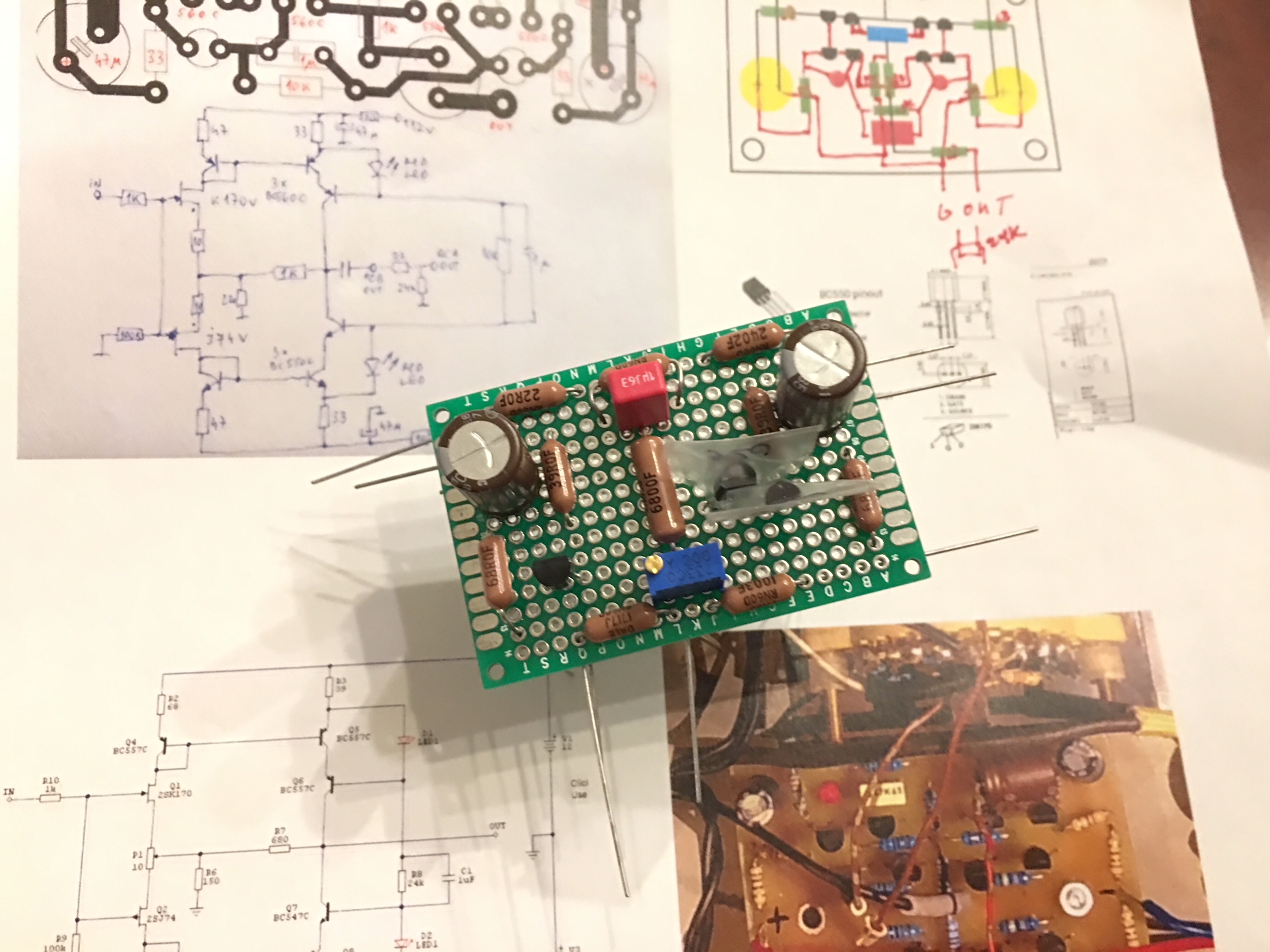

I am giving this one a try. Looks promising for the Pass F5.
I have never used current mirrors before. Do the current mirror BJTs need to be tightly matched? I have a good match among the P side and N side but the N parts don't match the P parts (500 HFE vs 525 HFE). Also, do the BJTs need to be matched channel to channel?
Better match the LED's too?

Matching would be nice but not crucial, say 10% or so is ok. Jfets and bjts both, between the channels too. Trim pot will set the dc ofset at the output, thermal coupling will help but it will work fine without it once you close it in the box.
Symmetry can also be achieved by slightly changing the degenerating resistors in current mirrors.
Leds should be of the same type (3mm red) and they'll be matched enough by themselves..
Current through jfets will be set by their Idss and source degeneration and copied to bjt stage by current mirror - that current can be increased to wanted 10-15 mA by decreasing the current mirror degeneration in that branch.
Measure and listen and don't fret about some dc ofset at the output - use coupling cap before you close it in the case.

Thanks Juma. Yes, Iam hoping it’s dc stable but I have some nice film caps I can use if it’s not.
I plan to first try it as a line preamp and maybe later add some lateral fets like cubie to use it as a headphone amp. I have ba3 front end and Salas’ DCG3 as well but I want to try something with less current as the Pass F5 has a 100k input and doesn’t need all that current. Thanks again.
One channel is complete. It seems rather DC stable over an hour. Should I risk no cap on output? My power amp is DC coupled.
Stupid question? How do I measure to ensure I have 10-15ma through jfets? Can I measure across R2/R4?
