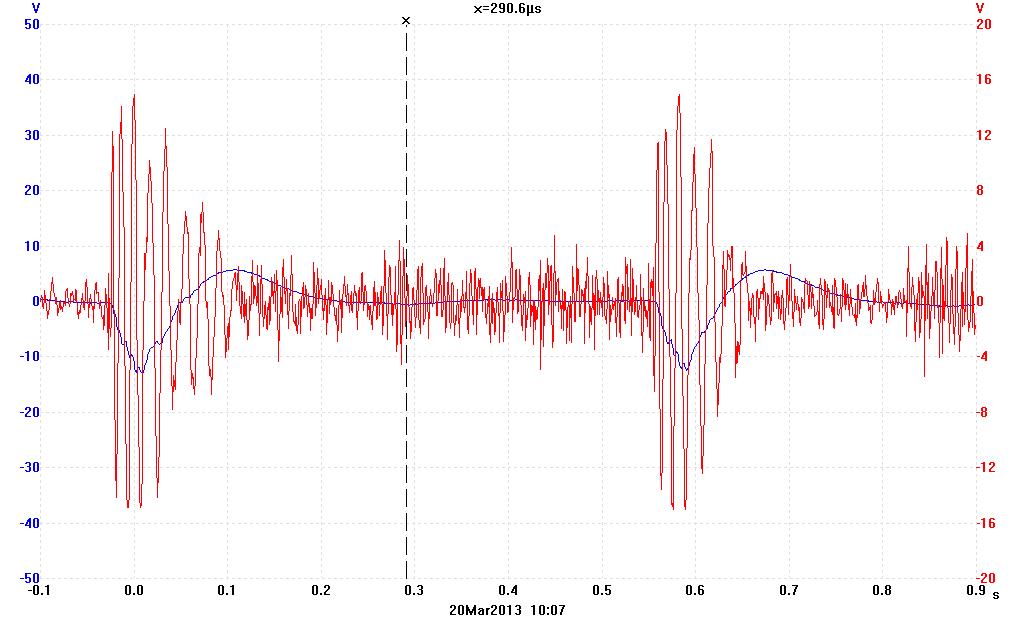

Like this? Done with an analogue gate I built about 20 yrs ago.🙂
The blue trace is the PS sagging under load.😱
Yes, as you started doing 20 years ago 🙂 , I see you were using a 10 millisecond burst of 1000Hz, I guess you changed the burst length as required.
This technique is also handy for amplifiers that red plate when ran at power.

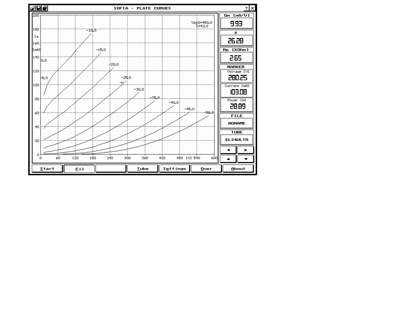

I like to re-itter something said: the static loadline with max power is given in the dotted curve of the first diagram, the 25W curve, DC conditions. Now, taking an operating point below that line, you can calculate how often the spontaneous transmission (nice word here) is going to be, for that, use a calculous of the
Just a remark: having worked with such PP amps, the 450V from the chart is the Vb, from that deduct the 30-35V cathode over the cathode resistor [One often forgets, I do at least], so the DC could be 420Volt anode-cathode.
- sine wave and what the length of time is the tube is in the above-the-line situation
- the programming material - how often do peaks occur (not much)
- the tube permissbible overload, as mentioned, TV-tubes are made for operating instantaneously 'above the line', repeatedly, without harm. As long as it is a very short period for everything to calm dowm.\
One thing that is often forgotten is the class AB maximum dissipation. I know solid state folks are conditioned to keep the loadline inside the SOA for all instantaneous conditions (with good reason), but the only thing that applies here is the maximum average dissipation. Approximately B+^2/(2.5*Ra-a). Keep that (and the quiescent) under the max plate rating and all is fine. Once you take care of that, you need to keep screen dissipation under control. There is no easy way to calculate where that maxes out because that screen current is nonlinear and varies depending on a lot more things. You would literally have to do numerical integration on the Ig2 curves for the specific tube in question and operating conditions. And dont make the mistake of blindly trusting a spice model because you don’t know how well it matches secondary parameters like Ig2.
Thanks wg_ski, 3k5 Raa at 450V B+ is indeed still within the 25W max plate dissipation of the EL34.
I'd try the 4k with 23%UL and the 6k6 with 23% without any feedback and see what I like most: when I tested 6V6GT I've preferred 8k (more linear) over 6k6 (a bit of midrange prevalence).

Here is that same 6V6 PP Class AB2 Amp with Peter Gabriel Doing Salsbury Hill.Like this? Done with an analogue gate I built about 20 yrs ago.🙂
The blue trace shews the power supply volts bouncing as Gabriel hits it.
What information would you like? Keep in mind this amp is experimental.
Class AB2 is usually not considered HIFI. One of the objectives of this build was to try Class AB2 both
on a limited PS, then on a stiff B+. For that I used my lab supply. All that gives a measure of headroom,
something manufacturers of low cost equipment rely on. As do guitarists.

In attach the test with Sofia on EL34 UL connected.
Walter
Then ?
In addition, which is the optimum load?
When in the real world the Zload is always varying with frequency?
Walter
