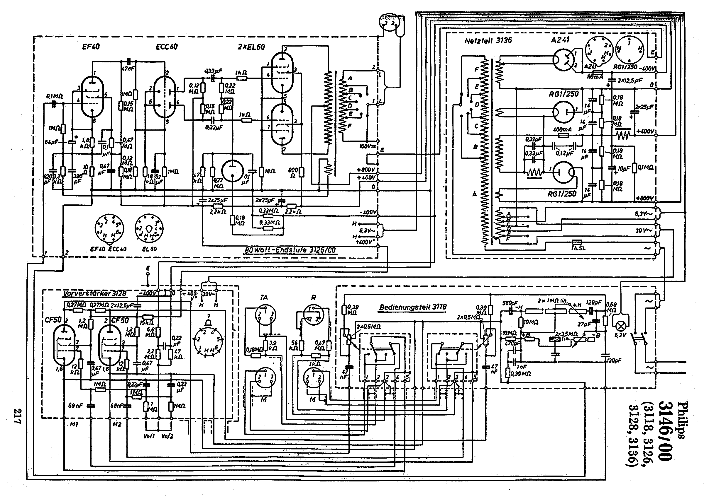

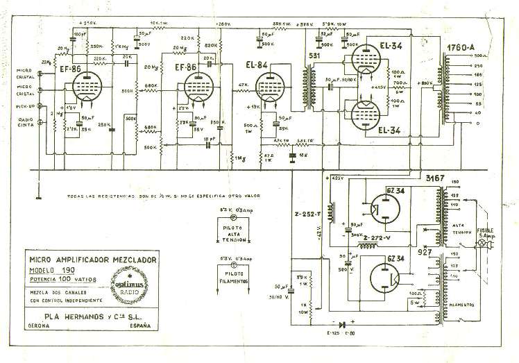

Some more amplifiers with EL34's (EL60's) at high anode voltages (900 V in the Siemens ELA 2796). Ofcourse the anode and screengrid voltages sag with signal.

2 x EF86 + EL84 triode transformer-coupled + 2 x EL34 pp + 2 x GZ34 (Optimus 190).jpg58 KB · Views: 236

2 x CF50 + EF40 + ECC40 + 2 x EL60 pp + 2 x RG1-250 + AZ41 (Philips 3146).gif151.2 KB · Views: 232

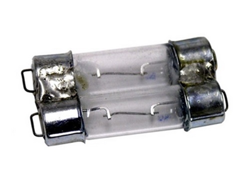

Is that common to blow tweeters?

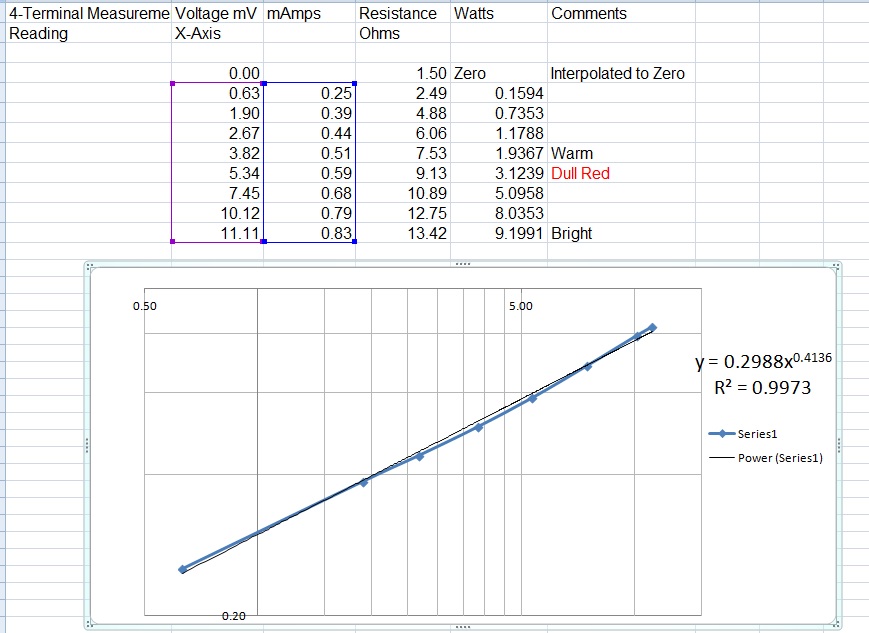

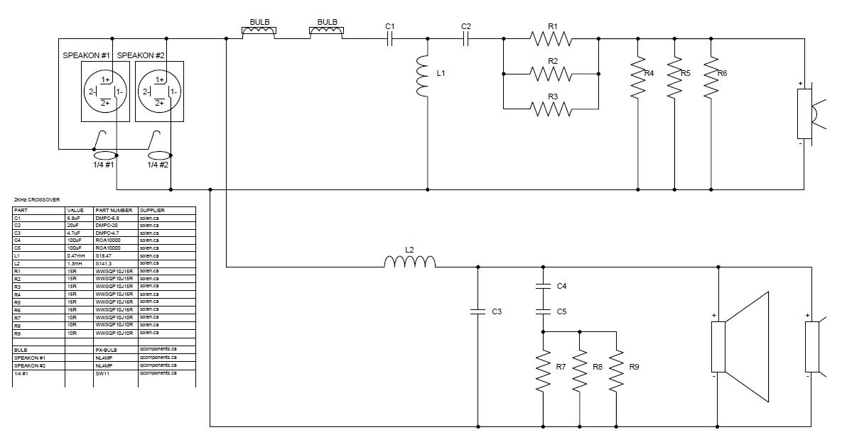

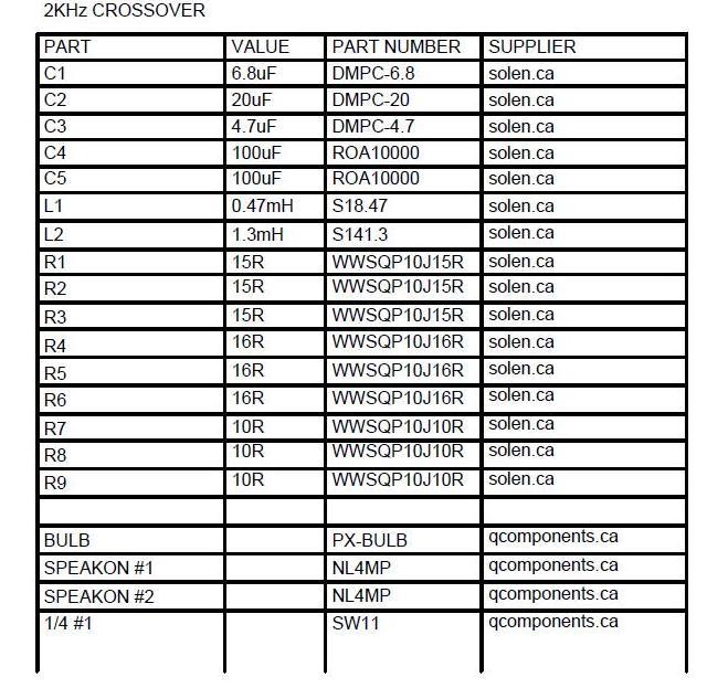

At clipping the HF power developed increases rapidly. Some Crossoveer Networks design in tungsten lamps in the HF end to control the degree of HF going to the tweeters. A commonly used device is the PX bulb.🙂
Thank you PFL200, as far as I know some tried to fit modern EL34 to this kind of old designs, and got fireworks. Apparently the quality of the EL34 went down to usual requirements in most amps (400-450V B+). NOS tubes are out of my budget and also out of my desires TBH.
That tab is great jhstewart9, I remember I found those bulbs in a David Eden 4x10" bass cabinet years ago that was flashing when abused by the bass player.At clipping the HF power developed increases rapidly. Some Crossoveer Networks design in tungsten lamps in the HF end to control the degree of HF going to the tweeters. A commonly used device is the PX bulb.🙂

I would like to know the brand of loudspeaker for Hifi with a lamp in series to the tweeter.
It is an ancient ( and bad) solution never seen in the last 20-30 years.
Walter
Walter

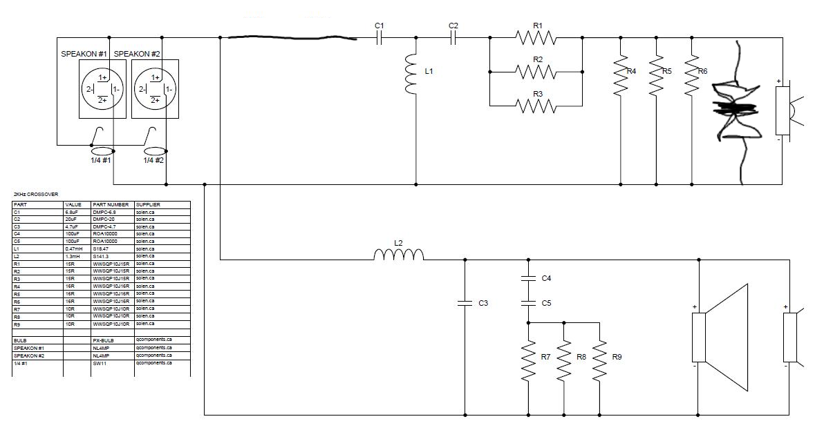

Stupid question maybe, but why not tie a bidirectional TVS diode across the tweeter to prevent destruction? The TVS will eat the (excessive) clipping energy?
(sorry it's messy, it was drawn freehand with a very sensitive mouse)
Gross distortion when those kick in, and produces more load on the amplifier, not less. With PTC thermistors, it turns the tweeter down instead of just clipping.

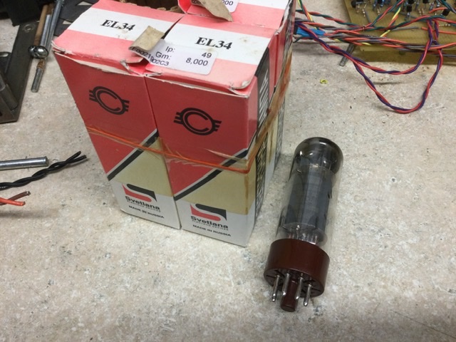

It was fully recognised for guitar amps the only reliable EL34 to get, were Svetlana St Petersburg, a factory that dates back to 1900 or US 6CA7.
What, you mean *these*?
I've paid my university playing in a band and I have to say that the so called "C logo", that is an "S" indeed, were claimed as being the most british sounding EL34 on the market, but never noticed (nor read on guitar amp forums) differencies in reliability with other major brands. I remember Electro Harmonix has been weak for a certain period.
People at Marshall switched to 5881 on early JCM900 series, then back to EL34 on late JCM900 and the 2000 series. Rumors said it was due to weak production of EL34 in that period.
I know the story of Svetlana from beginning.
The last russian production of 34 are more safe.
When well selected they are fine
Walter
Walter

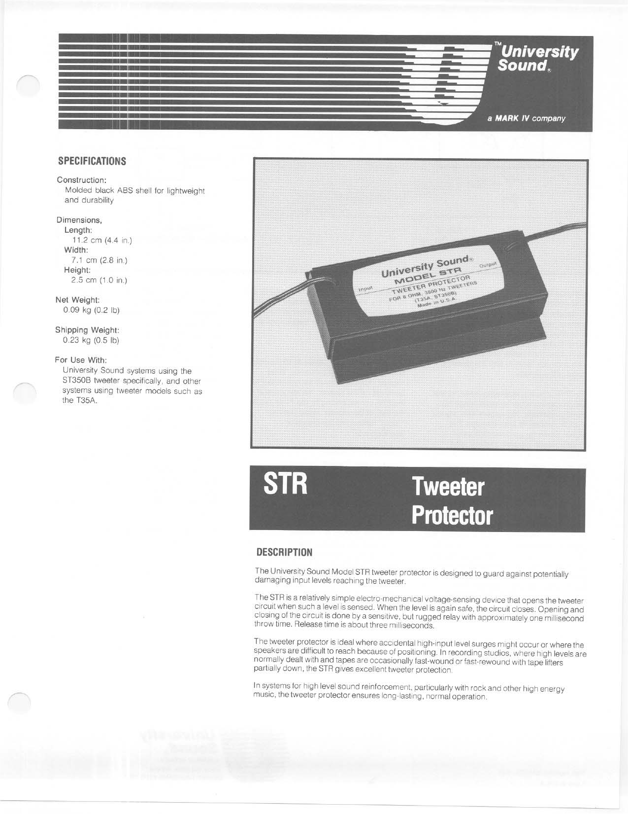

It has been done, professionally, and by none less than Electrovoice.Stupid question maybe, but why not tie a bidirectional TVS diode across the tweeter to prevent destruction? The TVS will eat the (excessive) clipping energy?
They do protect tweeters, no doubt, but sound horrible, so were dropped like hot potatoes:

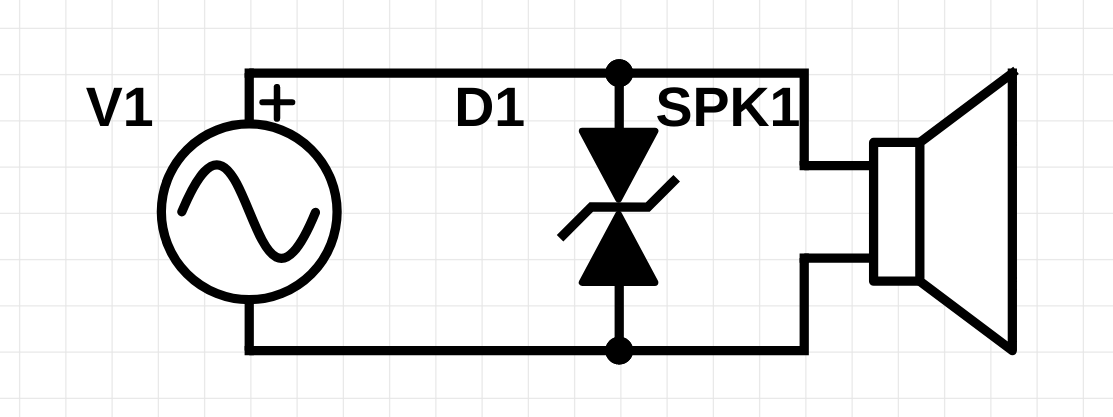

Ok.
That's not what I meant though.
I was thinking simpler like this.
There has got to be a better way of testing a circuit. Why exceed ratings so badly? Build the test amp lower voltage.
