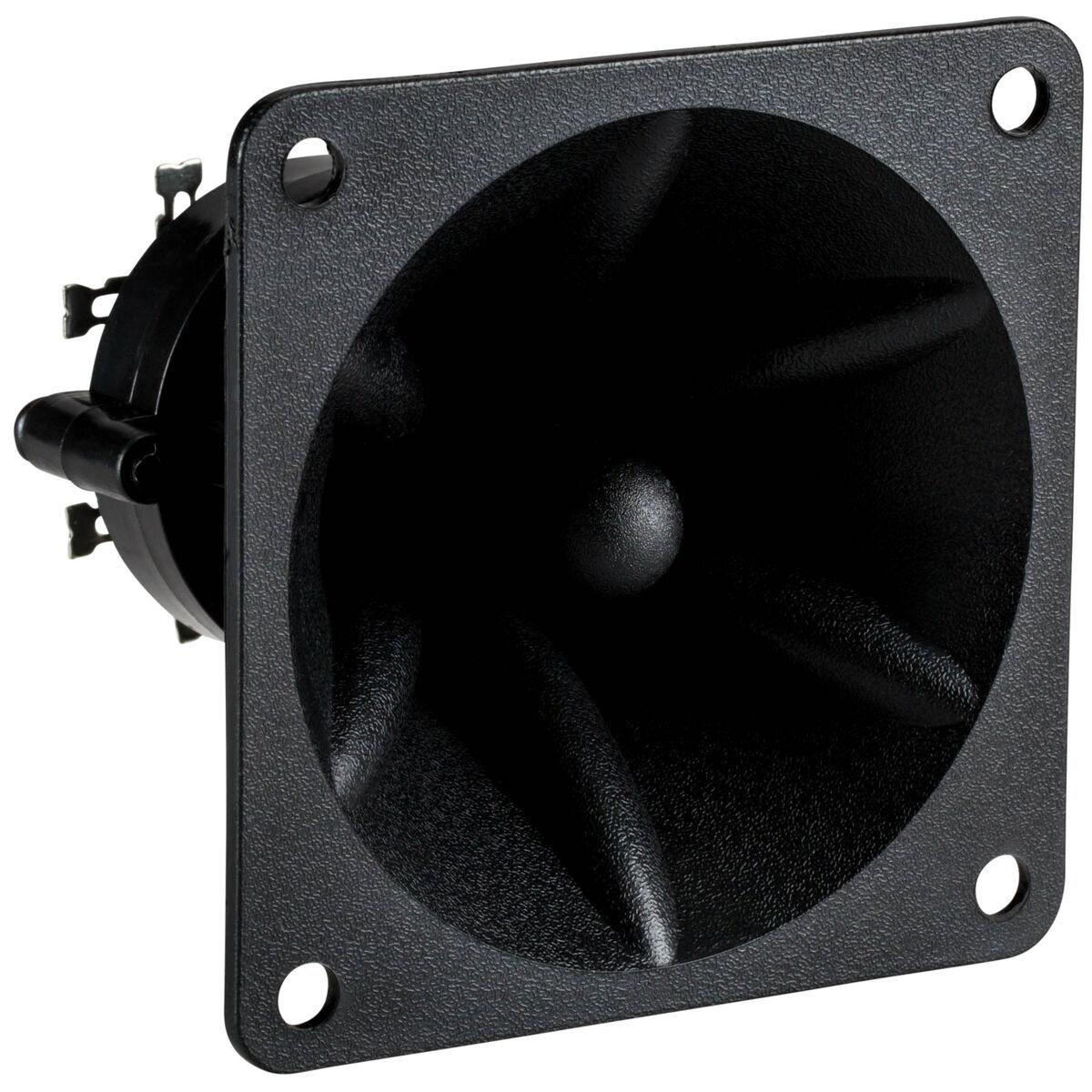

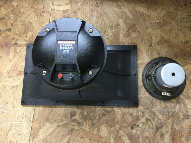

If you really want blowout proof tweeters try these. Perhaps a good match with a 2A3 SET, as well (6.5 inch woofer for comparison).

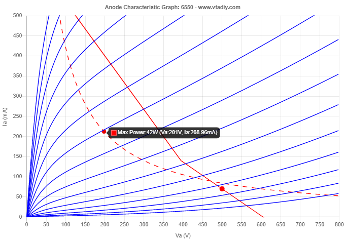

Back on original topic, another "on the edge" design would be a 6550 PP made of two UNSET like in the other shunt cascode&unset thread I opened, with a 3k Raa and 23%UL. It will give around 120 Wrms.
Is there any known criticity with 6550 or KT88?
I'd like to use them because I have them on hand.

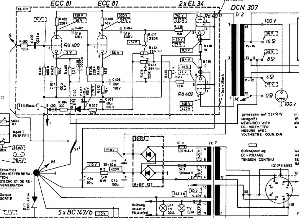

Talking about giving EL34s a tough life, came across one of these recently, a Dynacord Eminent II PA from the 70's. A hybrid with tube output stage, 740V anode and 410V G2, and everything enclosed in a very compact box.
Dynacord Eminent II
Dynacord Eminent II

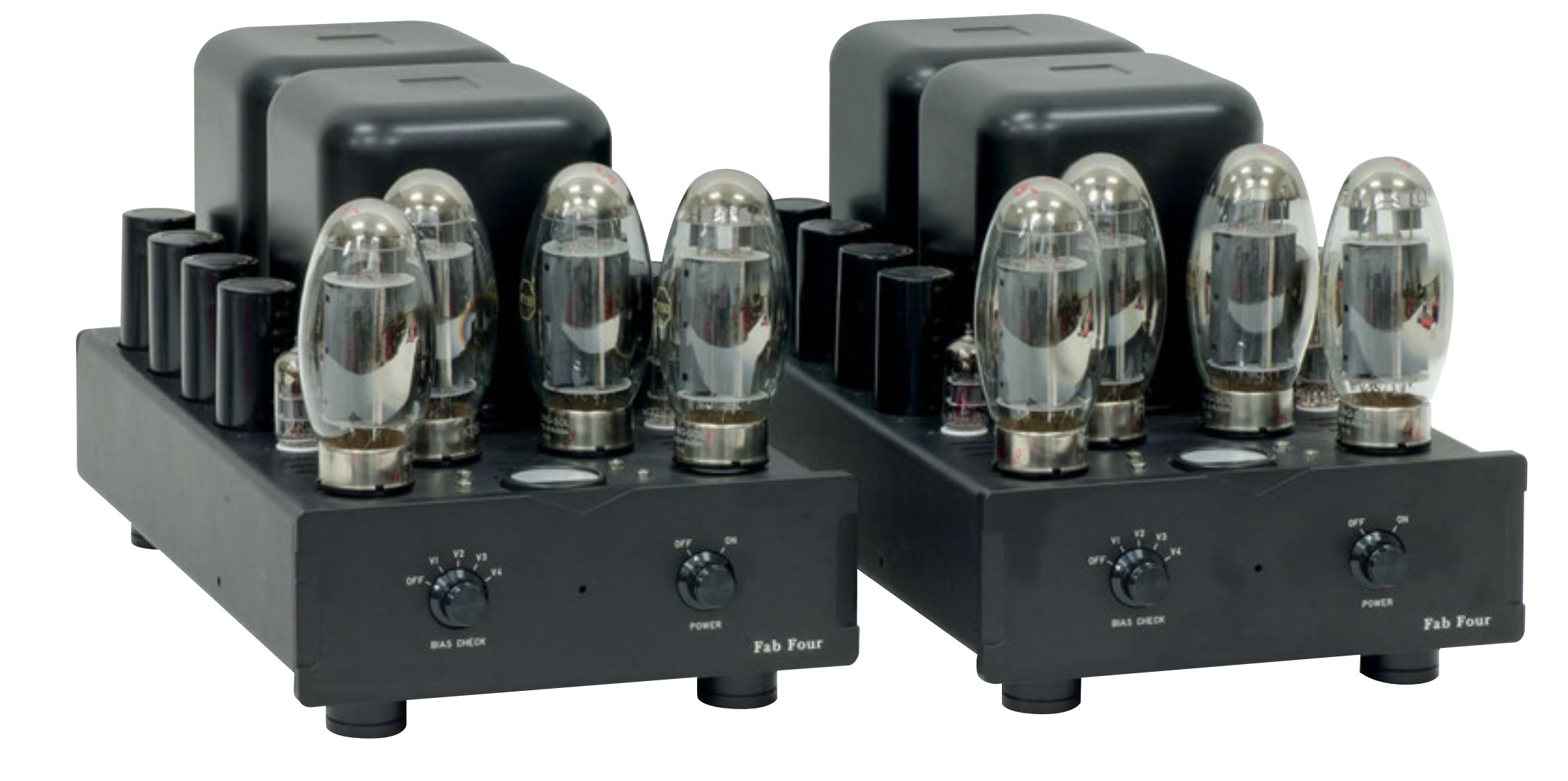

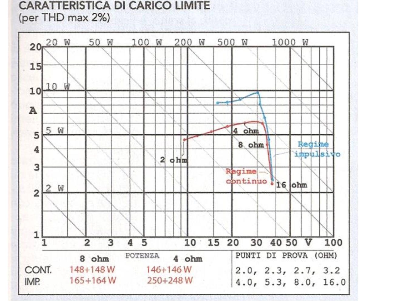

In attach the dynamic test done at Audioreview lab on my monos with 4 x KT150 power amp,tetrode connection, secondary set at 5 ohm.
It is a test driven by AP SYS one with a specific program and an automatic load that changes the Z when the signal reach a specific THD ( in this case 2%, as usual)
It is possible to see the differences from RMS power ( continua) and impulsive.
The blu curves is more vertical and the power deliver is much higher from RMS this because there is a "limit" comes from Joule reserve on power supply that in this case is high.
At around 3,2 ohm ( around 300 watts) the blue curves tends to go down because we are close to the minimum acceptable Z seen by the tubes in this configuration but the capacity to delivery current is high for a large range of impedance
With a poor supply normaly the blu curve is quite similar at the red line (RMS).
The photo of monos.
