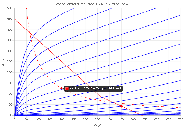

Here is a good way to determine optimum load for PP Pentodes. This is set for a 400V plate supply.
The slope of the loadline depends on the Screen Supply Volts.
Unfortunately that is not published for many audio tubes. But there is plenty of data for TV Sweep Tubes.
For audio I set the loadline somewhat steeper to allow for the impedance variation of the loudspeaker vs Frequency.
Some researchers claim this also reduces 3H somewhat.
Obviously only one half of this image is required to get the answer.
