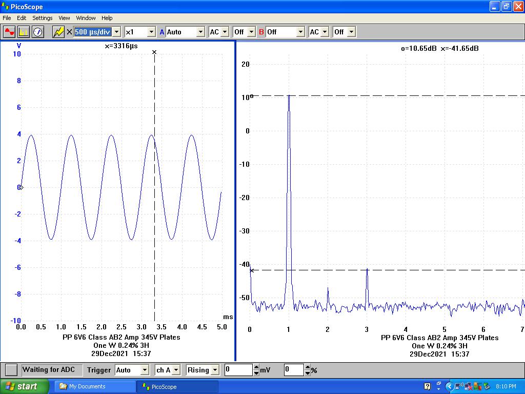

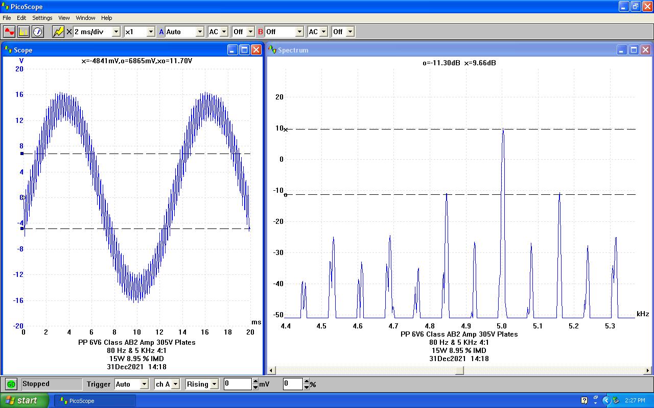

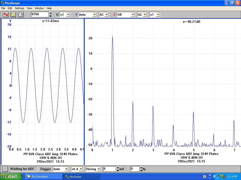

Finally got back to this amp. Keep in mind it was not built for hifi but looks like it performs well.
My objective was to try PP 6V6s in Class AB2, grids to be driven by CFs
The PS was made small, I wanted to look at the PS on recovery from transients.
And explore NFB back to the upper grids of a differential cascode stage.

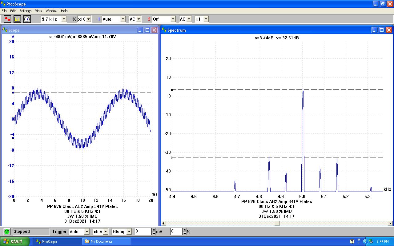

Distortion measurements in this group are made in the usual way plus one set is SMPTE,
Society of Motion Picture & Television Engineers. They use a 2-Tone signal, something at
each end of the audio spectrum. I use 80 Hz & 5 KHz in this case. The measurement looks at how
much the 5 KHz tone is modulated by the 80 Hz. This test is much more difficult for a typical amp to pass.
The SA is a Pico Technology of 10 MHz BW, The Differential Probe used has a BW of 25 MHz.
The spectrum displays in some cases a shewing some artifacts caused by fold back
of the frequency spectrum. More on that later. It is as important for the experimenter
to know what his equiopment cannot do as well as what it can.
At a One Watt level the amp is 3 db down at 13 Hz & 25 KHz. That should satisfy
most listeners except those with Bat's ears.
More on this amp later. And SMPTE.

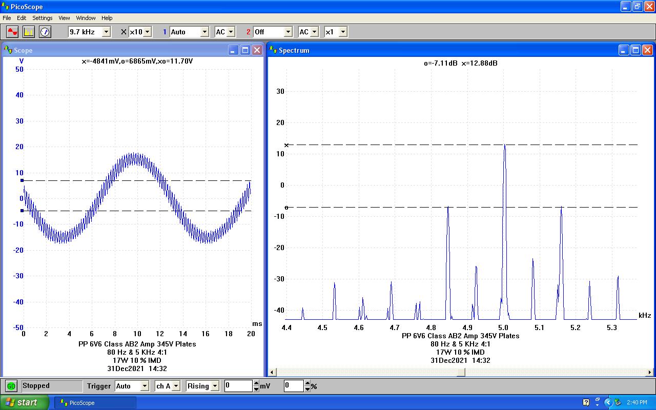

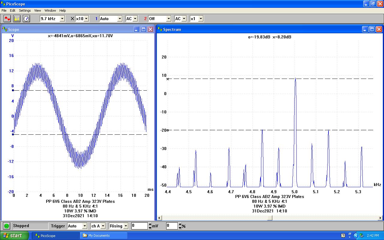

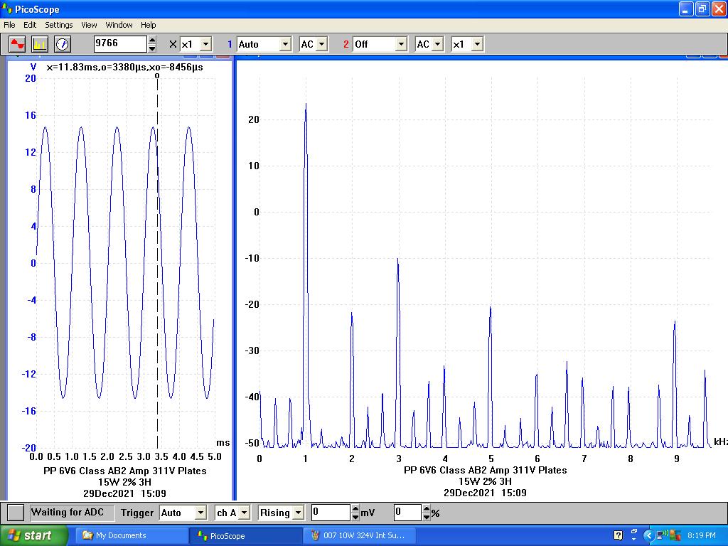

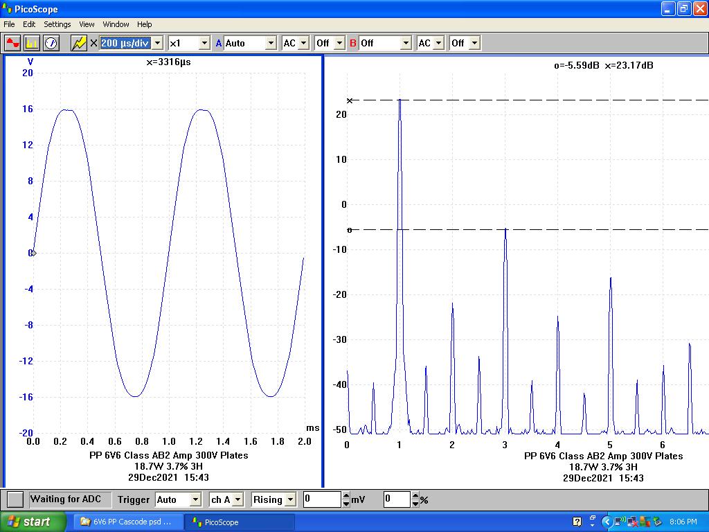

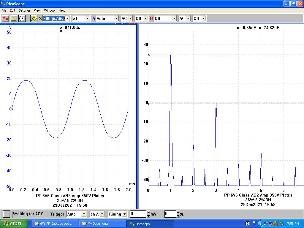

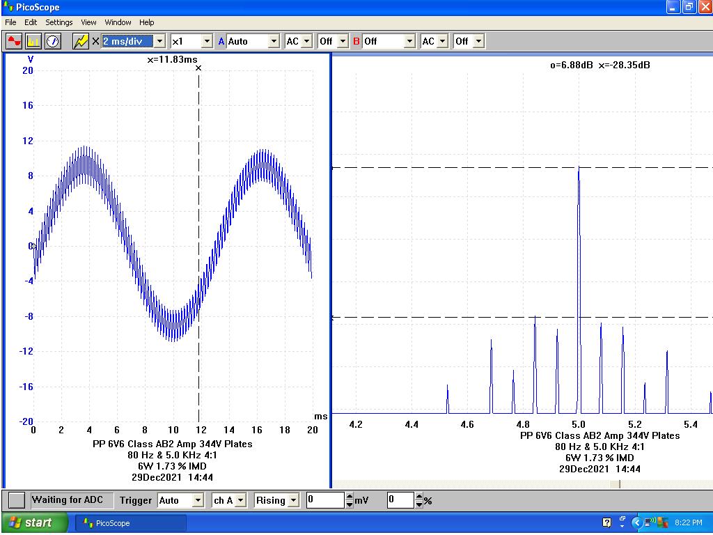

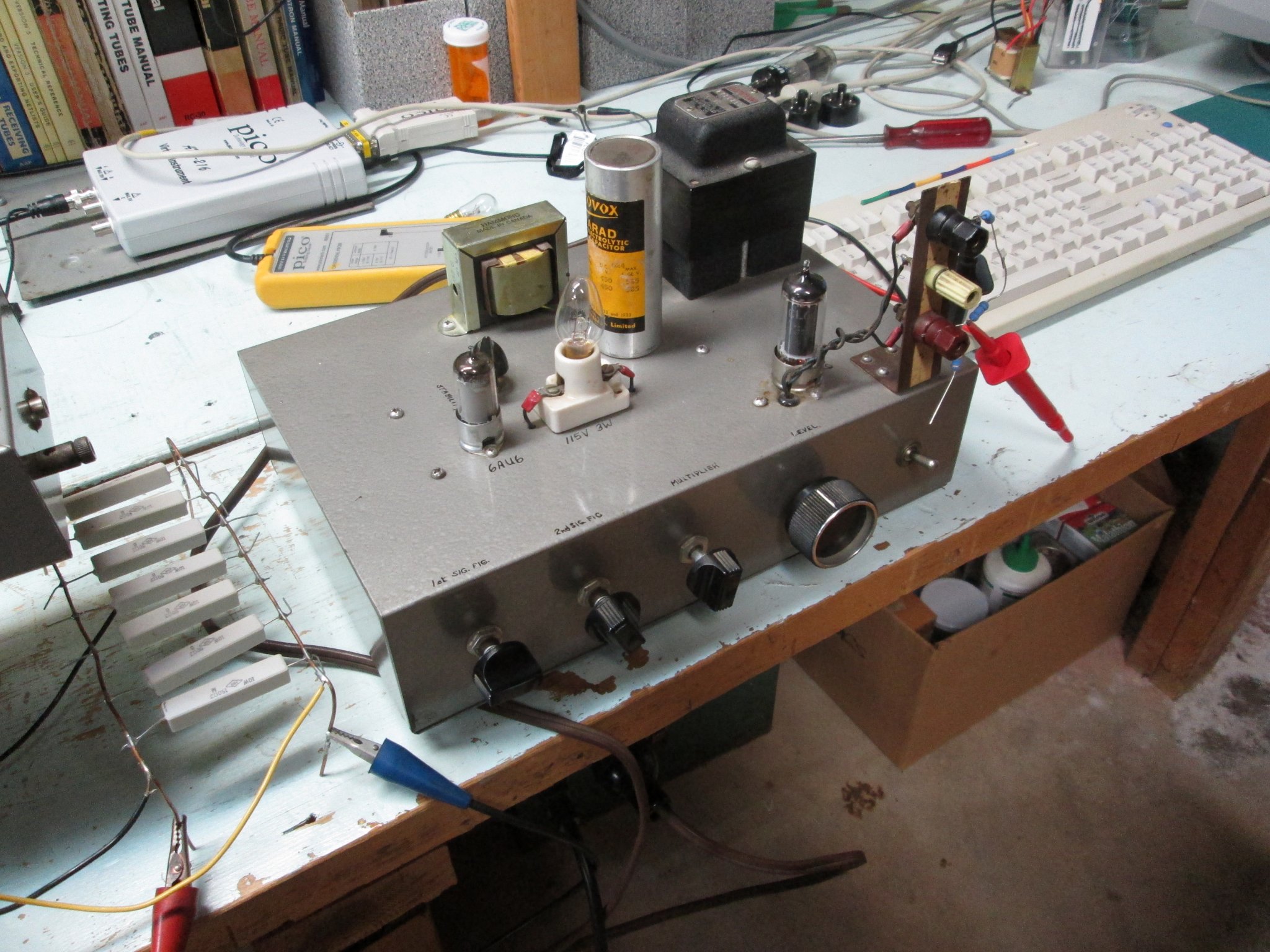

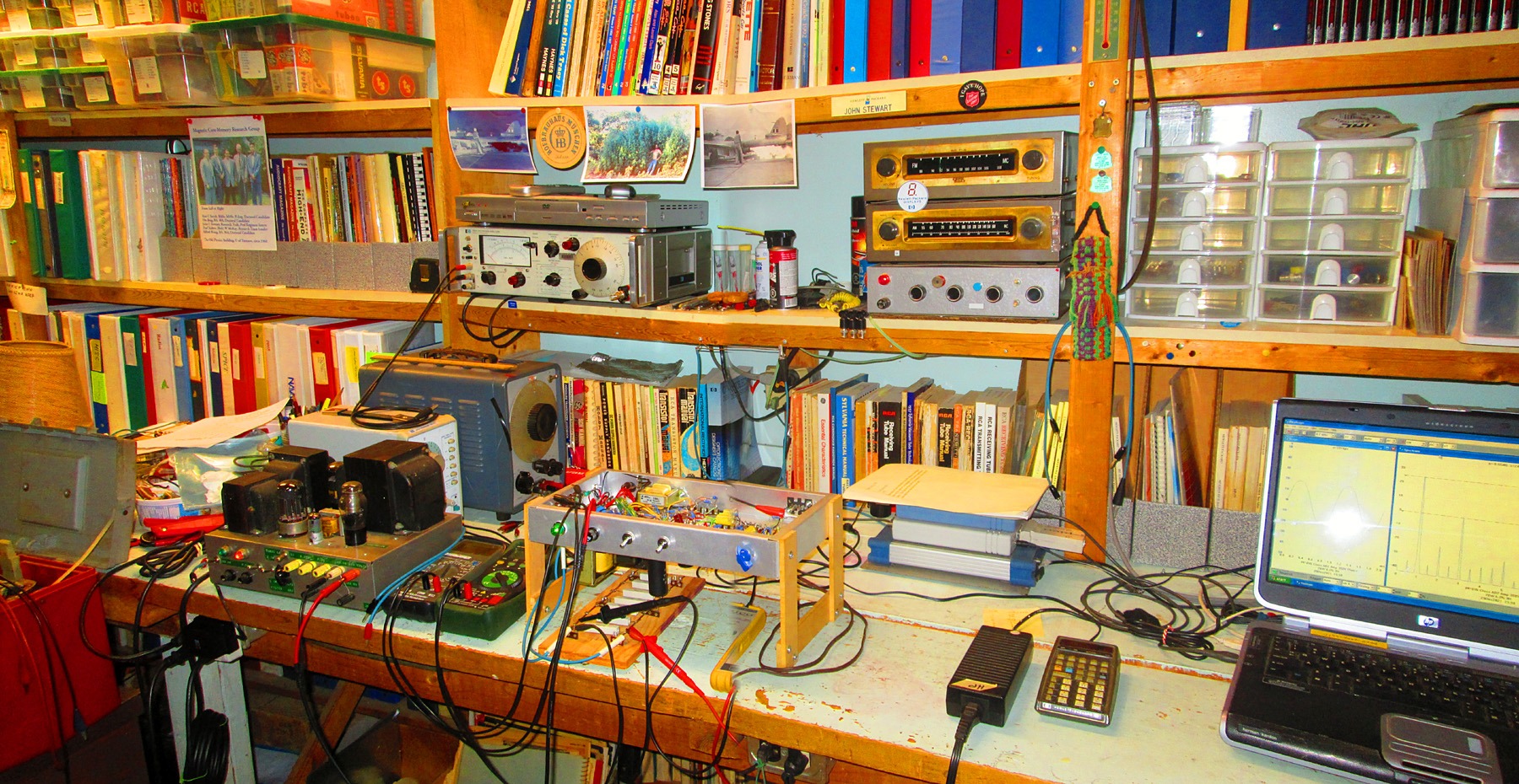

Thank you jhstewart9, that amp is indeed performing well! I will look better at all plots this evening, but what causes that 2nd harmonic peak? A 3rd harmonic cancellation?
I will take inspiration from your work bench for my hobby bench!

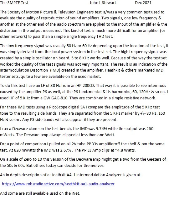

SMPTE Official Definition
SMPTE intermodulation distortion test: The amplifier is fed a dual tone signal, 60Hz and 7kHz in a 4:1 ratio. The intermodulation distortion is the percentage of the residual RMS measured at the output (after filtering the test tones out) compared with the total RMS measured at the output.

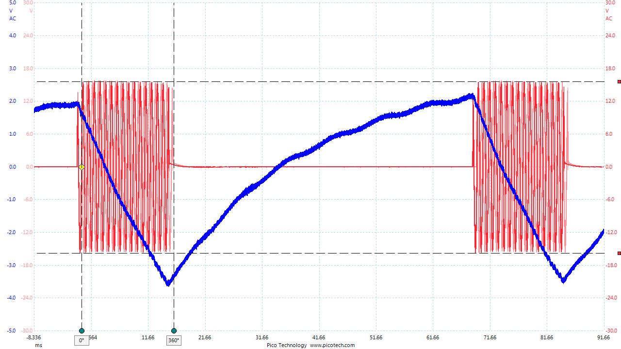

Or how I do it with the PicoScope SA attached.
I ran a Decware clone on the test bench, the IMD was 9.74% while the output was 260 mWatts. The Decware amp always clipped at less than one Watt.
For a point of comparison I pulled an all 2V tube PP 33s amplifier off the shelf & ran the same test. At 820 mWatts the IMD was 2.67% . The PP 33 Amp clips at ~4.8 Watts.

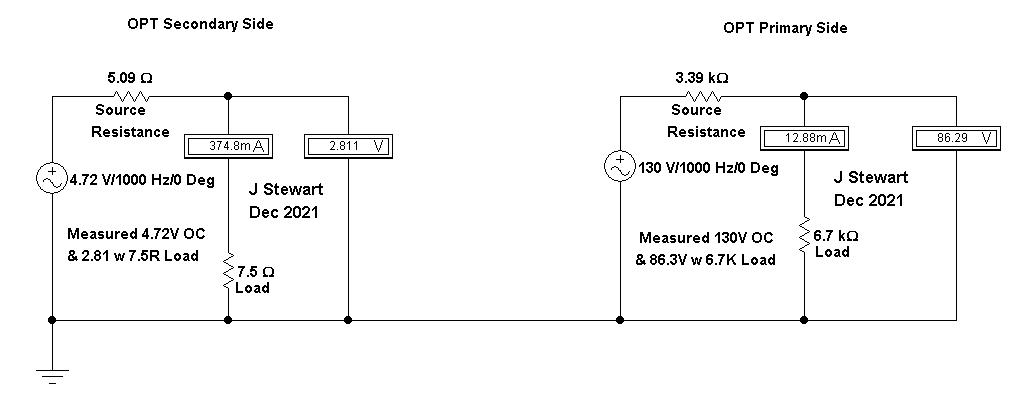

To determine the internal resistance of the amplifier as seen by the load I measured the output voltage with & without the load connected. The internal resistance at One KHz looks like 5.09R, so the Damping Factor (DF) is 7.5/5.09 or ~1.47. About what we would expect from much biased pentodes with only 8 db NFB. But how much of that is the OPT?
Another set of similar measurements at the primary of the OPT shews a much better result. The internal resistance at that point looks like 3.39K, so DF is 6.7/3.39 or ~1.98. The amplifier could benefit from a better OPT.
Running the audio up slowly I found the 3H to be less than the 2H at ~10.5 KHz. But more at other levels. People building distortion cancelling circuits may not be getting what they expect!

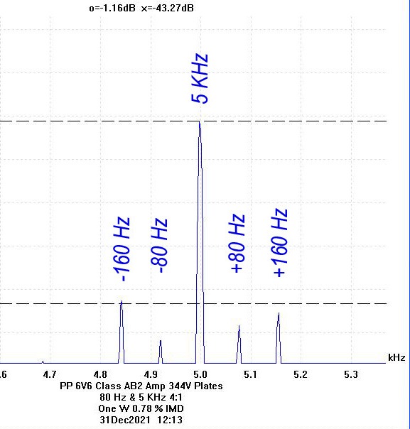

The First Watt is the most important, here is what that looks like on this PP Class AB2 Amp
using the SMPTE Test. Less than One % IMD. That is the degree to what the 5 KHz part of the
test signal is distorted by the 80 Hz LF Tone.
The upper & lower sidebands are identified. They are not at the input, something added by
the amplifier itself. A test most people would never do now but was fairly common in the past.
Many folks with 'fine amps' would not want their jewel tested in this way!

jhstewart9,
Thanks for that story and graph. And the earlier postings; a very intensive study of various circuit effects.
Very interesting.
The graph shows that the 160Hz sidebands are stronger than the 80Hz sidebands.
My Denon Audio Technical CD has 250Hz and 8020Hz at 4:1 (info for newbies: 8020 at -12 dBc).
Left only 0dB; Right only 0dB; L and R -10dB full scale DAC output.
It also has 11kHz plus 12kHz 1:1 for 3rd order IMD testing. L 0dB; L 0dB; and L and R -10dB full scale DAC output.
The date on the CD is 1984. Unfortunately it probably is now Un-Obtanium (can't purchase one anymore).
When I got it, it was much cheaper than a SMPTE capable signal generator. But who knows the price of a used one . . . out of sight?

On these SMPTE shots as the power is increased many more sidebands shew up
at 80 Hz intervals.

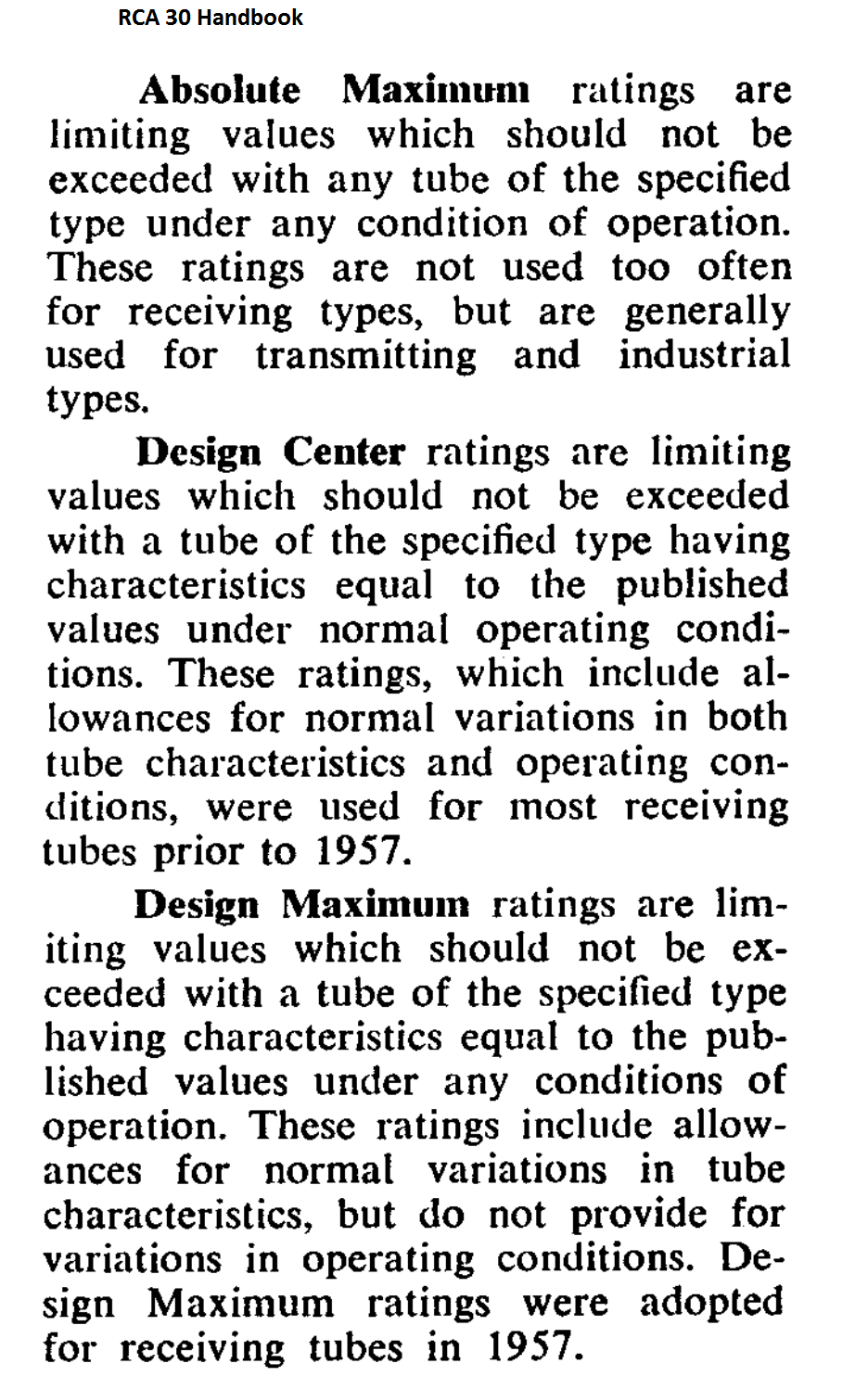

Just be aware of the three tube ratings. Rule of thumb: Absolute maximum (used these days) are about 10% higher than design centre.
The 25 watt anode dissipation should under no circumstances be exceeded, best to stick to no more than 22.5Watt to enjoy expected tube life.
http://www.r-type.org/articles/art-257.htm

Lots to do here aside from DIY. Today I spent a couple of hours
on a tractor pushing snow.
This pulsed One KHz at +15 Watts run on a PicoScope 3224 running driver
r6.8.8 on an olde HP laptop loaded with WIN XP Professional.
The blue trace shews B+ dropping almost 6V delivering that power to
the 7.5R load on the H125E OPT.
I've also got the Pico Driver running on a Dell with WIN 7 Prof.
