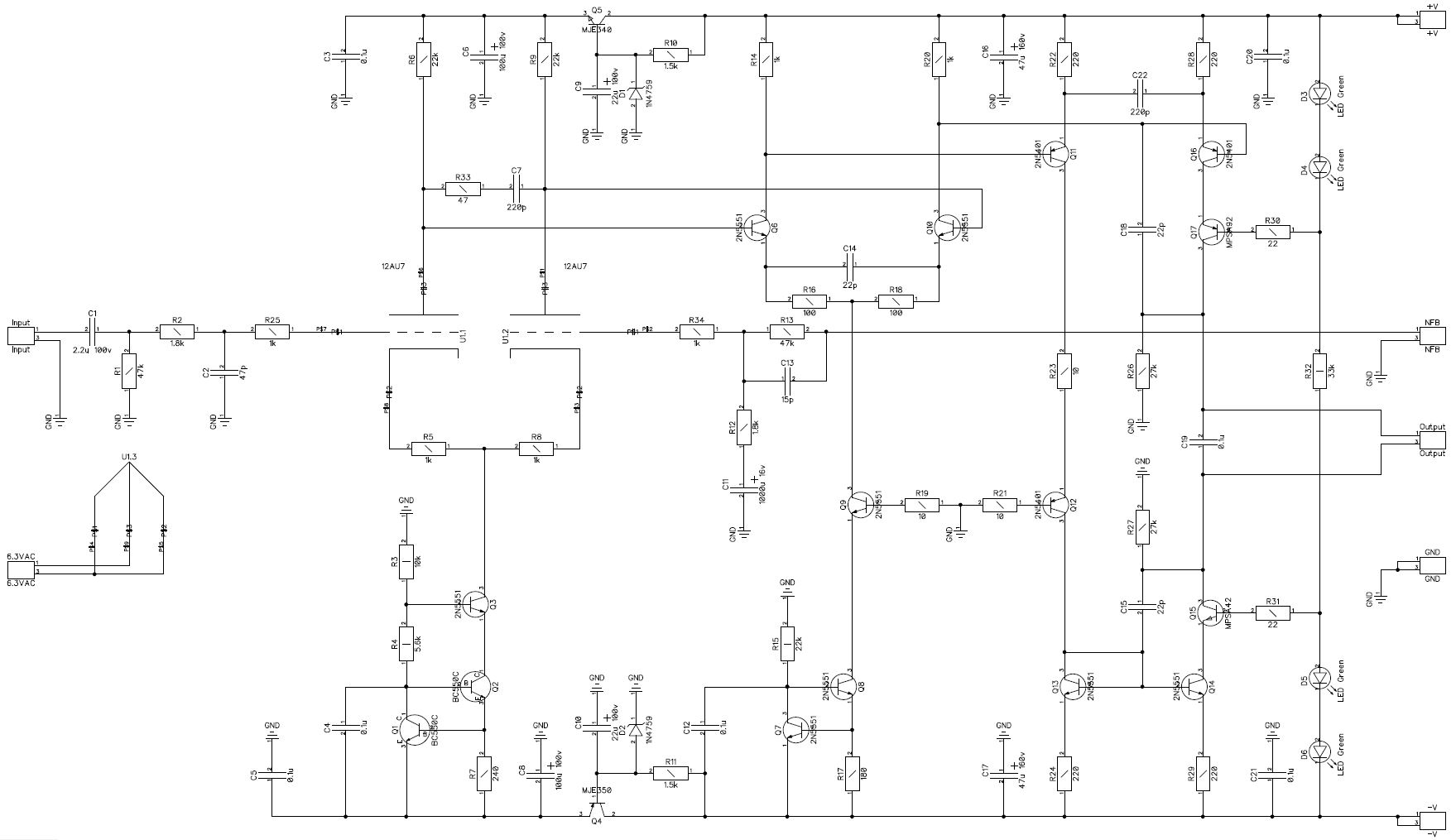

At the same time, if you're up to couple of experiments - not dangerous and "non-invasive" for the boards, here are two options to test:
1) No NFB for OPS (Picture 1). Put two 2.2k resistors, right underneath the board, as shown on the picture. Don't connect NFB plug to OPS.
With no NFB, OPS will not influence stability, so the whole thing should work the same way as there's no OPS connected. Don't forget to re-bias the OP.
THD will increase, though it will still be within 0.05% if biased properly (80-90 mA per output pair).

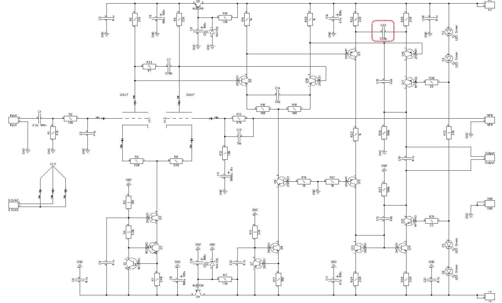

2) Nested NFB (Picture 2). Change R13 to 100k and arrange another 100k with two 2.2k resistors as shown on the picture. Connect NFB wire to OPS as usual.
This option covers OPS with very light NFB (around 6 db), giving better THD than the previous one, while not jeopardizing stability (at least it should not).
I am running the 2-nd option on my test bench at the moment - no audible difference with the original design.
This may be used as an interim solution until I find the cause of an issue.

Ufff... Terry, sorry about the shorted outputs 🙁
Meanwhile, I did some additional research and simulation. Adding 220 pF cap between Q11, Q16 emitters (set on top of R22, R28 pins) increases phase margin further on. With my OPS it's rock stable, reproducing perfect sine and square waves and sounding delicious.
I attach the final schematic for reference.

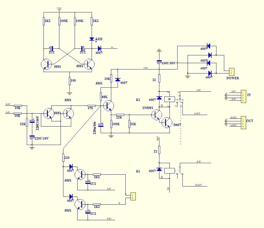

In this schematic, RC combination is responsible for setting the right time constant and though speaker-on delay (68K resistor and 220uF capacitor - within the red box).
Brief calculation shows that 220K and 1000uF will give you some 20-30 seconds delay. Please test practically for exact values.
Valery

3VDC to trip the protection is acceptable, 7.5VDC looks pretty high to me, however I think this is a peculiarity of DC "sensor" used in this circuit (2 transistors at the very left of the schematic) - it is less sensitive for negative offset than to the positive one. Not sure we can do something about it without significant changes...

Initially, I was hoping to use the DC protection alone but if it kicks in at 7V I will see a pretty good thump. Better to use the 24 second delay so it will be close to 0V before it connects the speakers.
So far, all of the Slewmaster IPS/OPS combinations I have tried only go to about 2v offset if one fuse blows. Hopefully this one will be the same once we get the other issues sorted out.
BTW, the schematic I posted has a typo. It shows 100K on the L in but they are both 10k. It should look like the one attached here.

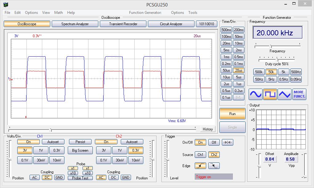

Tested with SlewMonster

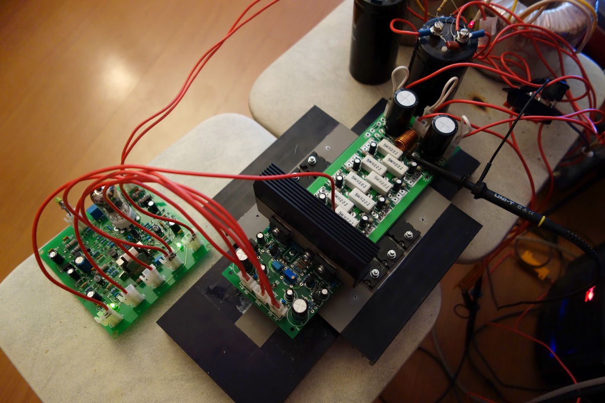

OK. Finished soldering SlewMonster. Got 3 output pairs so far - more transistors to come in a couple of weeks.
Connected everything, switched on, set the bias, and... no problem 😕
No stability issues. 20KHz square wave response is perfect, no sign of ringing. Excellent sound - same great bass, natural mids, airy highs...
SlewMonster is a great power section - it does not actually influence neither frequency, nor phase response, at least within 1MHz (as far as I can see on my analyzer). I use 33 pF caps at pre-drivers and do not use optional 68 pF caps at the drivers.
Terry, let's think what can be different in your setup. Power supply? Wiring? Tubes? Are you sure you connect PD+ and ND- wires correctly? I mean, at my front-end they are "mirrored" relatively to SlewMonster - PD+, being "at the top" on front-end PCB, is placed "at the bottom" on SlewMonster. Another thought - grounding. I have G1 and G2 directly connected with a wire at my prototype. Is it the same at yours?

Yes, puzzling for me as well! I will look closer at the readings...
Maybe you could mark up a schematic with VR and VBE readings so I could have something to compare to. I had hoped that maybe I had the PD, VD reversed. You used all red wires and it is too hard to try to follow them but I just got home and rechecked and the PD is definitely closest to the V+ and ND is closet to the V- so I had it hooked up correctly. Weird thing is that it works fine if I tie the NFB from the IPS to it'self but when I try and tie the NFB from the OPS it looses it. I'm doing that again until I can be certain that the IPS is running where it is supposed to. I'll need those readings from you to do that.
