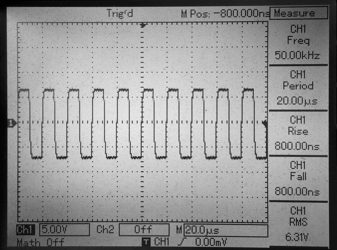

I got home today so I implemented the changes you suggested. As before, the IPS seems fine on its own. Plays squared wave and is clean. I then hooked up the OPS through a light bulb tester. The light bulb shines brightly so I began measuring. The light bulb will only allow the rails to come up to +20,-17V. NFB is -14.7. ND- is -15.2 PD+ is -16V. The vbe bias adjustment doesn't work at all with this IPS attached. Voltage across a pair of the .22R output emitter resistors measures 80mv and not matter how I adjust the pot is just stays there. This OPS works fine with all the other Ostripper IPS units. If I get a chance I will build one more using your the latest schematic and see if I can get that to work.

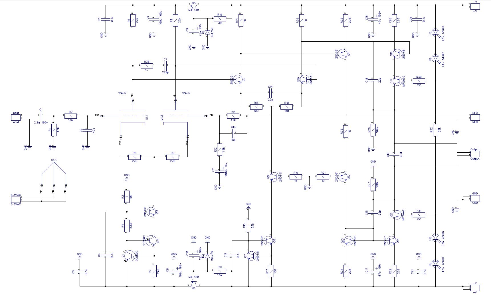

Terry, there is one more option to try. A bit over-compensated, but absolutely stable in my environment. No C15, C18 = 150pF, C14 = 47pF (schematic from post #182).

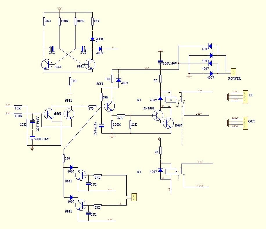

On another note. The speaker protection circuit I use is attached. Which caps do I change to delay the switch on further?
Thanks, Terry

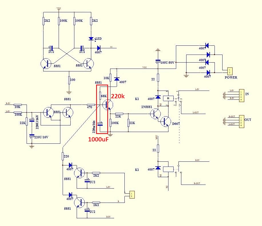

Hi Terry,
In this schematic, RC combination is responsible for setting the right time constant and though speaker-on delay (68K resistor and 220uF capacitor - within the red box).
Brief calculation shows that 220K and 1000uF will give you some 20-30 seconds delay. Please test practically for exact values.
Valery

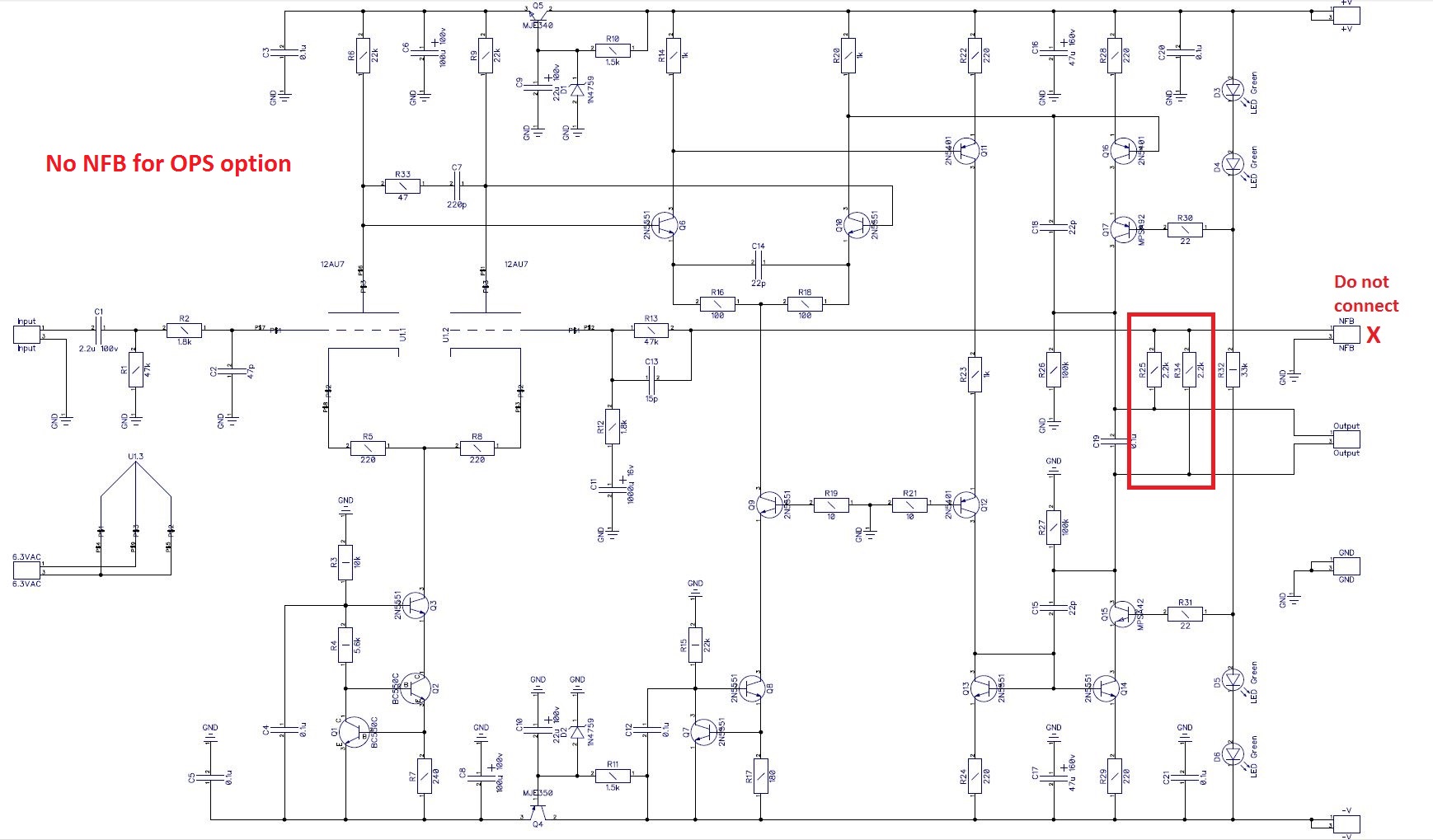

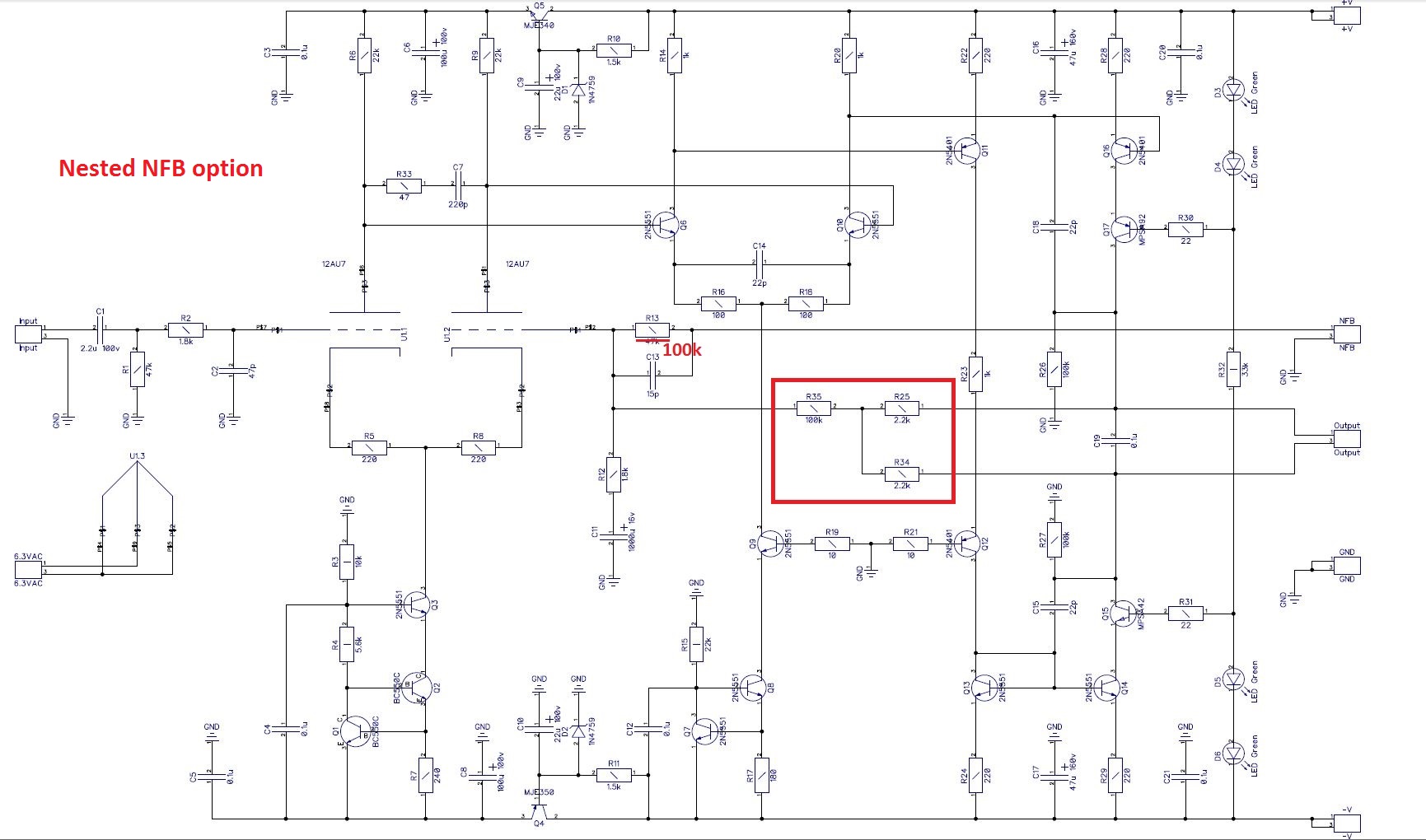

Hi Terry,
With help from Jason, I am ordering the Slewmonster PCBs, so hope to look at the issue closer pretty soon.
At the same time, if you're up to couple of experiments - not dangerous and "non-invasive" for the boards, here are two options to test:
1) No NFB for OPS (Picture 1). Put two 2.2k resistors, right underneath the board, as shown on the picture. Don't connect NFB plug to OPS.
With no NFB, OPS will not influence stability, so the whole thing should work the same way as there's no OPS connected. Don't forget to re-bias the OP.
THD will increase, though it will still be within 0.05% if biased properly (80-90 mA per output pair).
IF 1-st OPTION WORKS FINE, YOU CAN PROCEED TO THE SECOND ONE.
2) Nested NFB (Picture 2). Change R13 to 100k and arrange another 100k with two 2.2k resistors as shown on the picture. Connect NFB wire to OPS as usual.
This option covers OPS with very light NFB (around 6 db), giving better THD than the previous one, while not jeopardizing stability (at least it should not).
I am running the 2-nd option on my test bench at the moment - no audible difference with the original design.
This may be used as an interim solution until I find the cause of an issue.

How much voltage does this output?
Highly linear up to 120V peak-to-peak (42.5V RMS).
Clips nicely at 126V peak-to-peak (44.5V RMS). No saturation or artifacts.
- Low TIM, low distortion hybrid front-end
