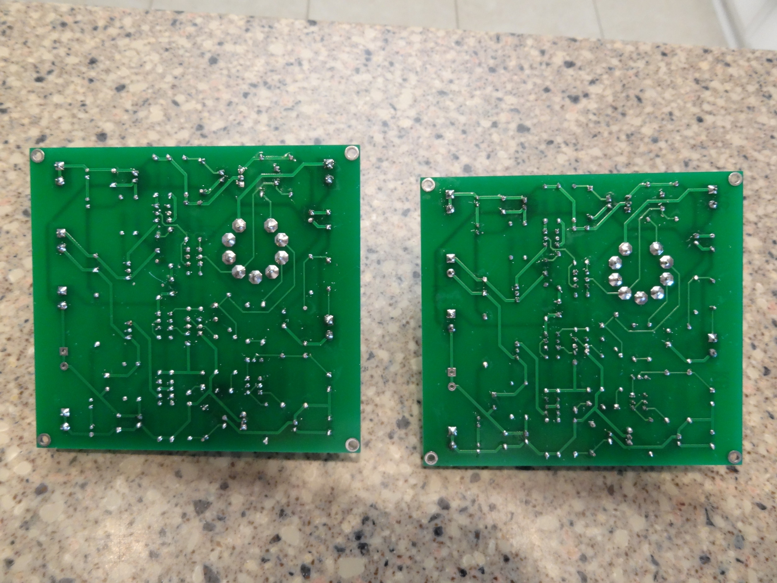

My boards came today. I've got them filled up but my 6.3V transformer hasn't arrived so all I can do is post some pics and wait.
Blessings, Terry
Blessings, Terry

Terry, they look beautiful! Looking forward to see them glowing 😉
I would recommend to test them first without the power section, just to make sure everything is fine (I'm sure it's fine, but you know - some extra care...). For that purpose you will need to connect PD+, ND- and NFB pins together in order to make the VAS cascodes and NFB working properly without the power section.
In this configuration you can check the DC offset at the output, see the waves being amplified and make sure there's no oscillation (as usual).
You can also test the power-on sequence options behavior and timing, watching the output with DC-coupled oscilloscope, set in a way that you can see the full range (from "+" rail at the top to "-" rail at the bottom).

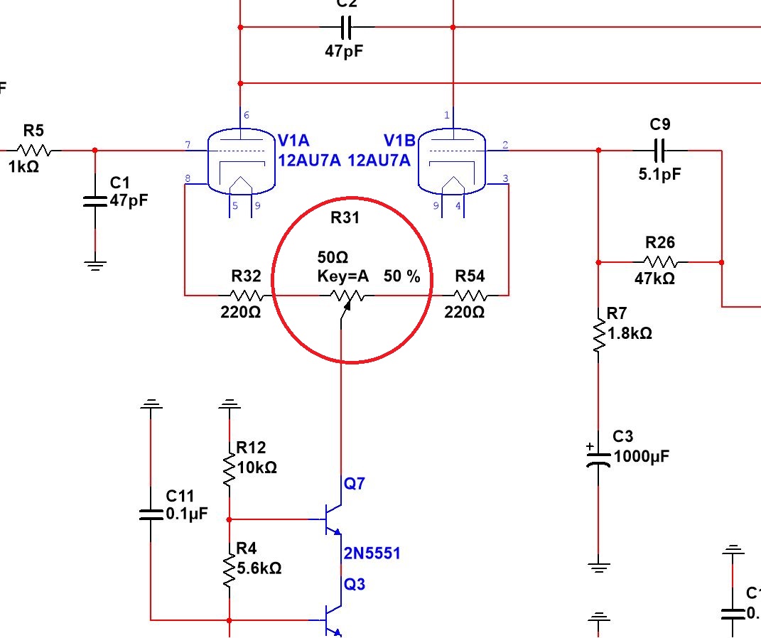

Regarding the DC offset - it is set automatically, assuming the triodes are matched enough within the tube. I have simply selected the tubes with very close parameters for the triodes. In the worst case, it is possible to put a 50 ohm pot between R5 and R8 - see attached picture - it allows adjusting the offset in the range +/- 2V - and then simply measure it and exchange it with 2 normal resistors. Sorry I did not reserve some space for it - just really hoped it would not be required (and in my case it's not).

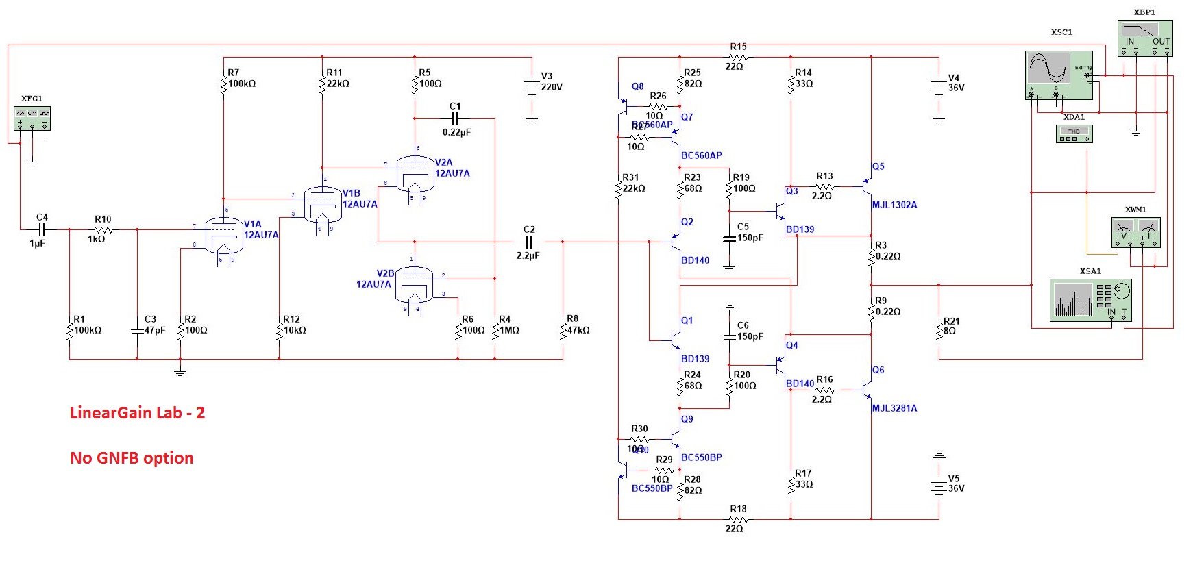

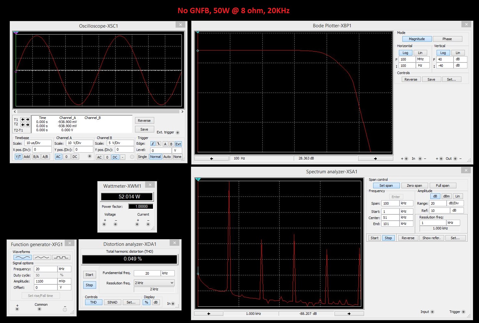

"Hybrid madness" continues 😉
OK, here is what I came up with so far (next hybrid) - created the new thread - see it HERE. Ideas are welcome. We have to prototype this one - it's going to be a lot of fun - "tubish" sound with low distortion :cheers:
By the way, we can easily control distortion there - no problem to increase it, just add up to your taste 😀
Output buffer is designed by Damir - I just utilize it here as one of the best ones for the purpose.
Valery

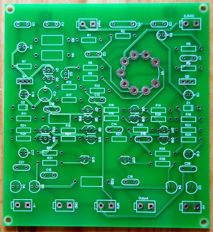

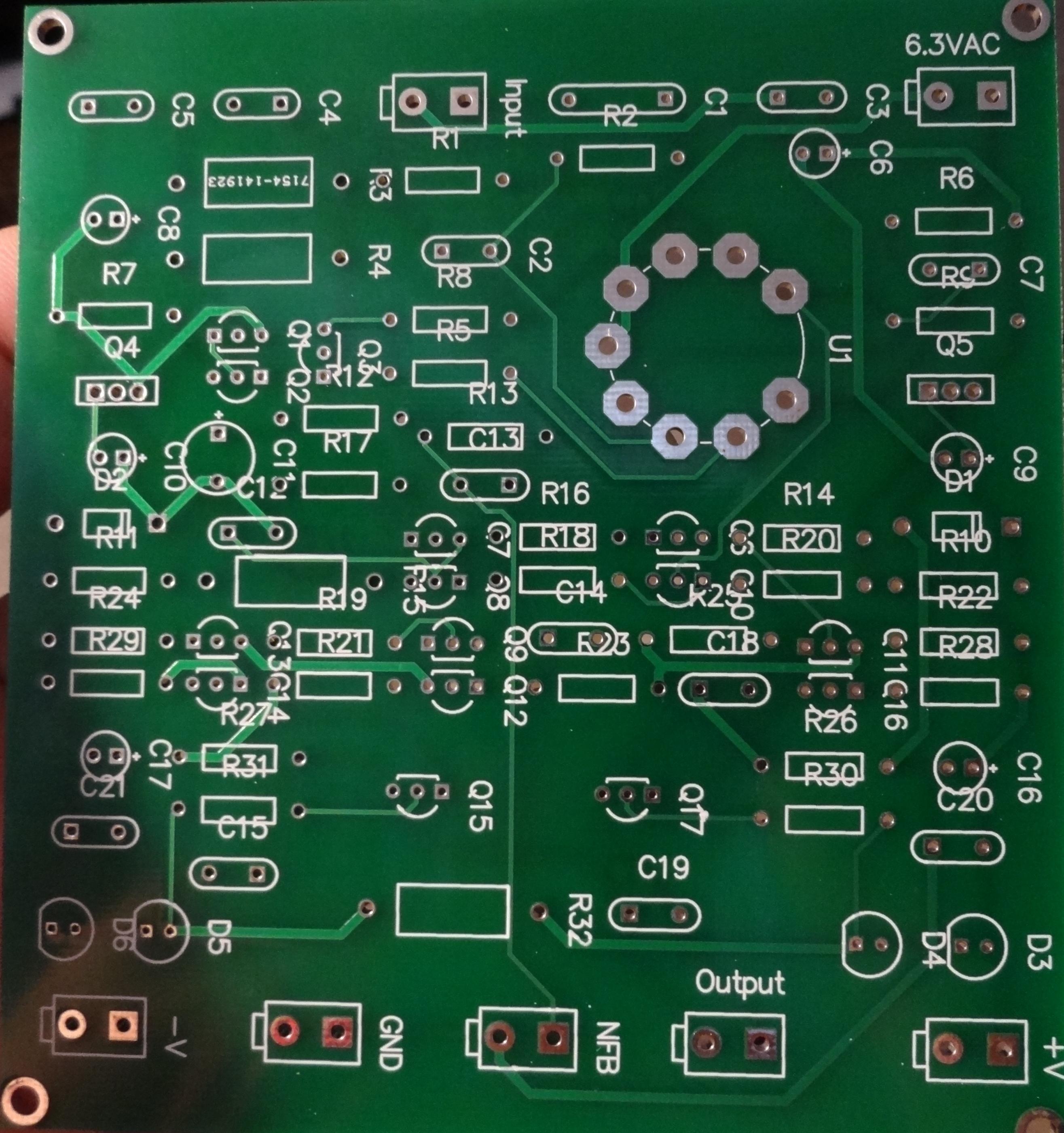

Hi Valery,
Which files did you use to have your boards made? I sent the ASCII file and the silkscreen is pretty badly offset. It works but it makes it a little more difficult to locate the parts. I am attaching a pic of the boards.

Hi Terry,
I used exactly the P-CAD ASCII file, attached to post #35.
From what I see on your photo, there is some mismatch in silk-screen font (the one pcb manufacturer used for printing the silk-screen) - on your PCB characters are somewhat bigger than expected.
See my PCB attached.
By the way, it is possible to download a free P-CAD viewer HERE - it shows PCB layout from P-CAD ASCII format.
Valery

I have known of an issue just like this and in my case it is not produced at the board house. The issue is in a mismatch between what you see on the screen in Eagle edit mode and the creation of the Gerber files (the master images used to manufacture the boards). You should create the Gerber files yourself, then view them carefully with a suitable viewer before you submit them to the board house. The Gerber files will be faithfully reproduced. If you leave the board house to create your Gerber files you can get all sorts of issues. The default in Eagle is to use variable width fonts and these often don't convert well when making Gerbers - at least that is what I have found. So I used fixed width (they are a bit boring!) fonts and then I check the Gerbers - in many cases I still have to adjust the position of text as there is sometimes an offset between what you see in Eagle edit and what shows up on the Gerbers. Check and double check your Gerber files and you'll be fine.
When I first sent the files in to get a quote, I sent both Gerbers and ASCII files for the Low TIM and Valery's Class A. When they sent the quote back they did it based on the ASCII files so when I got ready to order the boards, that is what I sent. I was able to look at the gerbers and they looked right but I couldn't look at the ASCII files. This board house has always sent nice boards before. Now, using the viewer that Valery linked, the screenprint looks fine so I wonder why the board house screen shot looks like what they made.
