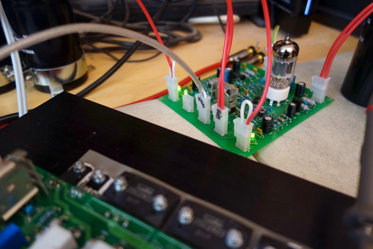

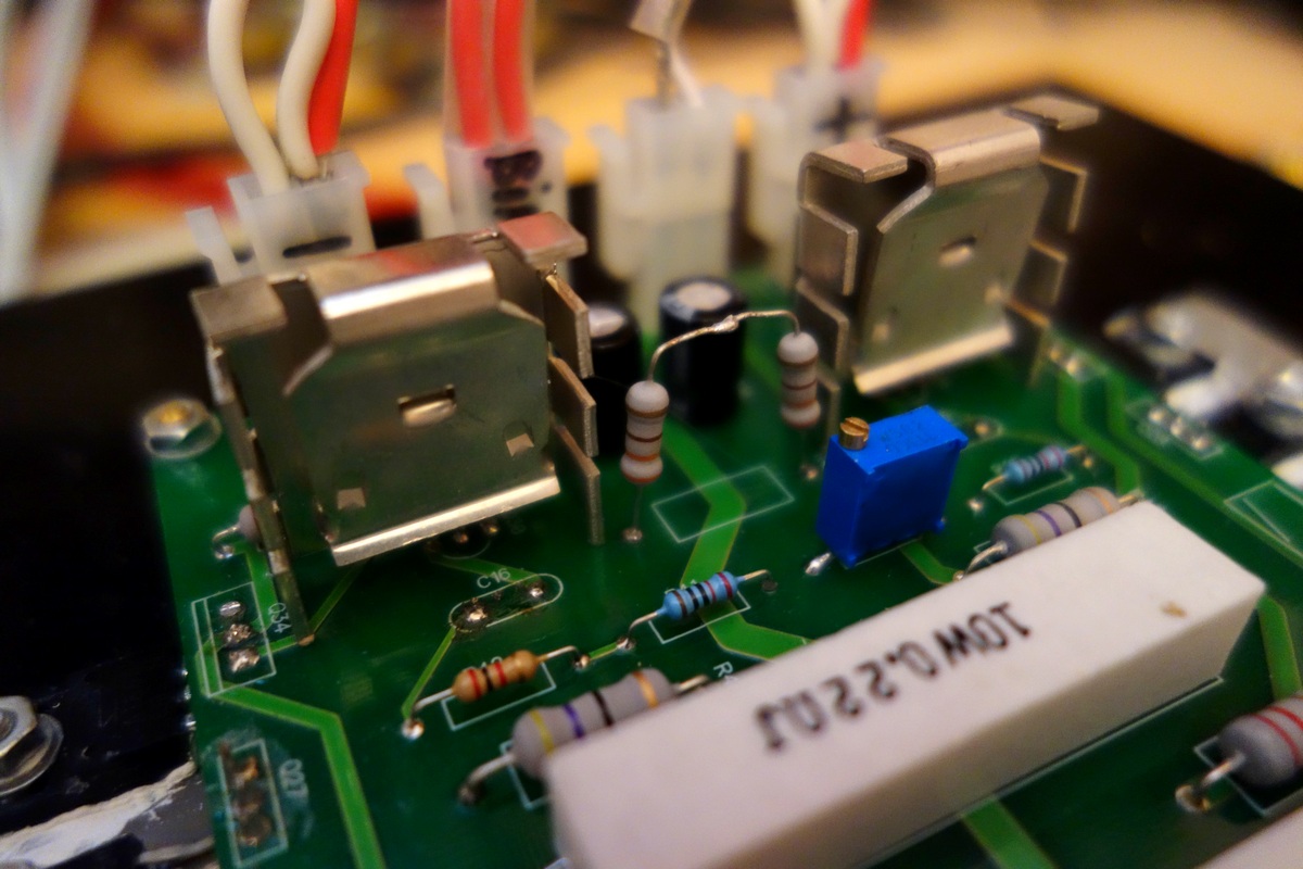

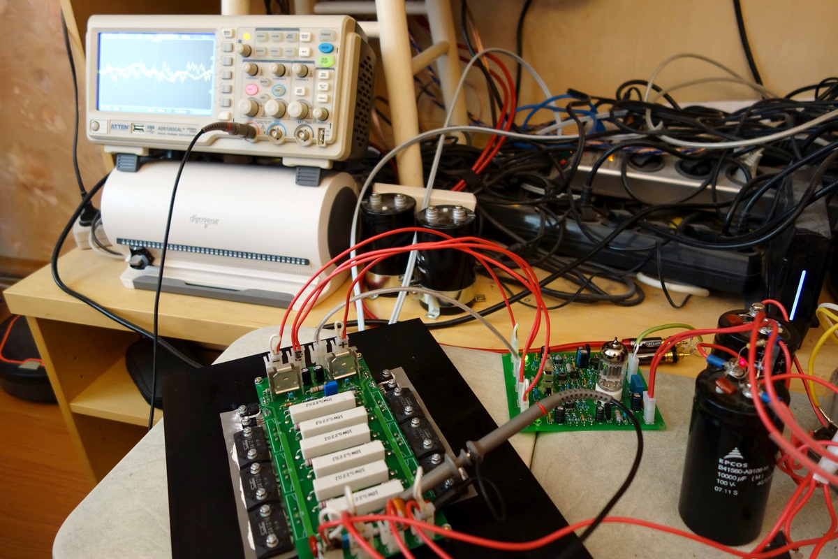

I have finally assembled a simple EF3 power section and auditioned the whole thing. I don't want to be immodest 🙂rolleyes🙂, but it's fantastic.
No doubt, my neighbors had some hard time today 😀 Overall impression - highest clarity and resolution over the whole audio frequency range regardless of the output level even at "difficult" material. Lots of micro-dynamic nuances. Something I did not expect to be special here - accurate, solid, powerful bass. Maybe it's not so much related to its hybrid nature - most likely the reasons are powerful PSU and three Sanken pairs in OPS - I don't know, but that's what it is. Everybody noticed it from the first minutes of listening.
Big Phat Band, Grover Washington (Winelight), Ray Brown Trio (Soular Energy), Bassface Swing Trio (Tribute to Cole Porter), SPL (Surrounded by drums) - all sounded perfectly. In overall, it's comparable with my class-A amp with one advantage - bass is simply the best.
This test confirmed we don't need any regulated DC for the tube heating - the amp is dead quiet with no signal in existing configuration (6.3V AC heating).
Looking forward to see more impressions from the ones who builds it.

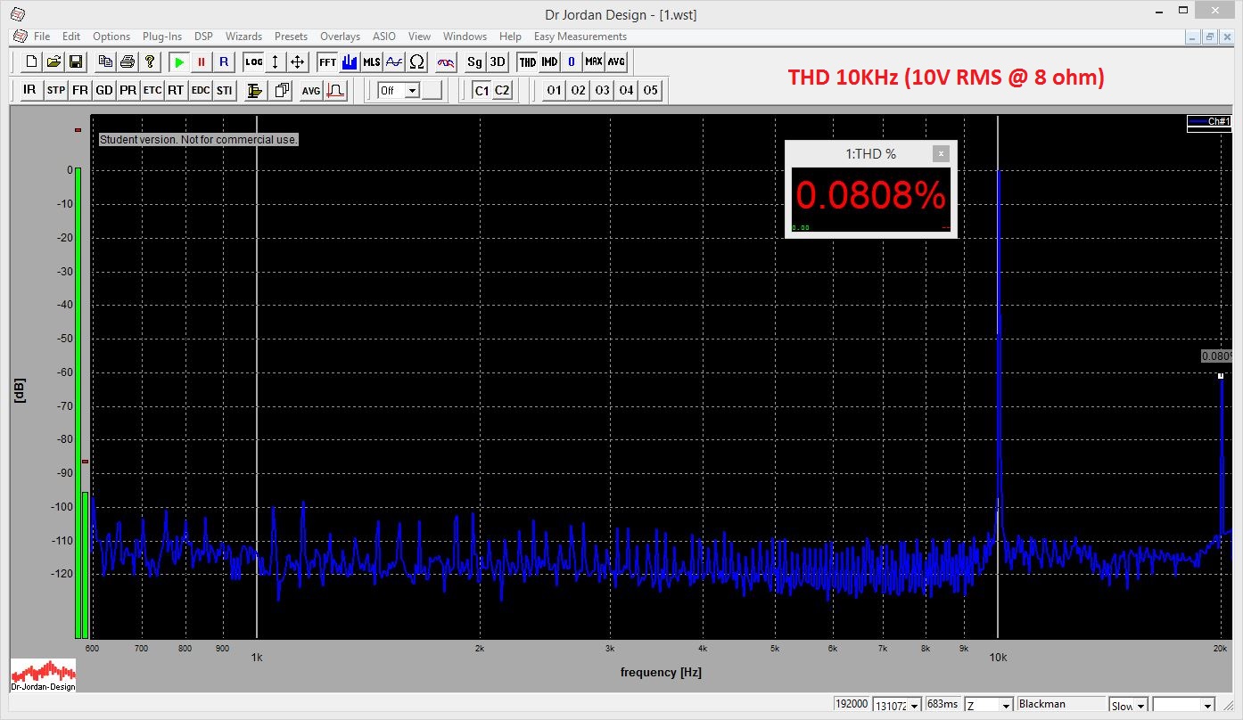

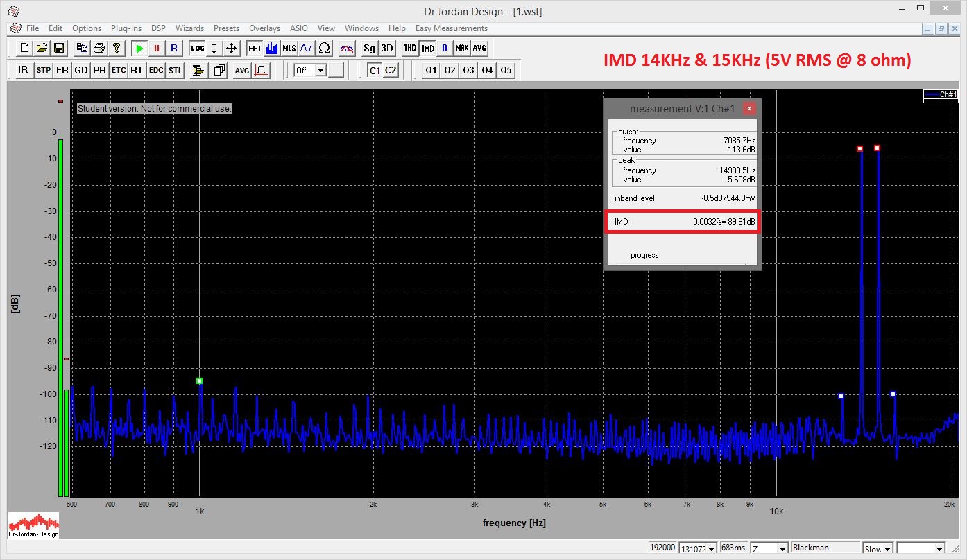

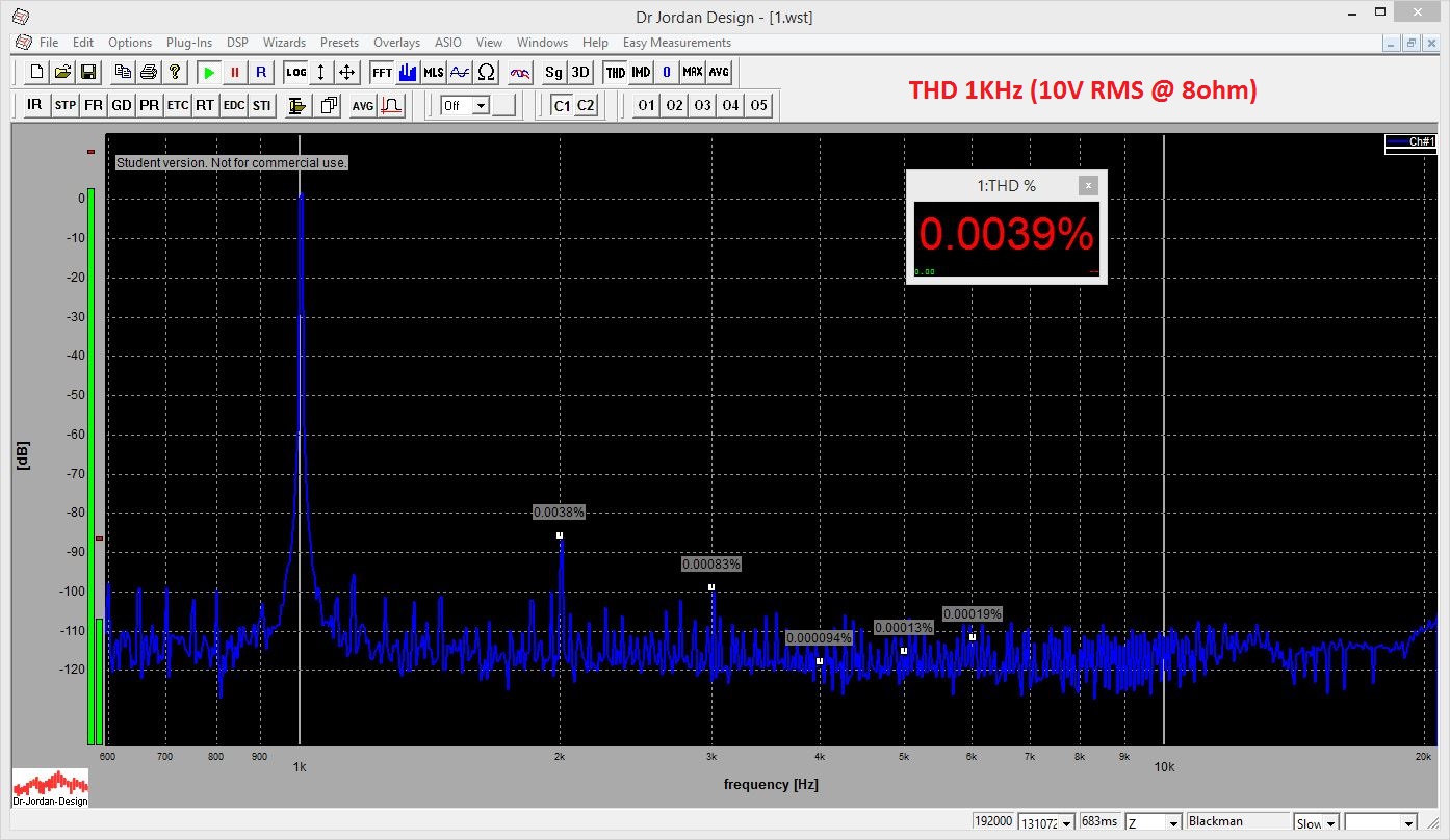

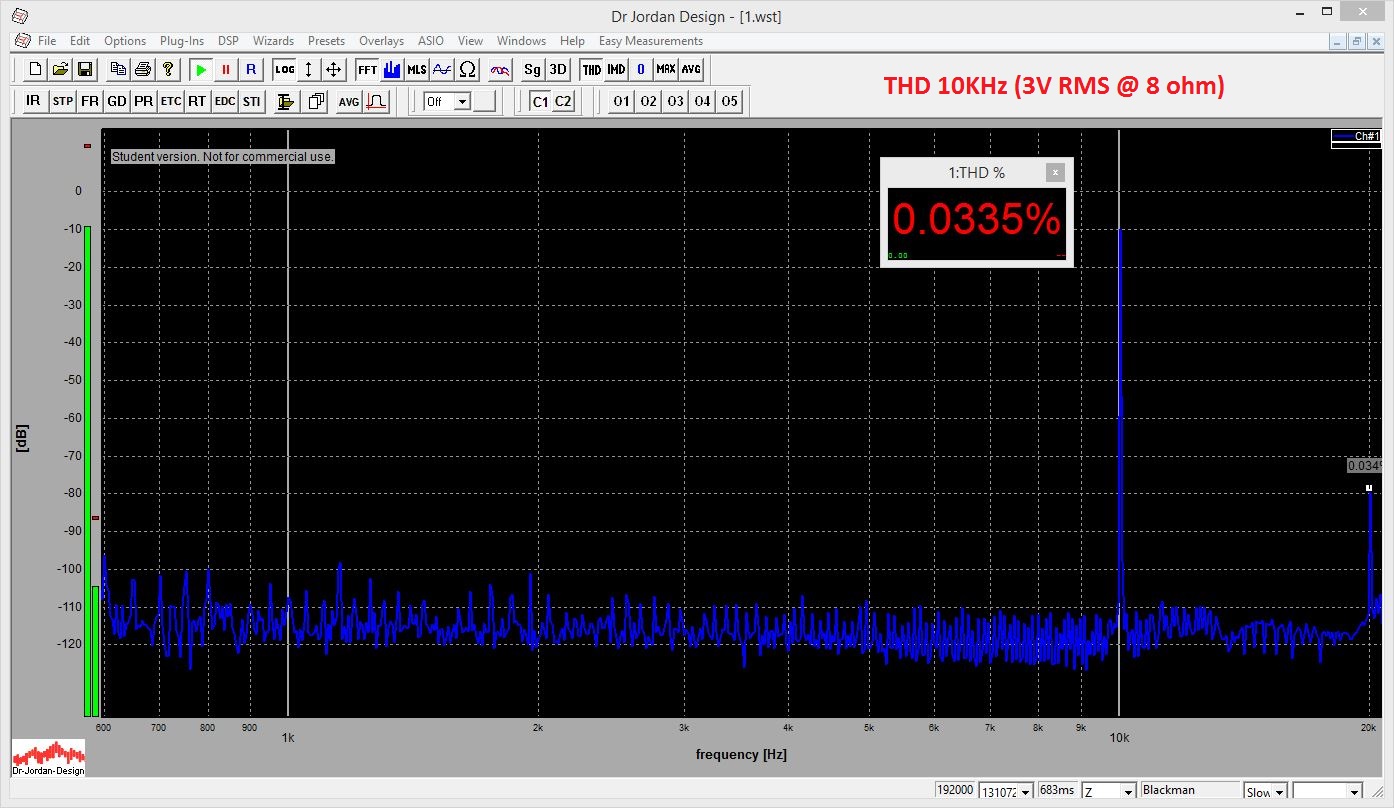

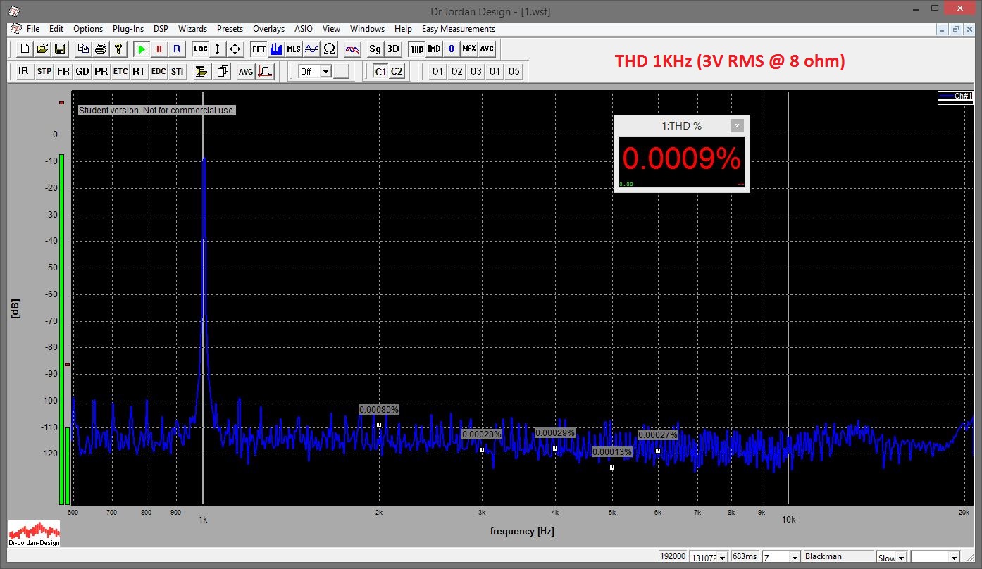

I also attach couple of pictures and some measurements in combination with OPS. Strong dominance of the 2-nd harmonic. 3-rd one is much lower (10-12db), all the rest practically don't exist.
I like it.

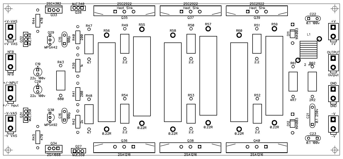

I've got some requests on OPS gerbers.
Here they are along with the parts placement illustration and schematic.
Please note - in the final build I don't use the pre-driver shunt caps. Use them only if necessary.

Hi Bimo, well noticed - actually, in the final prototype I use 660 ohm (680 ohm will be fine) here. I also use small local heatsinks on pre-drivers - they increase overall thermal stability dramatically, including OPS quiescent current stability. This way MPSA42/MPSA92 feel good 🙂
