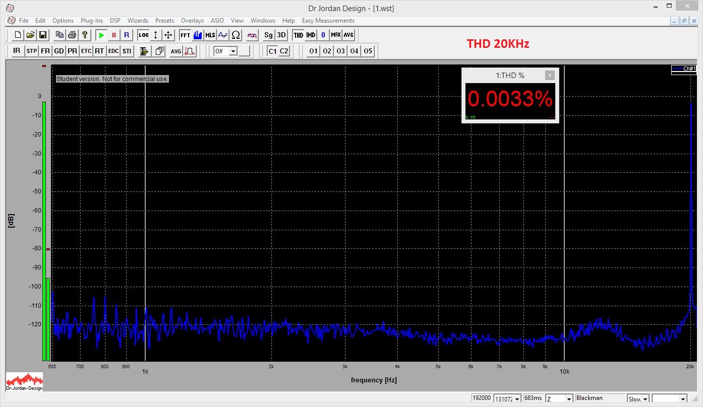

Prototyped and tested!

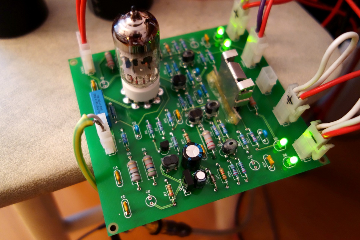

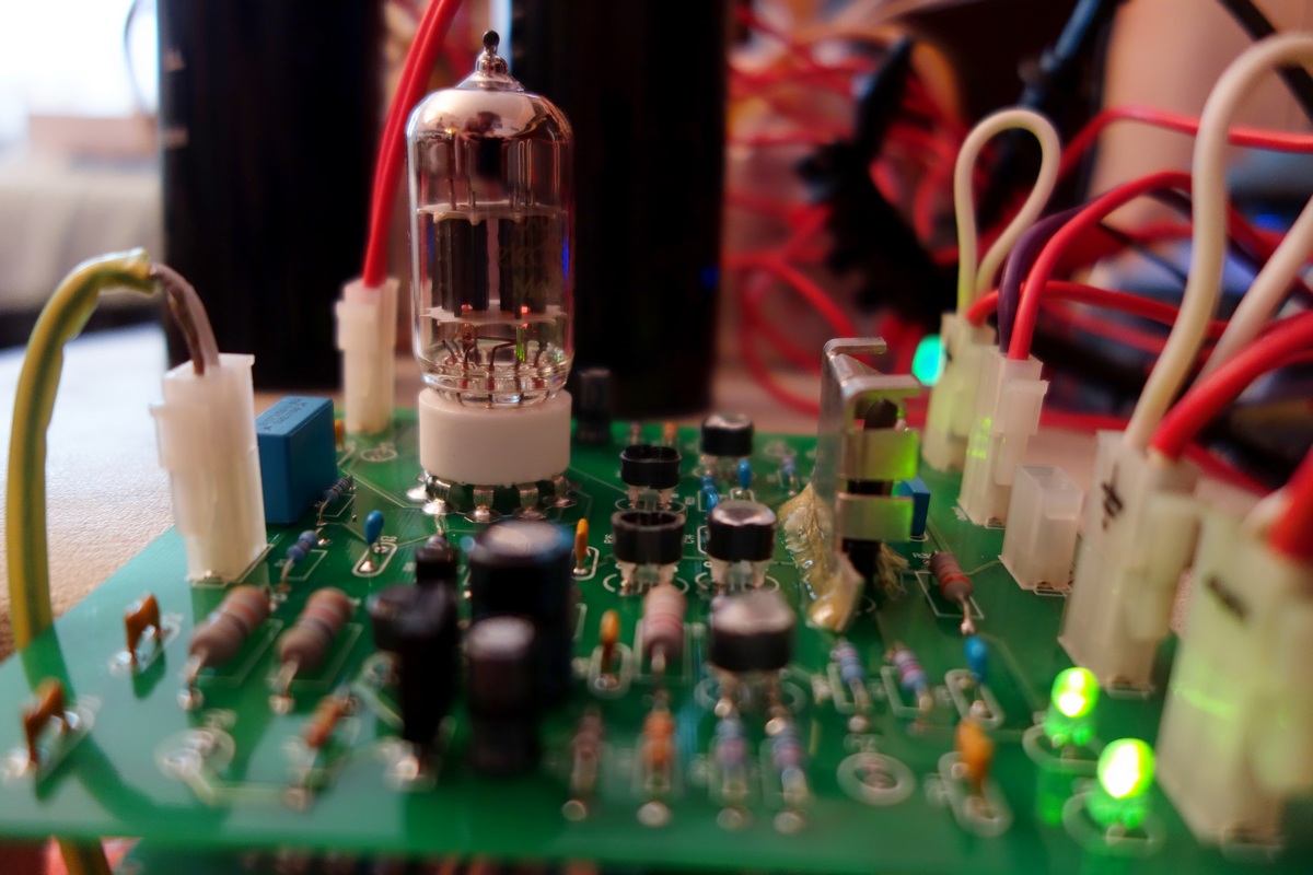

Hi All, here we go.

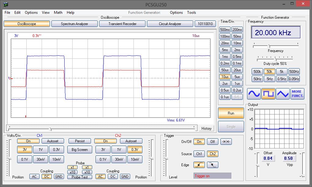

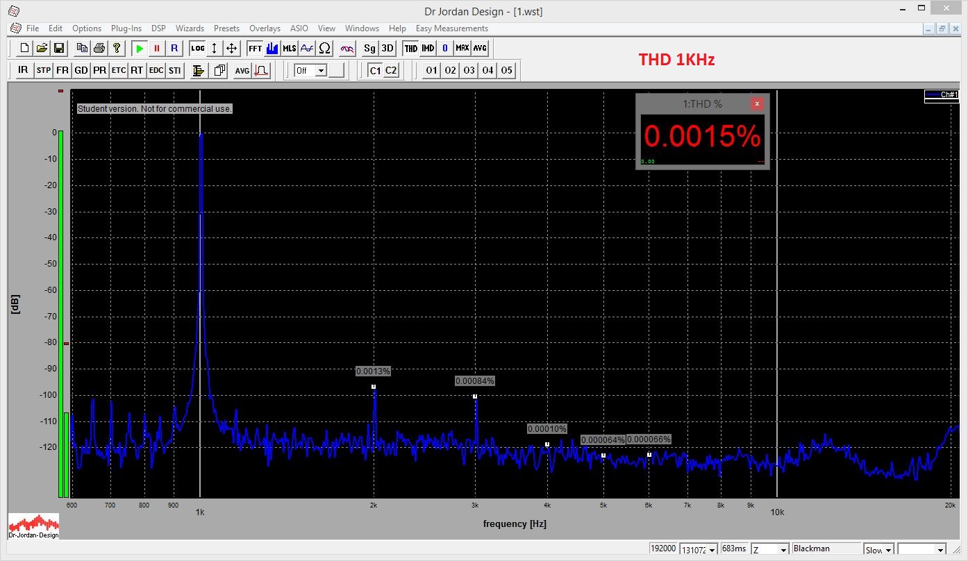

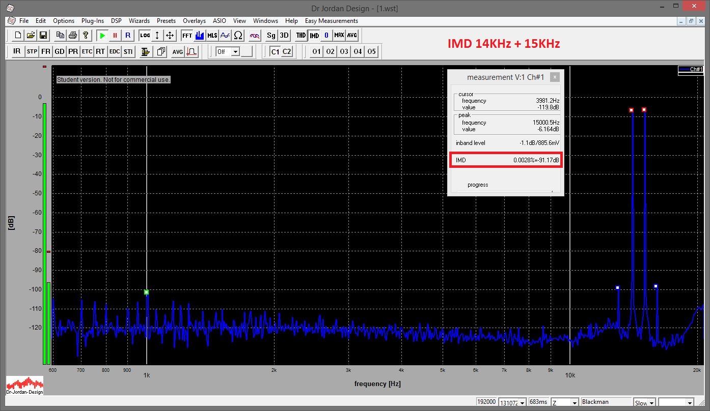

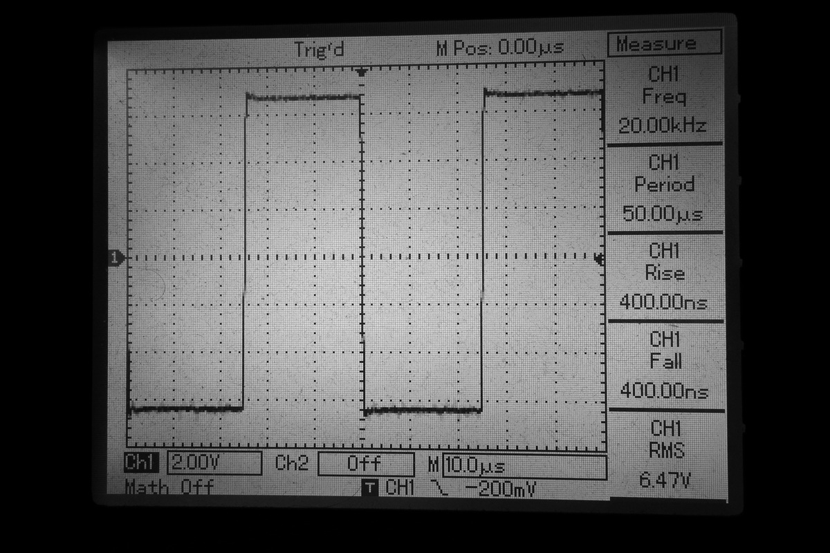

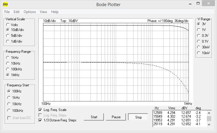

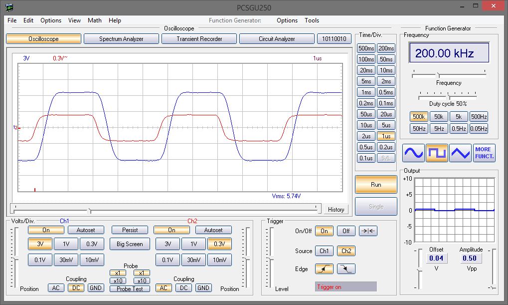

Soldered and measured. Minimal fine-tuning - R2, R6, R7, R9 are adjusted - see attached schematic.
It confirmed its pretty high-end performance. Low noise, low THD, low IMD, high slew rate (400nS rise/fall time), good phase response. Bandwidth with all the compensation and input filter is around 300kHz.
I've tried 2 tubes. First one had pretty high tolerance between the triodes - DC offset at the output was around 180mV. The second tube is matched much better, so offset slowly fluctuates around zero, +/-10mV maximum.
In a worst case it is possible to put a trim pot (470 ohm) instead of R5, R8 degeneration resistors, connecting its central pin to collector of Q3 - it will allow adjusting the offset.
I had no chance to assess the sonic performance yet - need some more time for preparation. However - Terry, Thimios, Ranchu32, jerluwoo and everybody else who is going to build it - you can go ahead and order the PCBs.
Regarding the start-up behavior - the tube warms-up in about 10 seconds. So, you've got 2 options:
1) Setup the soft-start circuit in a way that it gives the power to the heater right away, in 10-12 seconds it powers-up all the rest of an amplifier and after another 2-3 seconds it connects the speakers;
2) Power goes everywhere at the same time, just connect the speakers in about 12-15 seconds.
First option is more "friendly" for the circuit.
I use a small heatsink for Q15, Q17 - even at 4.5 mA they get warm, so heatsink is recommended for better stability.
Questions, suggestions are welcome.
Looking forward to hearing it 😉
Valery
P.S. - I have an idea to try powering the heater with 6V DC (regulated) - it may potentially decrease the risk of influencing the input (though it seems to be unnoticeable even as is, with AC power).
Hi All, here we go.
