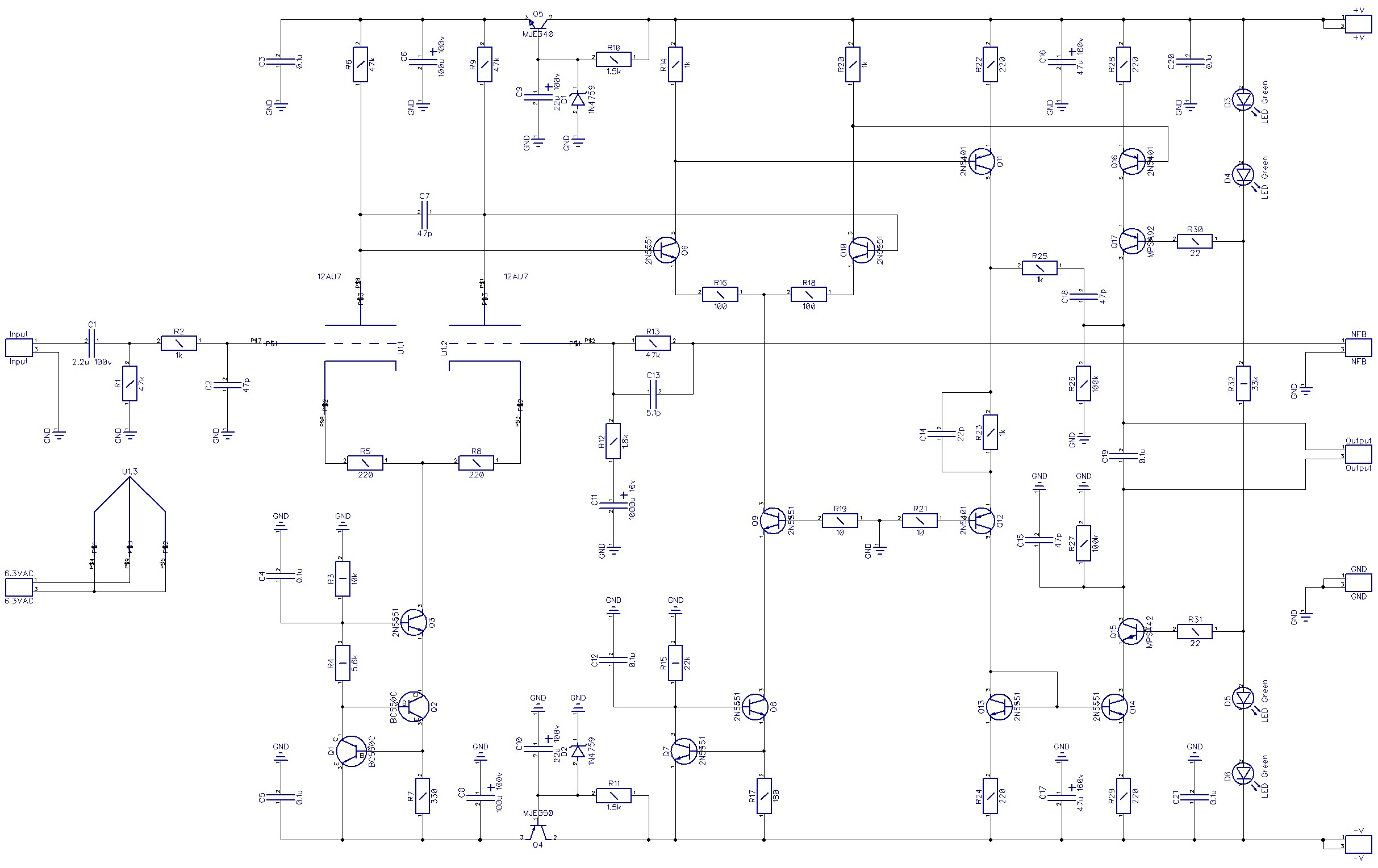

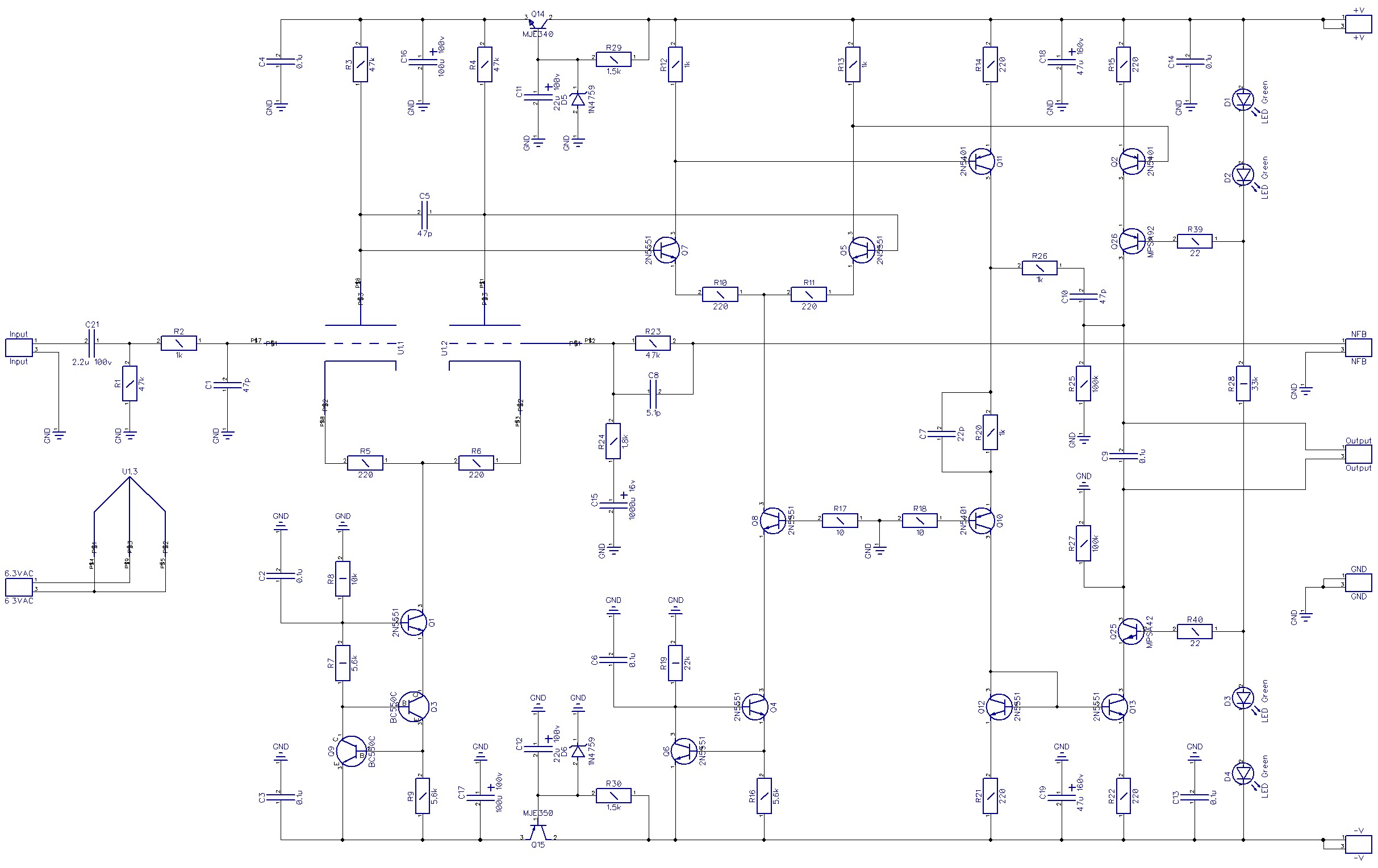

- Right, it would be not so good having less than 60V for the valves (actual anode voltage is even less than that)
- 300V is the maximum value, we are far below
- You're right, filtering caps are not shown for modeling purposes (they increase initial setting-up significantly) - I will add them to the final schematic
So we need 70V+ rails for the front end to supply the valves (more would be better?).
Would it be possible to couple this front-end to an output stage with only one or two pairs of BJT or MOSFET outputs?
In theory, it is possible to arrange a separate (higher) power supply for the tubes and then arrange a level shift for coupling with the next stage, but it would be too complicated and somewhat pointless - the way I did it is rather simple and effective.
I set relatively low quiescent current for VAS (5.6mA), assuming rather high input impedance of the power section (with 3EF ~ 100 Kohm or so).
Significantly lower impedance will increase the level of distortion. So, in general, 2EF-BJT or MOSFET output stage is possible, but it will require certain increase of the VAS quiescent current to some 9-10mA, increasing heat dissipation requirements for the cascode (Q14, Q15 in post #9). I would use something more powerful there instead of MPSA42/92 in this case - for example KSA1381/3503. More powerful WAS will also help to drive MOSFETs with their high input capacitance.
It is possible to simulate the design you are up to and come up with optimal regime for each stage...
The problem with tubes in LTP is the startup condition.
What is the output voltage when tubes warm up?
You can easily stuck at rails. You need an output relay with delayed turn-on.

the Luxman LV103/105 used the 6cg7 tubes VAS stage, you may want to check it out...

I'm thinking about coupling it to an EF3 output stage with BJT drivers and two pairs of quasi HEXFET outputs. Input impedance to the power section could be very high. Instead of level shifting, it should be possible to add current limiting protections.
In this case it will be fine as is

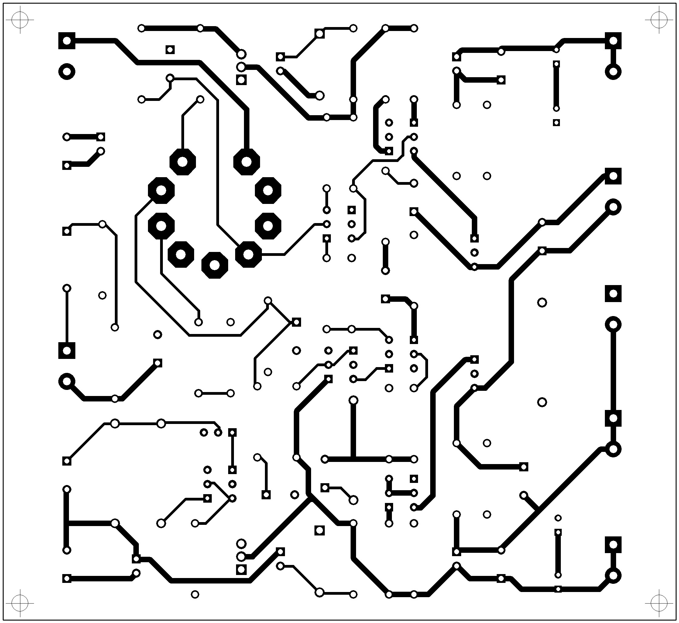

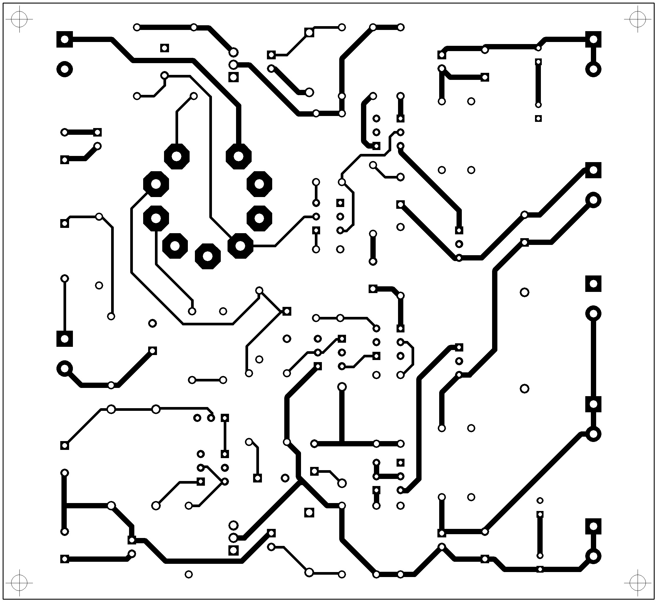

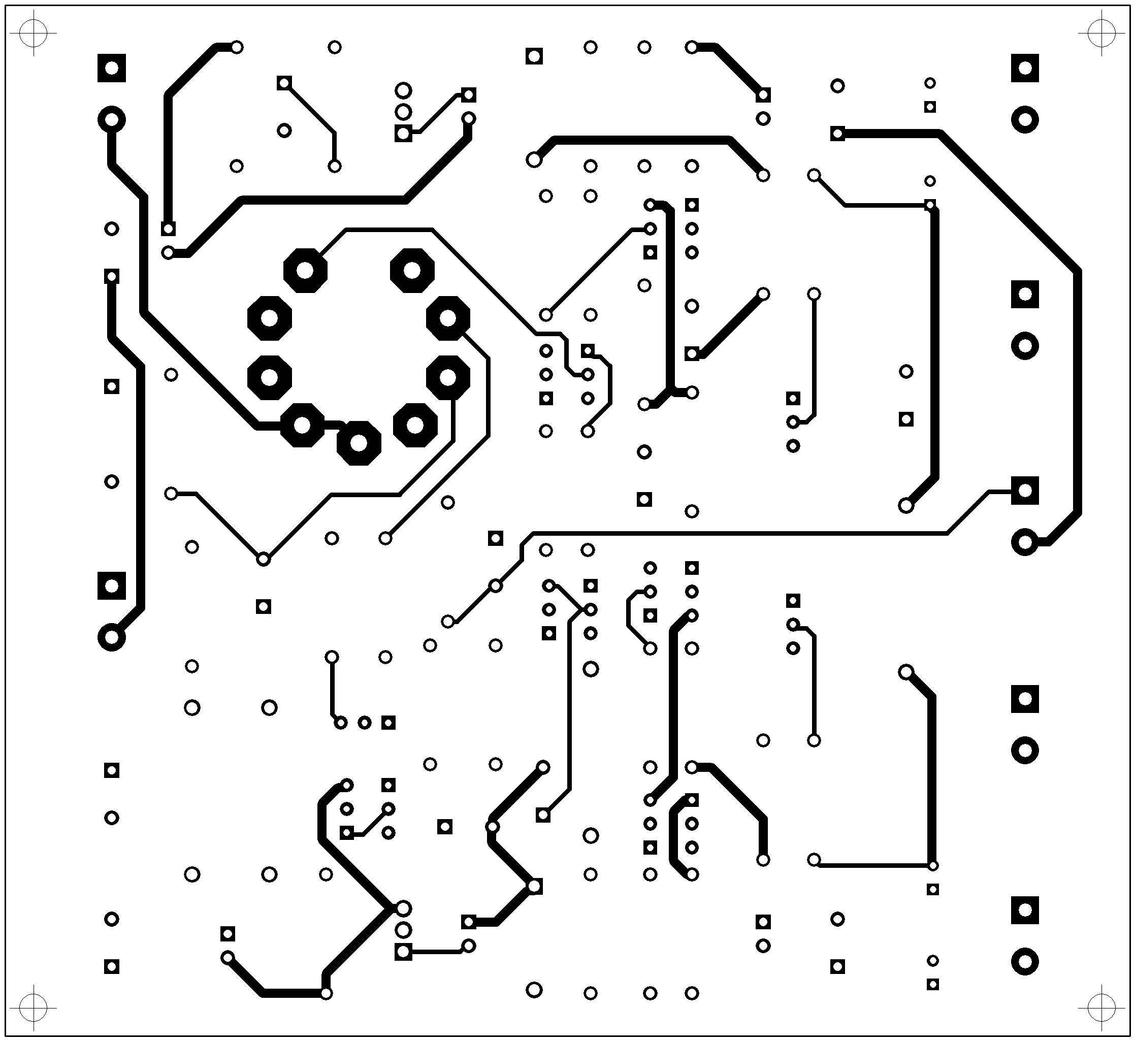

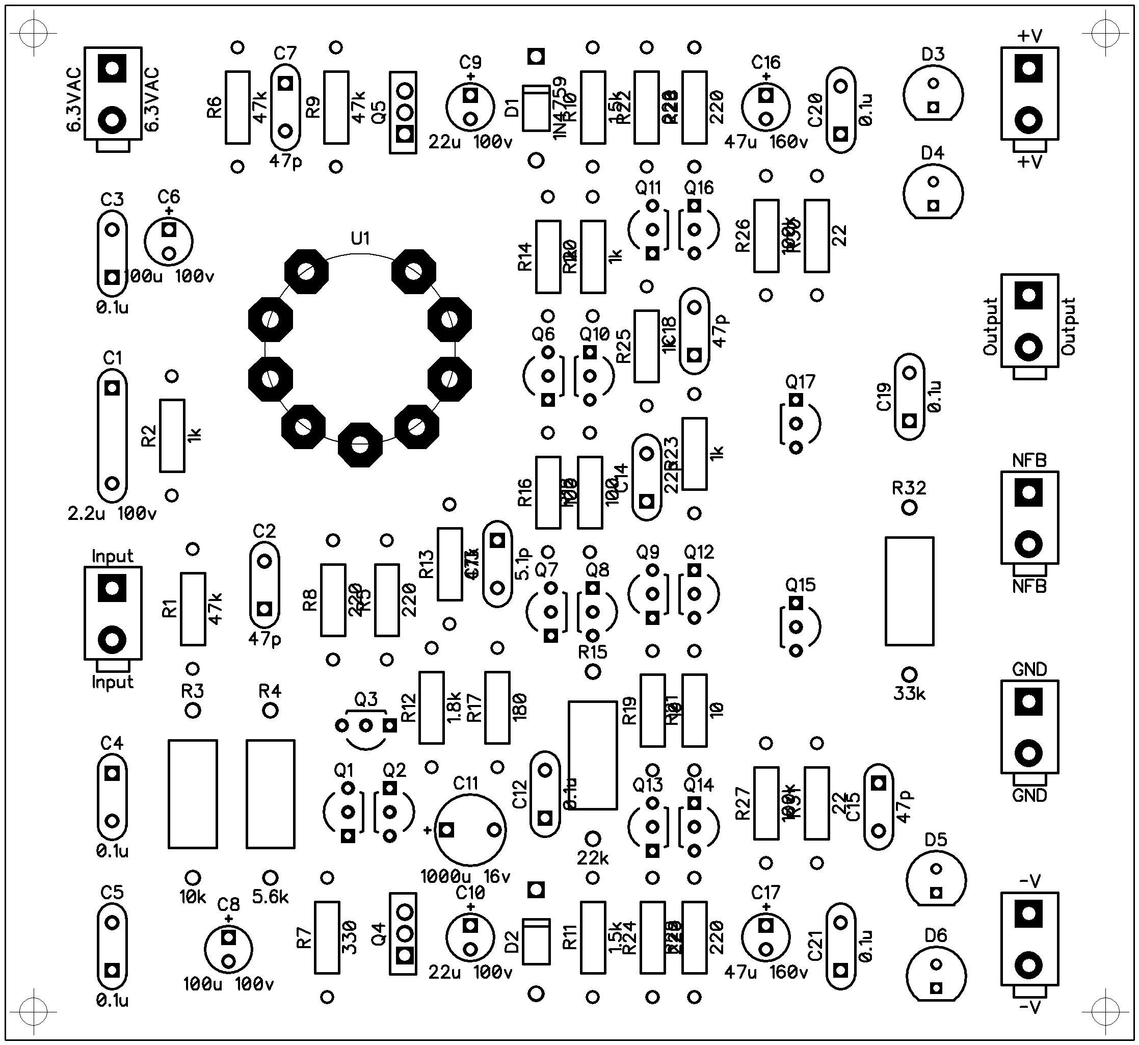

OK, here is some documentation for you 🙂
Terry, as before - please try to check with the factory that they are ok with these gerbers as I never tried to order based on gerber format.
Just in case - the last attachment is a PCAD ASCII - that's the one I always use and this is the one I am 100% sure about. Maybe your manufacturer can use this one - it would be the most reliable option.
If you have questions, suggestions - let me know.
I will also order couple of these locally and build a prototype. Looking forward 😛
Valery
Valery

No one one seems to have mentioned that the output will be latched to the positive rail for the first 6 secs. or so after power up when the tube is not yet conducting. Need to have the heater supply power up about 10 secs. before the main power or something to that effect.
After some more thinking and couple of simulations - it's going to be not that bad. Balanced topology of the stages, following LTP, ensures significant in-phase signals suppression. So even with both anodes disconnected from 47k resistors, it shows -1.5V DC at the output. OK, in this situation GNFB is not working, so, assuming some components' tolerance, it may be higher. However, some current will start flowing through the valves in a few seconds, even before they heat up to normal temperature, so it will start self-balancing almost right away.
Anyway, soft-start delay will solve the problem. Prototype will show the real DC curve at the output and timing parameters 😉

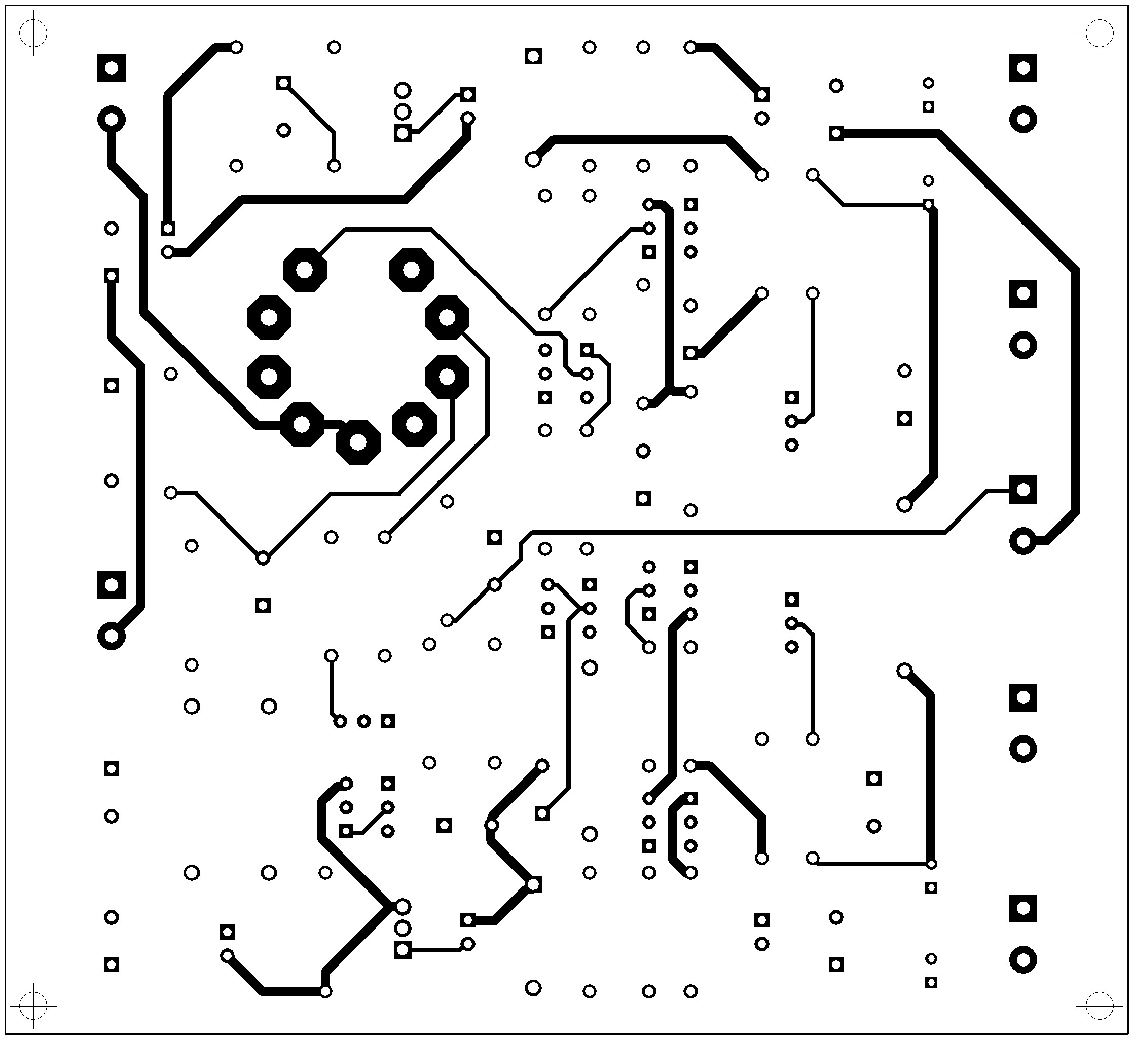

Oops! Please use this package!
Sorry - made some mistakes. Bl**dy copy/paste 🙂 It's pretty late here, so...
4 resistors with wrong values, but most important - one compensation cap missing.
Here is a complete new package.
I have carefully checked everything - now it's fine.
Please use this one. My apologies for possible inconvenience 😉
Valery
Valery

Very nice work, Valery!! Very nice indeed 🙂
Can you let me know the board dimensions and whether 1 oz or 2 oz plating is necessary?
The 47uF rail filters are rated 160V on the BOM. Is this intentional or would 100V electros suffice for 70V rails. Similarly for the input cap you have it rated at a high voltage. Would a nice quality film or bipolar cap rated, say 16V be suitable?
OK, I'm sort of... metric 🙂
Board dimensions are 120x110mm, which gives us 4.72x4.33in
I normally make the board 1.5mm (0.059in) thick with 2 or 3 oz plating. 3 oz is good for power sections, for this front-end I would do 2 oz.
Caps - you're right, these ones are a bit over-rated, in some cases I put certain ratings just to make sure I get the right dimensions on a PCB (copying from a previous, known design), in some cases slightly over-rate just for safety reasons.
So, 47uF rail filters - 100V-rated ones will be fine, nice 16V film cap at the input will be also good.
Valery
