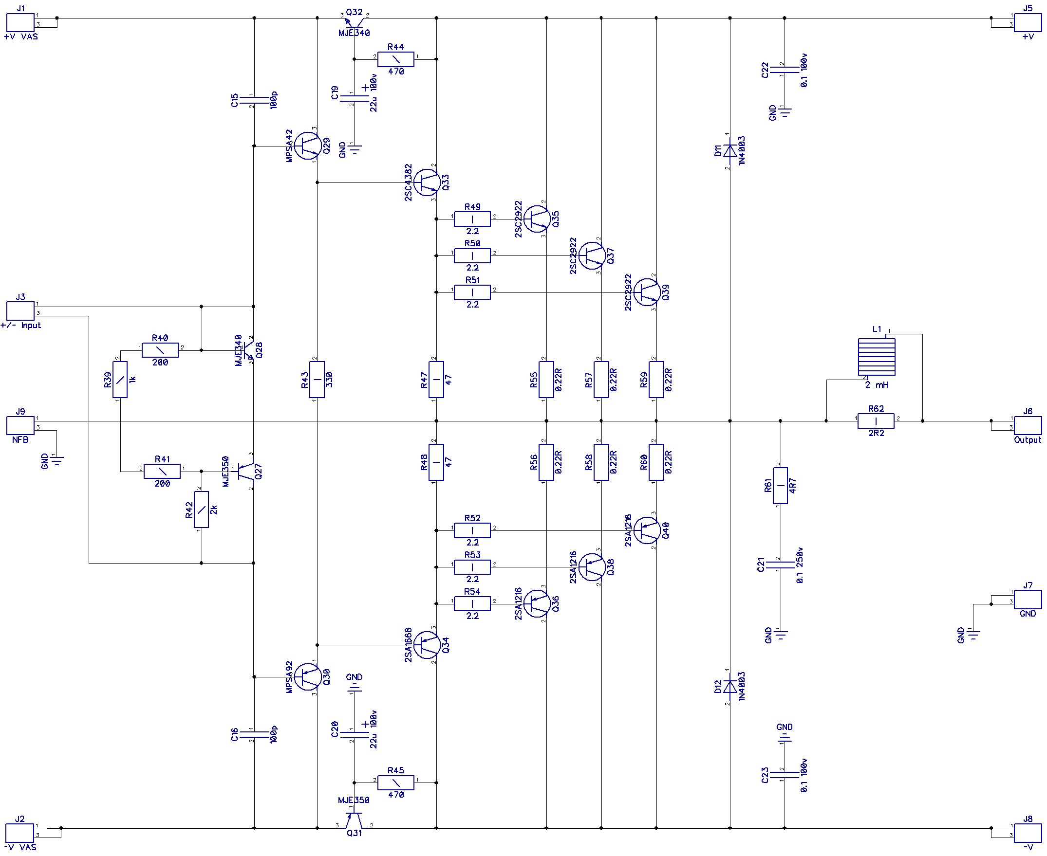

Hi All,
Here is my new "baby". Front-end with a vacuum tube IPS.
It is based on one of my previous (prototyped and tested) designs, with certain improvements implemented. Simulation shows very high parameters, promising a good sound.
Anybody interested in further development? 😉
Valery
nice try.
I would not like to discourage you, but after swiitching the amp on Q6 and Q10 will see the rail (because of cold heaters) what could destroy them (now I can see the trick with zener regulator)
anyway I like it even if I "see some troubles"😉

Hi Pawel,
I have addressed the start-up issue in post #33. Anyway, in the worst case, I'm ready to hit the rail for some time - my intelligent soft-start/protection system will connect the speakers only if it sees "0" at the output. But thank you for pointing it out.
Nice study by the way (memdist power amp). Especially IPS topology is impressive :up:
I use a simple EF3 OPS (number of OP pairs may vary) - see attached.

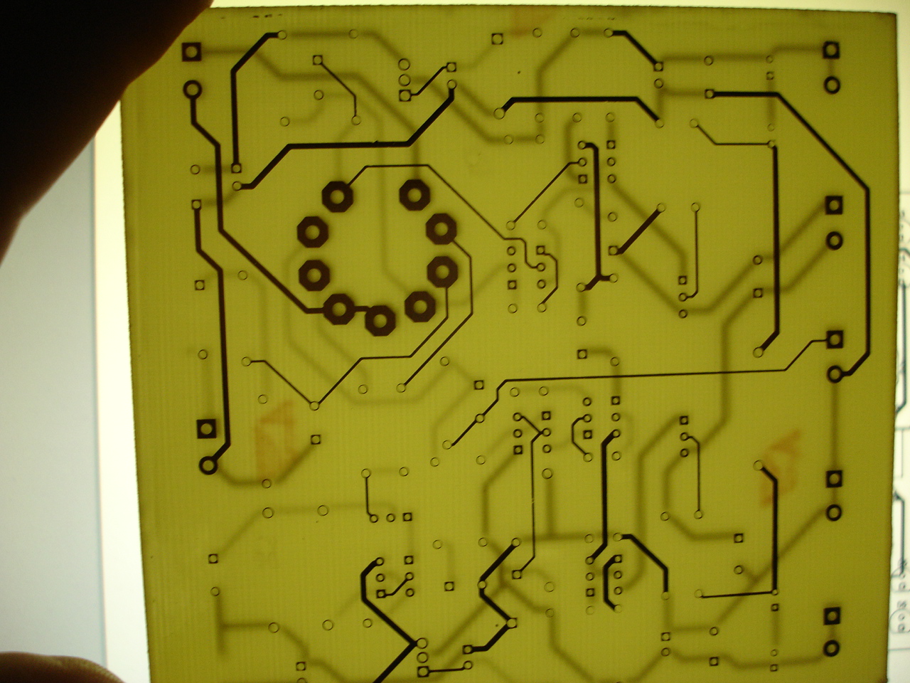

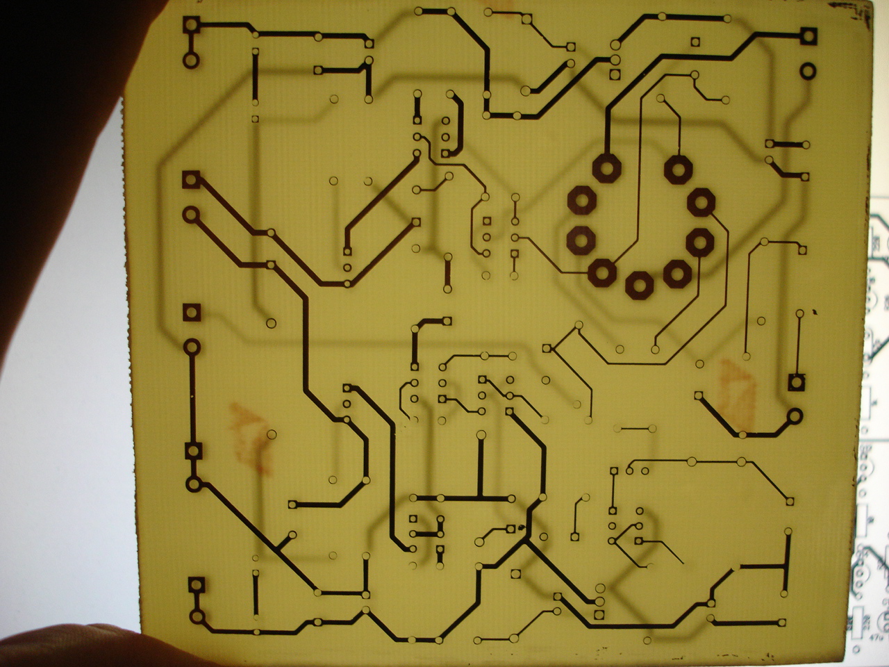

the first step
Slow progress, photoresist pcb board is old and the result isn't so good🙁
I believe that is necessary Valery uses some bigger width lines and pads,friendly to diy🙂
