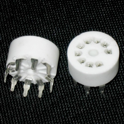

Perfect socket!
For the builders - example of a very good socket. Made of ceramic, designed for PCB mount, solid, great quality.
Purchased in a local online store. Less than $1 usd per piece. Got 6 pieces... for future builds 😉
could you put the link to the store?
Yes, sure - here is the link to particular product:

After buying the wrong ones first I ordered these. A little more money but supposedly "Gold plated". Coming from China so who knows when they will get here. I did get word that my PCB's have shipped so may see them in couple of weeks. Guess I need to buy some tubes. What brand did you say worked better for you?
Terry, these sockets look very similar to the ones I've got here with the difference of gold-plating, which is always good to have.

To fit these valve sockets to a PCB, what diameter holes need to be drilled?
Those are 0.07 inch holes, placed on the circle of 0.8 inch. Perfectly fits.
