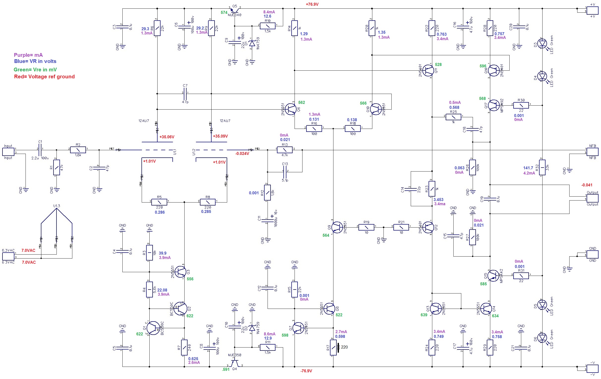

I notice in the pics you show of the pics you show in post #107, that you have some pretty large resistors in R6 & R9. Do these need to be high wattage?

R6 and R9 are actually 22K each and they don't have to be high wattage - 0.25W will do fine there.

Ok, my transformer came in, so with great expectations I began testing. I first hooked up each individual IPS using 470R resistors as load resistors fed to the NFB. The first board I tested finally settled at about 80mv offset. It doesn't settle completely but wanders up and down +-10mv. I get about 4.9V across the two 470R resistors so about 5.2mA output. I then bypassed the 470R load resistors and the offset remained the same. I set that board aside and tested the other. It settled at about 5mv offset but still varied +-10mv. Then I hooked up the first one again and swapped the tubes and it then settled at about 25mv offset. Things looked pretty good so I hooked them up to the OPS. I brought it up on the variac and light bulb tester and before I could get it half way up the negative side LED began to flash on an off and the light bulb tester shown bright. So then I backed the bias on the OPS all the way down and tried again. I was able to get the right channel to come up to full rails but not the left so I unplugged that side and tried working with just the right channel. With the light bulb tester in place I could get it up to full rail but it would surge about ever 6 seconds. The light would go bright and the bias would shoot up on the outputs. I thought maybe the light bulb was causing the surging so I bypassed the light bulb and went direct. I was still seeing the bias shoot up about every 6 seconds or so and then it blew the fuses. I guess I need some ideas on what to look for. I'm going to go back to just the IPS and try passing a sine wave through it. I'll report back.

Yes, lowering the output current may help. You can do it increasing R17 from 180 ohm to 220-270. Try it without the OPS first.

Hi Terry,
Thank you for very good currents/voltages map.
According to measurements, IPS circuit is well balanved, however, your experience with OPS attached shows there is a "hidden" stability issue (high frequency stability margin is enough when IPS works alone, but getting worth when OPS is attached).

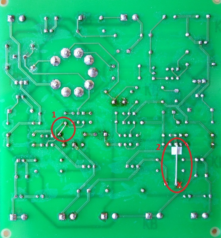

Picture 1 - PCB Bottom
- Cut one trace - marked by the red "X" at the bottom right side of oval "2";
- Solder two new traces - "1" and "2", bearing in mind the "2" one goes over the other trace (I used a small piece of tape to make sure it is insulated properly).

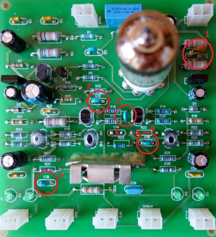

Picture 2 - PCB Top

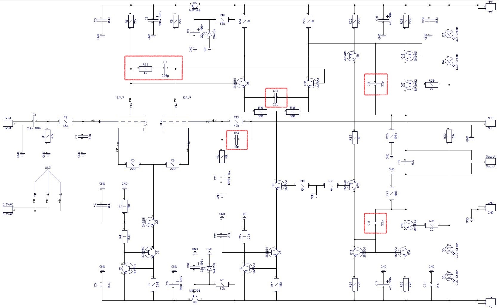

1) Remove C7. Put 47 ohm resiscor and 220 pF cap serially instead.
2) Remove C13. Put 15 pF instead.
3) Solder 22 pF cap right on top of R16 and R18 pins.
4) Remove C18. Put 22 pF cap instead.
5) Remove C15. Put 22 pF cap instead.
6) Remove C14 and R25 - leave those places blank (marked by red "X"s).
Picture 3 is just an updated schematic for your reference.

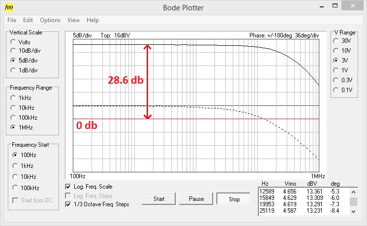

Picture 4 is a new Bode plot after all modifications.

I tested this one brutally, trying to actually "kill" it. Sound qualities are preserved, while stability is the one I could not break this time.
