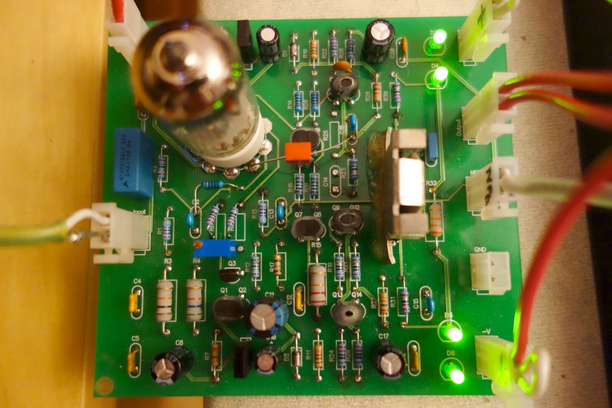

I will have to do more testing today. It was my second board that blew the outputs. It was already built per the original layout and I had to go back through the thread to find the various changes and replace parts, make trace cuts, add jumpers, etc. I need to go over it with a fine tooth comb this morning and make sure I didn't miss anything. When I did the testing on the board that seemed a success, I didn't' have a load plugged into it. I realized that when testing the second board. One other thing that could have attributed to the damage is that I mistakenly switched the amp off and on again while I still had the dummy load attached. Thank God it wasn't a speaker and thank God I still had it running through the light bulb.. Still I can't be sure that didn't damage anything. More testing to come. Looks like before I do any testing with a speaker, I should include the protection circuit in the mix.

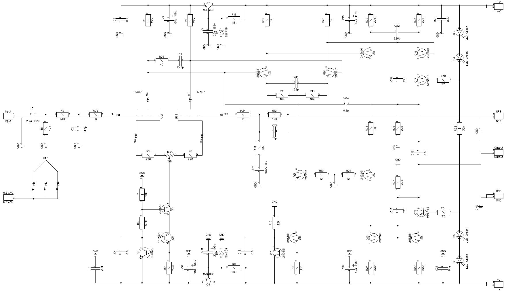

"As built" schematic
Hi All, just did some more research and testing with regards to providing stability during start-up and shut-down, when the tube may be not fully operational. C23 (6.8 pF) in position as shown provides firm behavior in all transition modes, also slightly increasing phase margin in normal operation. Orange cap on the right from the tube at the picture.
I have also put a 50 ohm trimmer between the input LTP cathodes - works fine, allowing fine-tuning the DC offset at the output. R35 on the schematic, blue multi-turn pot below the tube at the picture.
Running nicely for couple of days.
I love the way it sounds 😎
Jason, I recommend this one for your build.
Terry, I suppose, this one will be good for you as well, however, bearing in mind unexpected behavior of your build, please be careful.

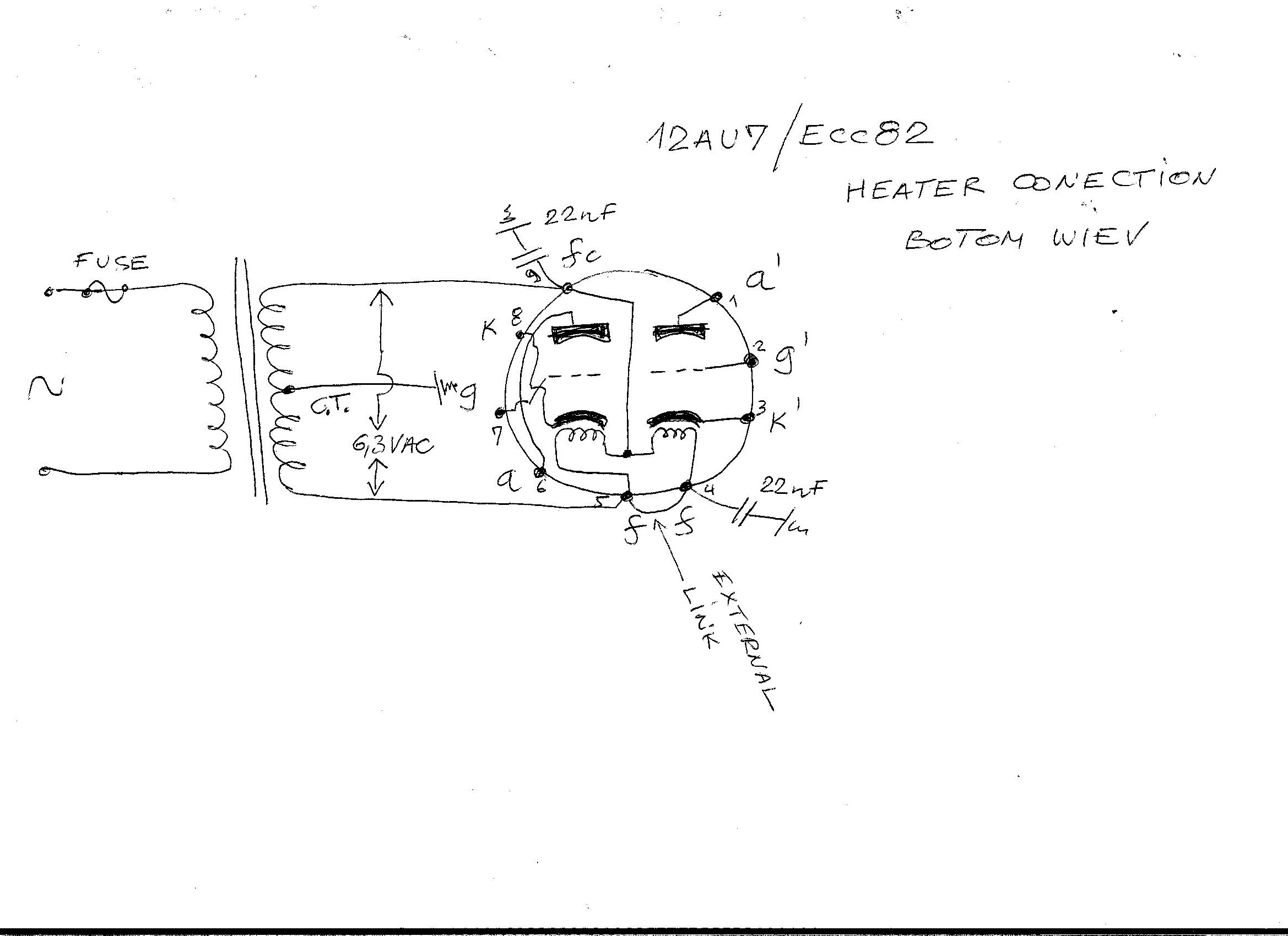

Check this schematic , it is about of correct connection of tube filament with 6.3 VAC voltage from small tube heater transformer , and don`t forget that both LTP cathodes stays on relative high impedance , so parasitic capacitance between both cathodes and both filaments can introduce hum or some other unwanted effects .
All three secondary wires need to goes twisted up to amp board .
Best Regards !
Hi Banat, thank you for recommendation - I've got no central contact at my transformer, so I use a fully "floating" heating supply with no issue.
