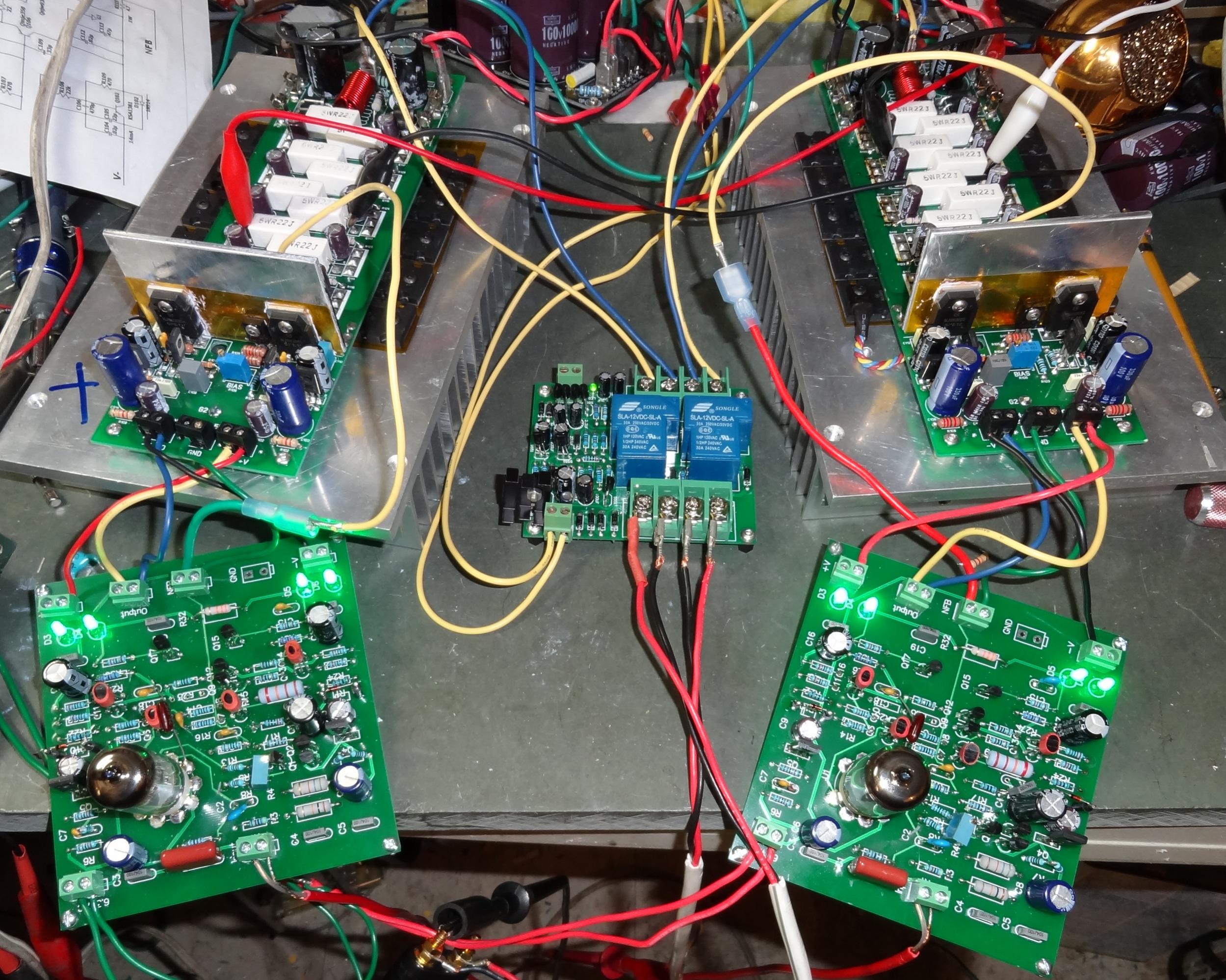

Hi Valery,
Success, it is finally playing. One channel is noticeably louder so I must have missed one of the resistor changes somewhere. I have to sit down again and go over everything. It sounds nice but I can't tell if there is much difference yet because of the imbalance. Fools my ear when doing an A/B comparison. Thanks for all your help.
Blessings, Terry
Blessings, Terry
Hi Valery,
Blessings, Terry
Noticed your message too late - was going to recommend checking the feedback network (that's the only thing setting the gain here), but then noticed in the other thread you have solved it yourself 🙂
Nice Terry, so what changes did you make to get it working ?
I have the boards set up per the schematic in post #246 After going over the boards I discovered that I had 100k in R13 instead of 47k in one of the boards. I'm not sure how that happened but as soon as I put the 47k in it works perfectly. I have had it playing for hours now and no issues. I modified my speaker protection circuit to have a 25 second delay so the hybrid has time to settle. 25 seconds feels like a long time. 😉

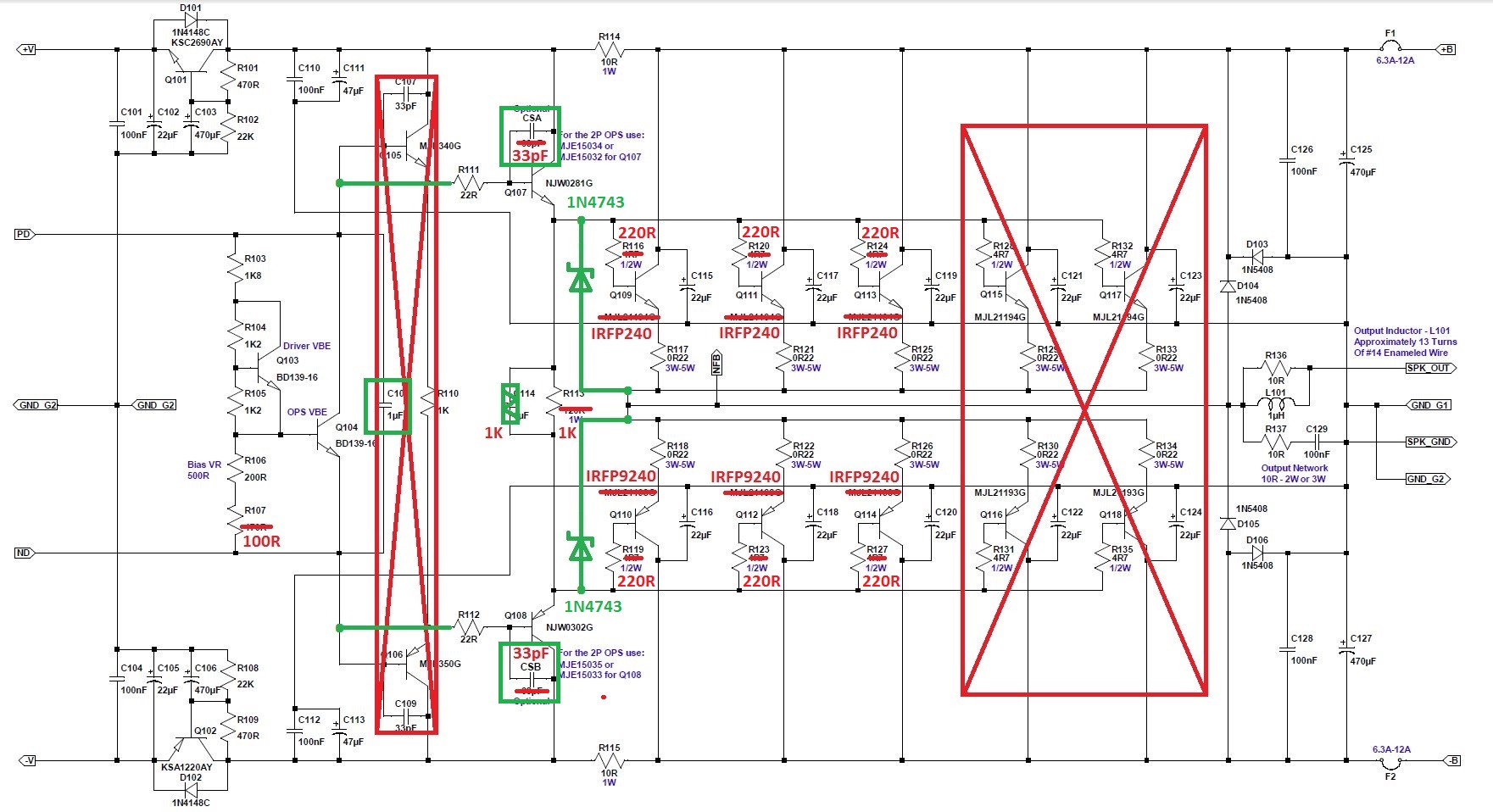

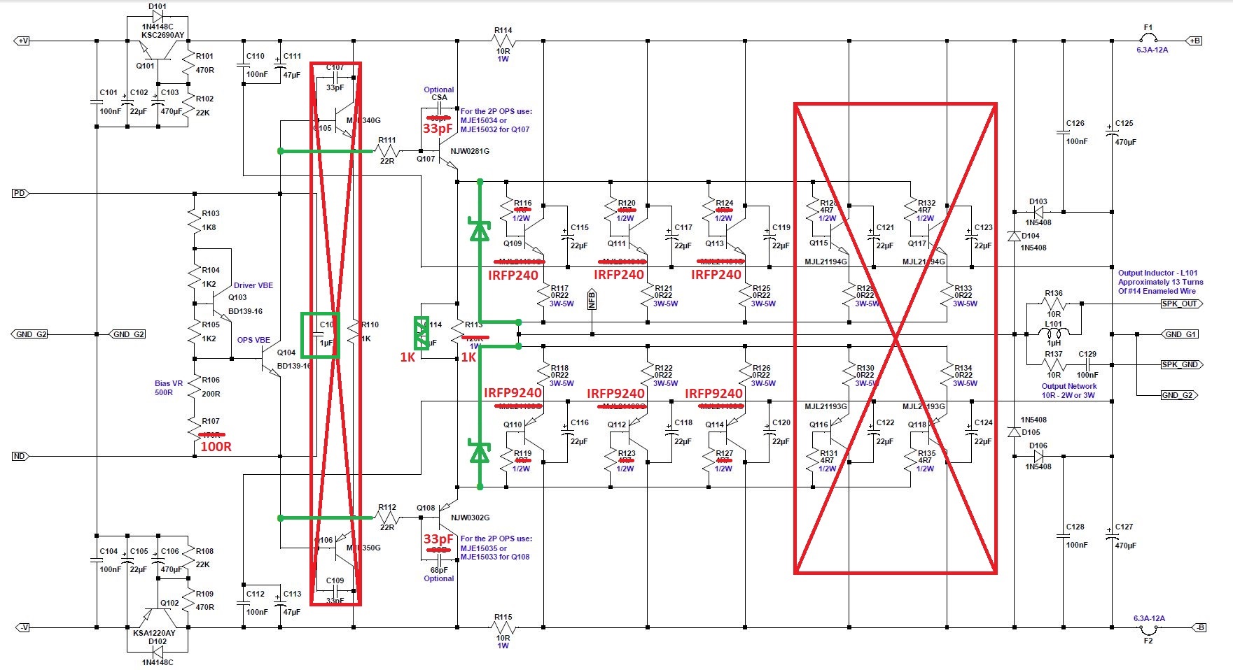

Hi Valery,
I have a question about the MOSFET OPS. I want to discuss it here if that is OK. you didn't mention it but it looks like you have removed the base stoppers for the outputs. Is that correct? It also looks like you added zeners from the output to the base of each side but you don't give a value.
Thanks, Terry
Thanks, Terry
Hi Valery,
Thanks, Terry
Hi Terry, thanks for observations - I actually forgot to put the values, here is the updated picture.
Valery
