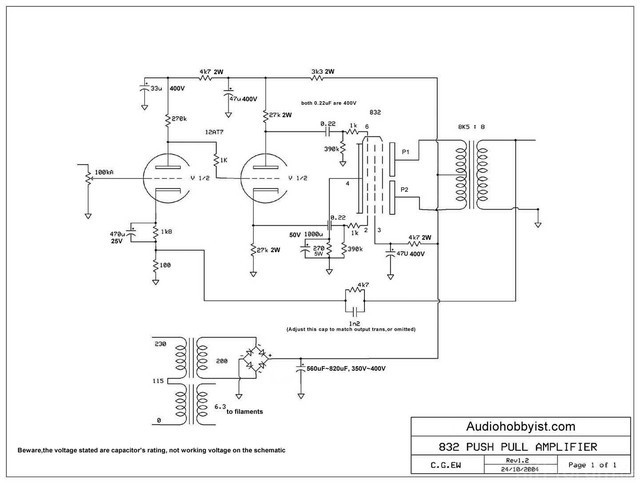

Unfortunately the author 's website has not been working for some time ... I have only scematic in the archive in poor resolution. Very compact and pleasant-sounding amplifier - approx. 7W. A slightly more "massive" power supply in my build with russian tubes - 6n23p and gu32.
Maybe better resolution:
https://taooftubes.files.wordpress.com/2010/04/32dd4-832sch.jpg

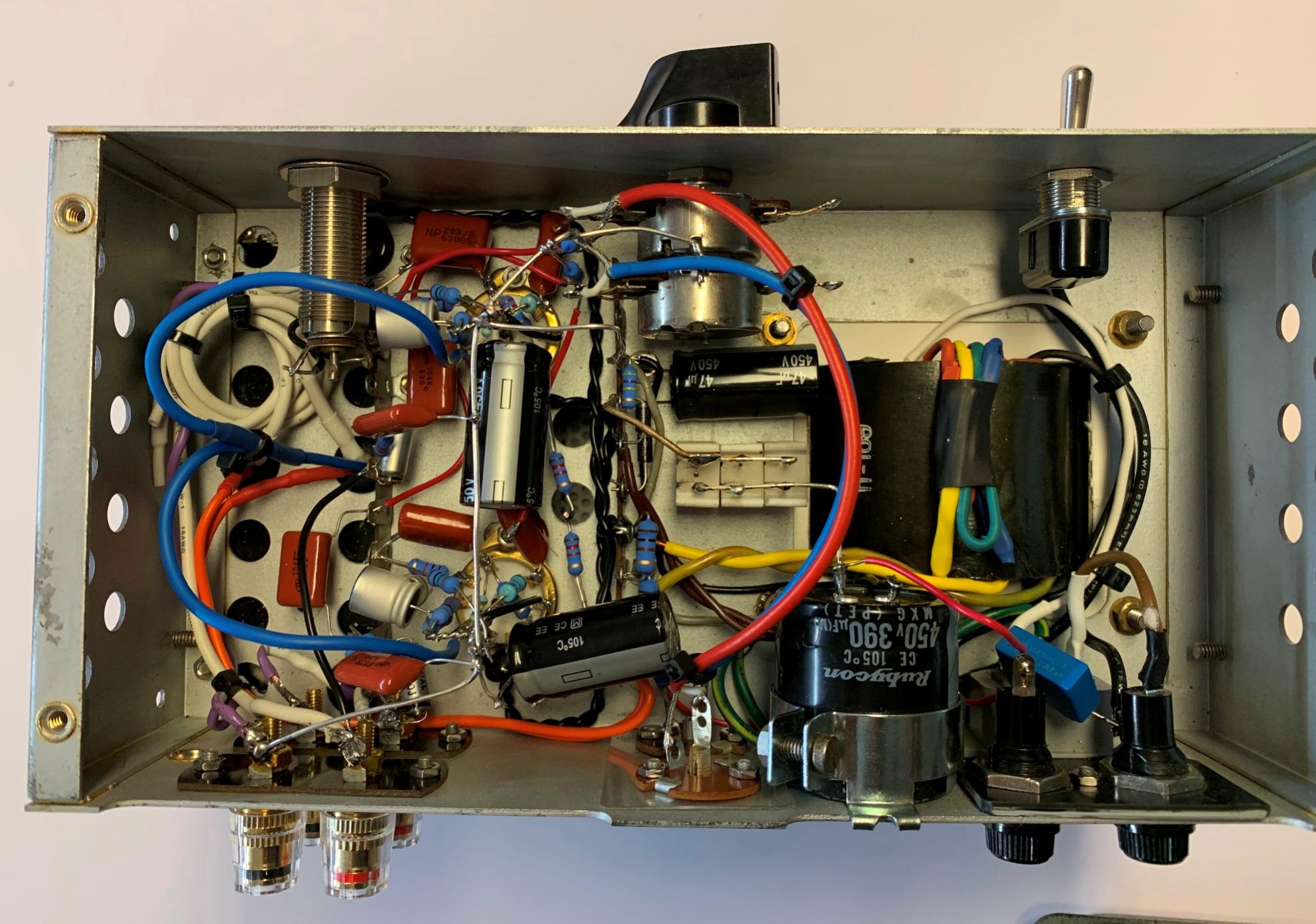

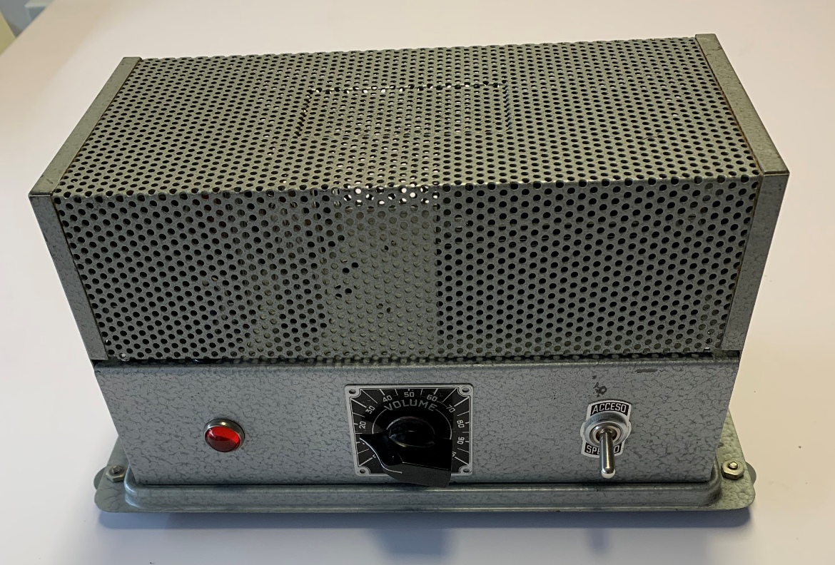

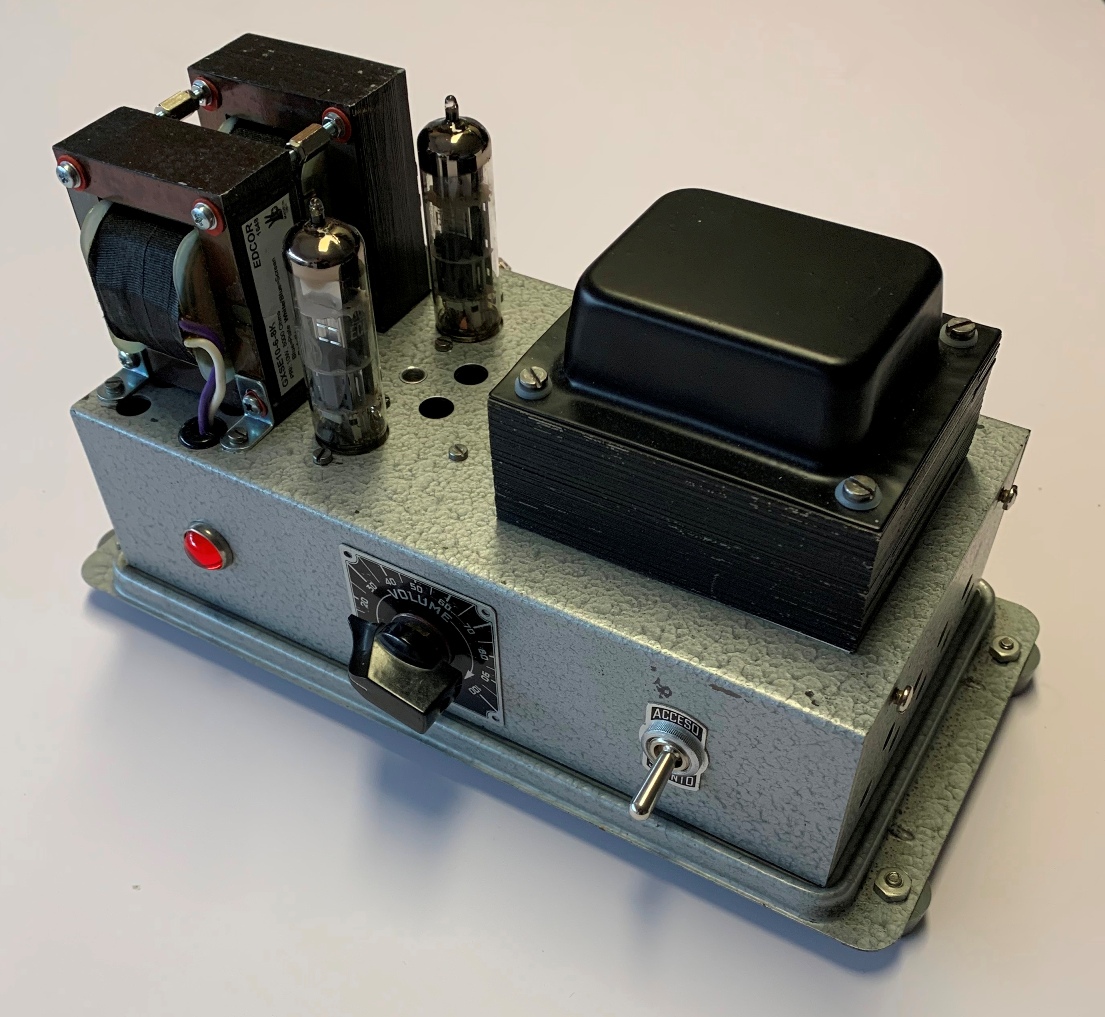

I followed the jhstewart9 advice at post #30 and yesterday I've built the single-ended ECL86 / 6GW8 Telefunken reference design I attached to post #54, reusing a nice vintage small chassis I had around and Edcor GXSE-10-6-8K output transformers (10w, 8k primary, 6 ohm secundary because my speakers are 6 ohm). I only listened to it a few hours, but I believe to have found a worthy replacement for my Lingwendil 6SN7 push-pull flea amplifier. If somenone want to try by itself, here are my quick build notes:
- I had to lower to 47 ohm the feedback resistor between the negative terminal of the volume potentiometer and ground. With the original 110 ohm resistor and 6 ohm speaker, the amplifier was motorboating at low volume. I will maybe try 82 ohms later.
- Removed the RC network (10nF 51k) from the extra tap of the (vintage) volume control. Too much attenuation of high frequency. It may be possible to use a modern standard potentiometer.
- catode capacitor is now a Kemet 560uF 25V Aluminum Organic Polymer. Cathode resistor is two 330 ohm 1W resistors in parallel (165 ohms).
- instead of the single 2.5k resistor on G2, I used two 1.2K 1W resistors in series.
- I had to swap around the Edcor secundary windings (purple to ground, white to positive terminal).
- I removed the 300pF capacitor in parallel to the output transformer primary.
- The output transformer wire connected at the pentode anode must be routed as far away as possible from the components connected to grids, or oscillation may occour. The 1K grid stopper is essential.
- With 280V supply, voltage at the output pentode cathode is 7V. Dissipation is right at the datasheet limit.
- Some ECL tubes don't like the grid leak polarization and are noisy. Most tubes works perfectly fine without any noise (I tried about 20 tubes, NOS and used). I am currently using 6GW8 Fivre tubes (RCA licensee).
- I was forced by the small chassis (23cm / 9 inches wide) to place output transformers close to the power transformer, so there is very faint 50Hz hum due to magnetic coupling. On ECL86 Mullard/Philips circuit, when the tubes start working the hum disappears due to the high global feedback action. It was counting on it, but it does not happens on this circuit. I will maybe try to replace the power transformer with a shielded one, or add a copper belt around it.
- There is no need to attenuate a modern 2V source, input level is fine.
I have not done measurements yet: the amplifier has ben built according to the schematic, so the Telefunken performance statements should be true. The sound does remind - unsurprisingly - a high quality german tube radio from this era. The frequency response does have a slight bass boost while highs are attenuated just a bit. This works exceptionally well at low to medium volume, but the power is enough for the occasional musical peak without noticeable clipping. Nice vintage sound, I like it. By the way, due to the low parts count and uncritical circuit, this is a true weekend build.
