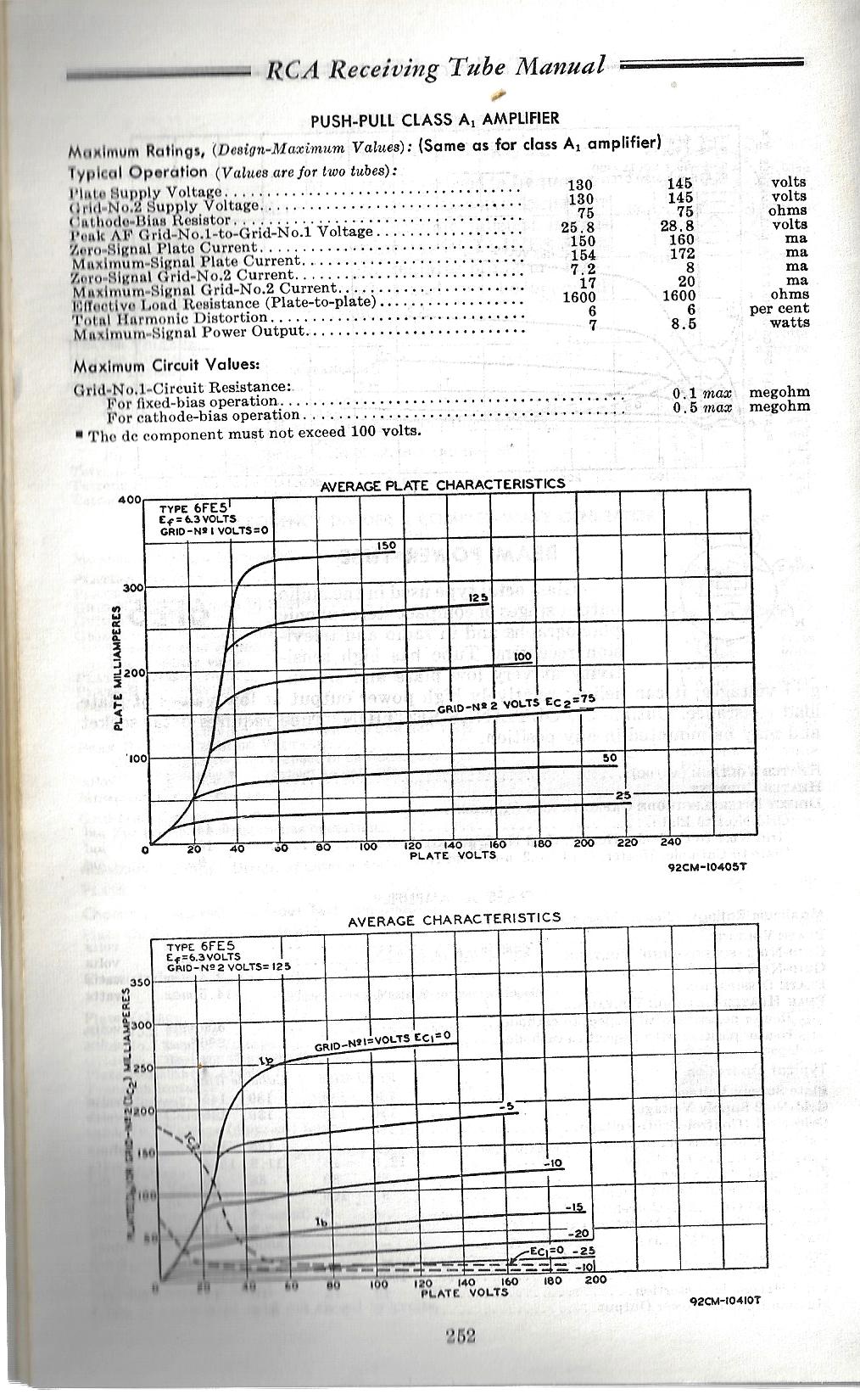

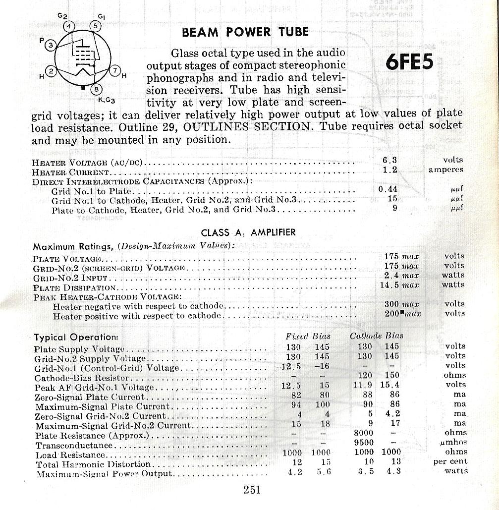

PP 6FE5s. PP KT55s if you can find some Or KT33. 7W on 150V supply no problem.
