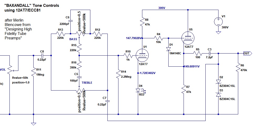

Well, going back to how I listened to music when I was a teenager... I used to leave the Bass control almost cranked, all the time. I'd tweak the Treble control to taste. So... Tone controls!

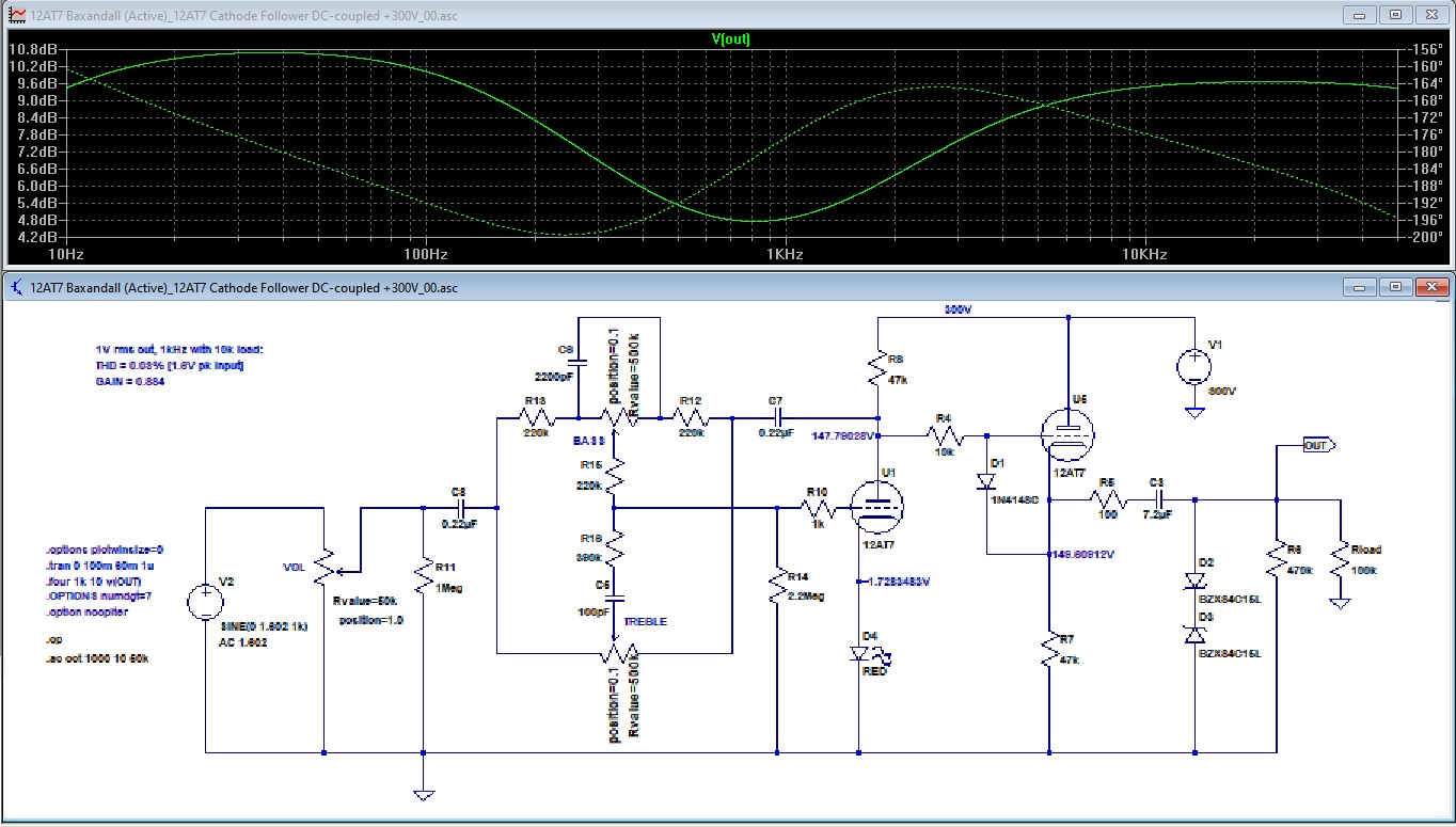

The active Baxandall tone controls can be done using a 12AT7 or similar high-mu triode with reasonably low rp. MerlinB wrote about this in his hi-fi preamp book. I've modeled it in LTspice and it looks like it should work pretty well.
Only +/-6dB boost/cut, though. Would that be enough?

This works even better. 3X lower THD, less insertion loss, smoother EQ taper. (Edit: Remove/short out C7. It's no longer necessary.)
