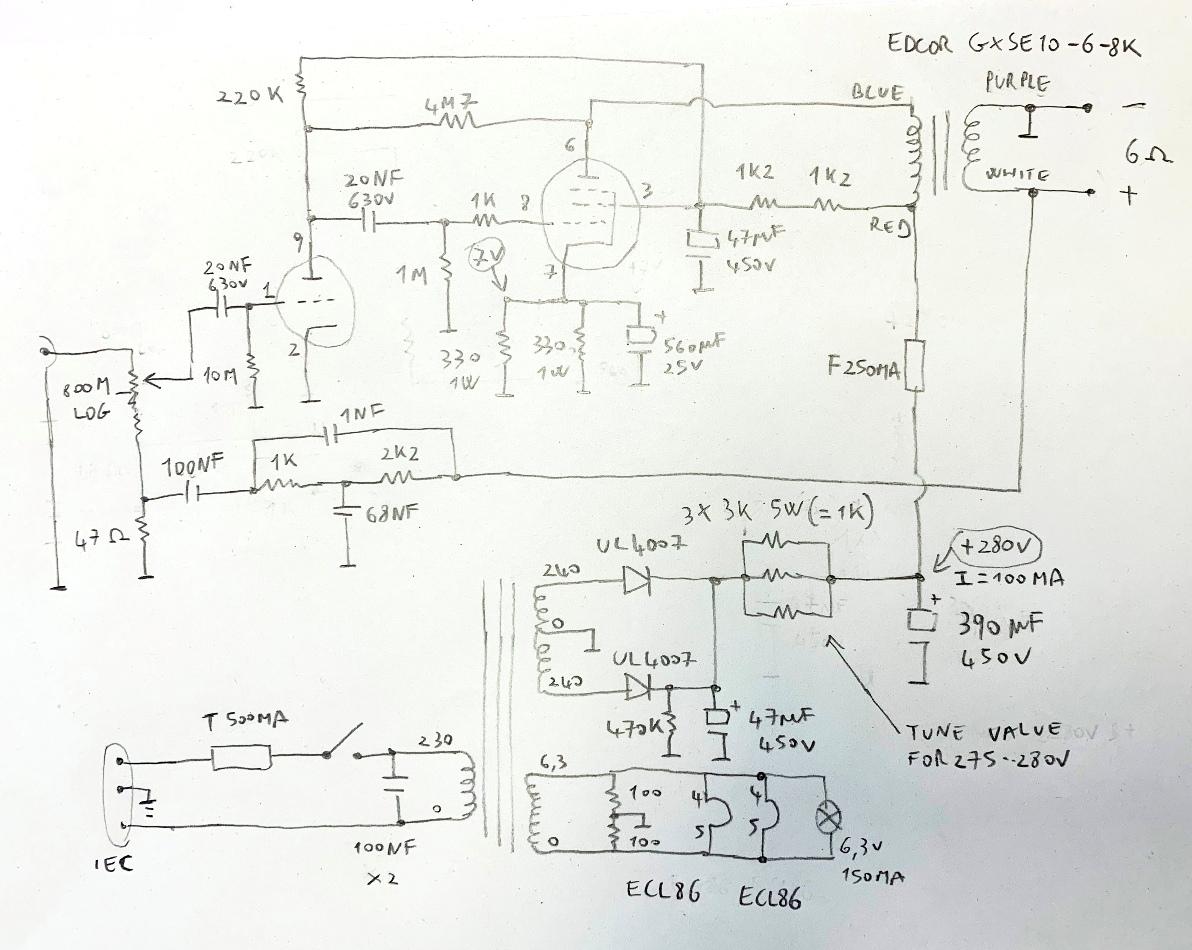

Yes, it would be nice to have the actual circuit diagram because looking into the ECL86 data sheet's published diagram
it is not really clear for me what you actually have done.

The schematic is attached to this post. The 1K resistor on the power supply becomes hot and must be secured to the metal chassis. I choose this arrangement instead of a 210V transformer to avoid a filter choke due to space constraints. I hadn't high expectations because tube manufacturer sample circuits were often tested just on paper or at the lab bench, but the unknown Telefunken engineer that designed this circuit must have tweaked the feedback RC values by ear, because it is not possible to nail the response so nicely just by staring at a oscilloscope screen. It surely knew its job. I selected this Edcor transformer because it is close to the commercially available quality SE transformers of the time.
It is marked 1M, but it measures 800k (Kiloohms). Normal tolerance of parts from early '60. I used it because I wanted to build the amplifier as close as the original schematic as possible, but at the end I left the extra tap unconnected: a modern 100K potentiometer will probably work (and will have a better tracking).

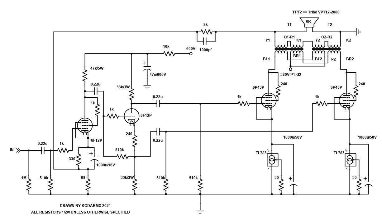

This is my take on a low powered amp. Going to be reconfiguring my old DC7 amp to look like this over the next few weeks. Good for 7W and maybe a bit more. I would say that the tail of the input LTP will need a little negative supply, with it not been ideal.
