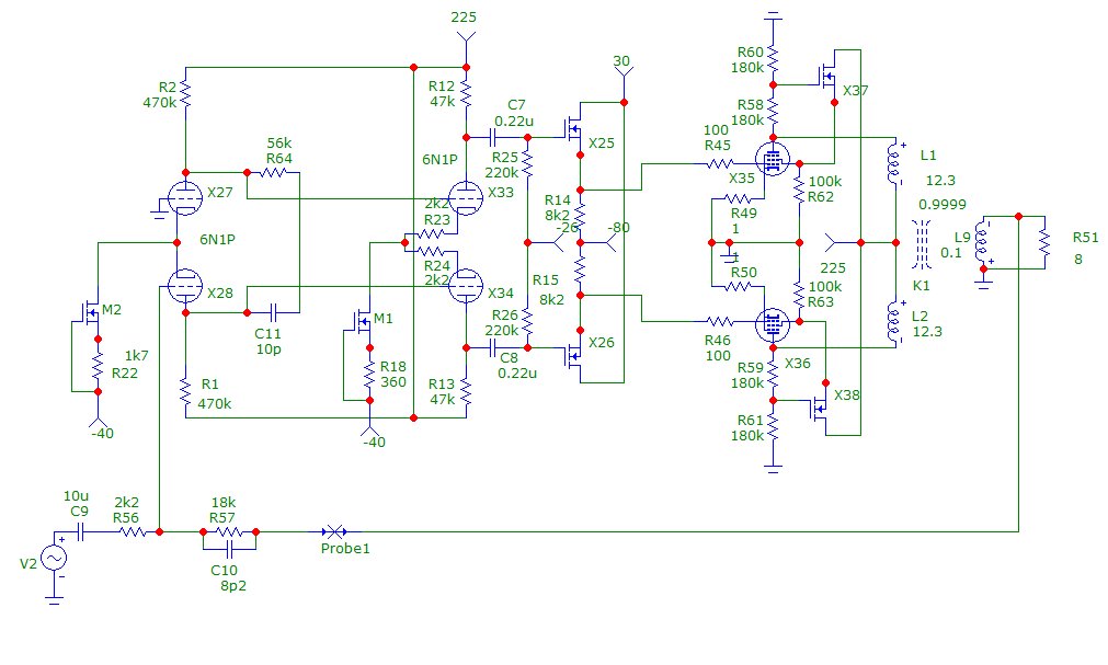

My definitive recipe for an amazing bedroom amp is as follows:
-Use ECL82 in a PP, but use Russian 6F3P as a quad of winged C can be had for the same price as a typical single western ECL82.
-Use garter bias on the output stage which will give you around 5watts of class A. Triode strap the pentodes.
-Use Antek 10-20VA toroidal power transformers as OT
-use the two triode's as a LTP up front (this will benefit from some sort of negative supply to stiffen the tail), Drive one side and use the other as a gNFB point from the OT secondary.
-Use a Florescent light ballast as a choke in the power supply.
-filter the input with a LPF below 40hz and use a small dedicated active sub for 10-40hz signals.
This should be a very simple, cheap and compact amplifier which can be housed in either an old recycled transistor amplifier case, or as I did in a 1U rack mount case, and will depend on how much you were prepared to use salvaged parts. I find dead PC PSU units make excellent donors of 250V caps for this scale of amp.
This should be powerful enough to drive even standard bookshelf speakers of 88db/w efficiency to bedroom listening levels.
Such a design could be made for about €100 depending on how much the power transformer could be sourced for.

The high impedance grid tends to act as an antenna.
I would usually connect it to a low-impedance source. However I know some grid-leak-bias amps driven by crystal microphones and insignificant garbage.
But I don't mean to doubt your observation.
Shoog, I am amazed to read of successfully using global feedback from the secondary of a power transformer; have you ever scoped it? What size of compensation caps are you having to use, typically?
I do it all the time. I typically use 1000pf||2k connected from the output to the midpoint of the first stage cathode resistors (cathode, 330, 68, Gnd. 330 bypassed with 1000uF).
For a low power amp, you don't need to double the transformers (interleaved primaries, series secondaries) but the LF power out will be low 15W@1kHz, 2.4W@20Hz... Doubling the coils will get you 15W@25Hz.
I have a pair of these speakers, and they are useable down to ~40Hz and they are 4s! No need for a subwoofer in my case. a 7W SE amp will drive them loud enough, but 50W is better

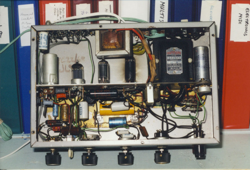

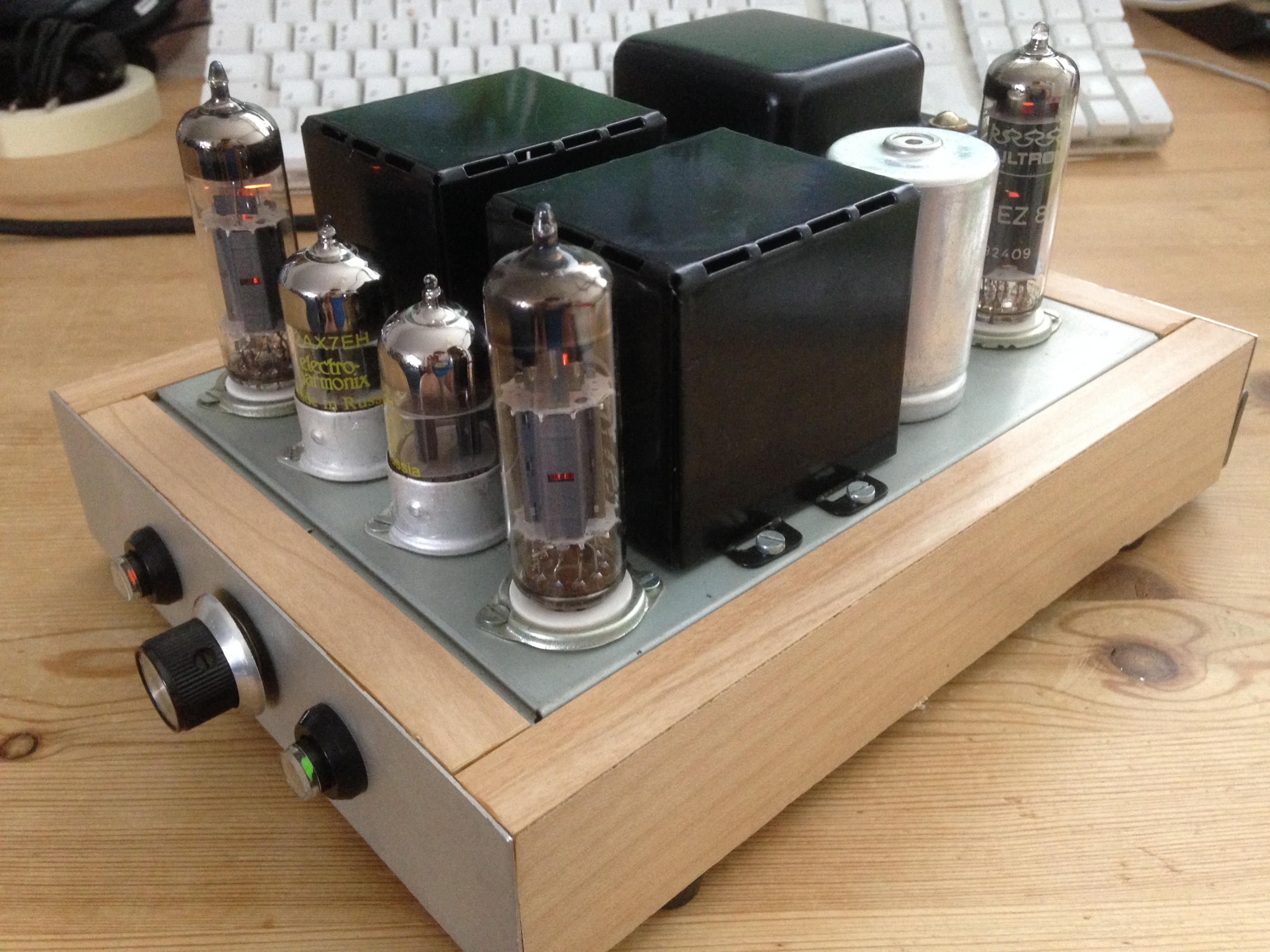

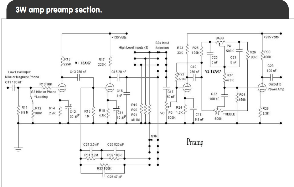

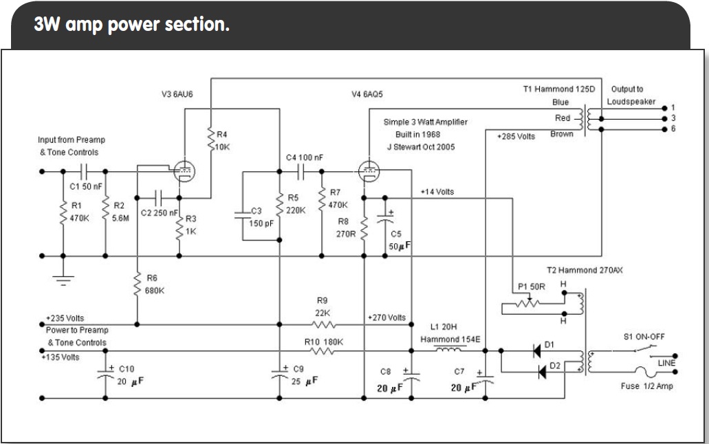

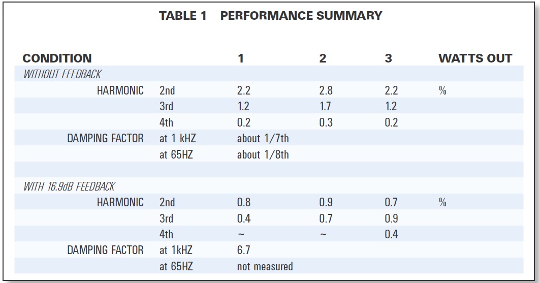

My 3W Amp
One of several I've built this version uses 6AU6/6AQ5 in a FB pair. It is completely integrated with Baxandal Tone Controls & a Magnetic Pickup Preamp on board. The 12AX7 preamp heater can be shut down when not in use. Built in 1968 it runs everyday with separate Eico AM & FM Receivers.in the workshop. Think the 6AQ5 has been replaced once. Imagine that for reliability.The PS is SS, the rectifier diodes are Philips Top Hats from another era.
Unlike many other amps on DIY this one is completely documented with real test data. All built inside a Hammond 8x12x3 steel chassis.
The assumption seems to be that response will be poor so compensation will be difficult. I have found that a toroidal will have better response than many dedicated OTs if attention is given to eliminating DC. That is what the garter bias is for.
Shoog
Yes, I have found too that mains transformers give excellent results with low impedance tubes; I myself use current sinks to eliminate DC, as far as possible. My assumption was that the unavoidable shunt capacitance would have lowered the resonant frequency to the point that global feedback would be problematic.,
The only down side with grid leak bias is that it is inherently more noisy, it will always hiss and pop more than a conventional cathode resistor.
Shoog
The reason is not so much the high impedance so easily picking up interference. After all you tend to have a low impedance source.
It is the thermal noise in such high resistance as well as the shot noise due to the grid current in the old carbon comp resistor. A modern metal film will have the same thermal noise but very little of the 'pop' in shot noise.
You could be right on that.piano3
You could also take the feedback from the plate of the output tube.
I generally use CCS for my DC balance, but when dealing with such low power garter works equally well and is minimally wasteful. I have seen people suggest garter for 6AS7 PP which is horribly wasteful and expensive to achieve.
Shoog

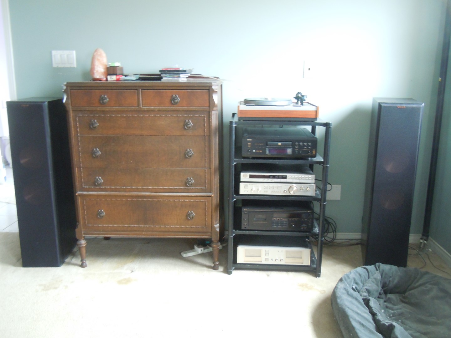

In my bedroom system (I use a Luxman M02 / C02 / T-03 system (150 wpc) driving a pair of newer Klipsch dual 8" towers (99 dB / watt). I run it quiet at night and while watching thee TV monitor. In the morning I run it louder on the radio, and even louder on the CD. Mostly 'cause I can . I modified all the equipment for higher performance. I had to fix it anyway as the amp was blown and overheated.
Sure it's a bit over the top, but I love great music and I was able to trade something for the system. Also, there is a 1930's table radio (tombstone style) radio we listen to some times. So I have that range covered I guess.

That is a very nice design Mr. Stewart! That cathode biasing on the second tube puzzle me: why did you do the bias adjusting this way? Is there a specific reason for that? If I am correctly interpreting it of course.
Hi Joe,
