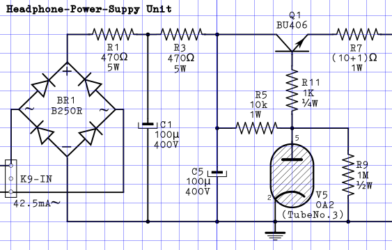

Oh yes, I am certainly aware of this. But I am not intending in any way to use a 0A2 as the regulator, just as the reference. A set up like this:
But to recall: I want to make a flea power amplifier of about 1 or 2 watts RMS power.......

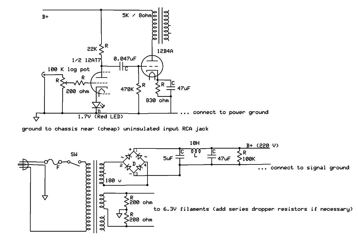

This John Broski amp would be a good one for a 6BQ5 PP, cant get more textbook simple. Its on my to-do list as well using some Edcor OPT's I have already and Antek torroid I have already. For similar purpose, as compact as I can build it.
Its not shown with a screen tapped OPT here but it might be fun to have a triode/ultra linear/pentode switch on the back.

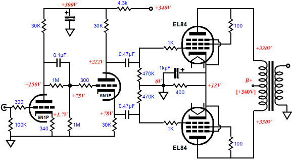

from a beginner... what is the purpose of the 1 Meg resistor across the coupling capacitor?
It forms a resistor divider at DC to set the bias of the phase splitter. You could also use a floating cathodyne too.
