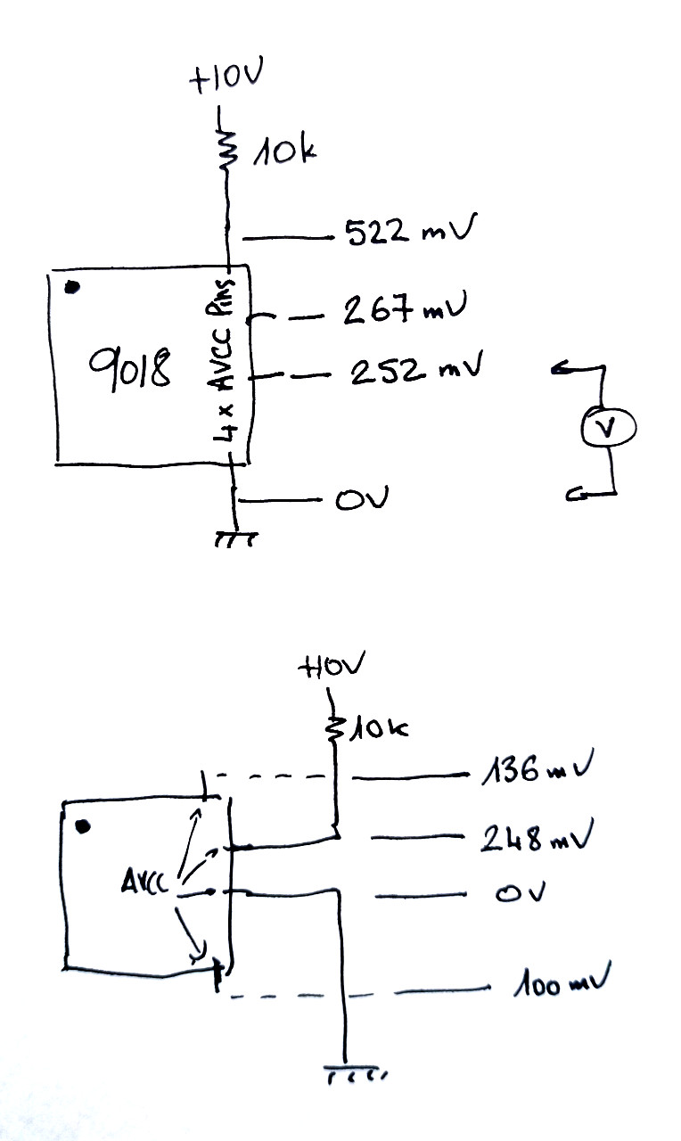

No sane manufacturer will wire bond high current pins with 25u gold wires. That’s what aluminum wire bonding is for. Check a power device of your choice. You will note multiple aluminum wires to the emitter/source pad(s).
High current pins? I thought this discussion was about an audio DAC. Those usually don't draw more than a few hundreds of milliamperes.
If what you measure is correct, this men’s all AVCC pads are not shorted by the metallization layers, but through diffusions.
Not necessarily, when both pins are double-bonded with 4 mm long, 25 um thick gold, that already gives you 0.2 ohm. Besides, the on-chip metallization also has resistance, usually a few tens to a few hundreds of milliohms per square.
It would take some effort to make a 0.2 ohm connection in diffusion layers. Highly doped and silicided layers typically have a sheet resistance of the order of 15 ohm per square, so you would need a connection that's 75 times as wide as it is long. If you want such a low-ohmic on-chip connection, it makes more sense to use some thick metal layer. If the intention was to keep the AVCCs separated, then obviously something must have gone wrong when the resistance is only 0.2 ohm.
I doubt the measurement is correct or there is something being missed. ESS is presumably not stupid enough to bond out 4 pins per AVCC input only to achieve 0.2 Ohms. In a high resolution instrumentation-grade converter I am not sure 200 mOhms would be acceptable for a voltage reference input, and this one draws more current than typical DAC or ADC reference inputs.
When the resistance between two AVCC pins is 0.2 ohm and they are internally connected by huge thick-layer metal grids, four pins together give you a bit over 0.025 ohm between the external and the internal supply: 0.1 ohm in series with 0.1 ohm versus four times 0.1 ohm in parallel.

I misread Peufeu’s test conditions and assumed the equivalent resistance was 0.2 ohms, not just between two of the four pins. Seems more reasonable with four.
I dug out that 9018 test board. It has 1R resistors in all the power supplies to measure current. Took them out, which gives direct access to AVCC pins for a Kelvin resistance measurement.
Measured resistance is sum of bondwires + internal chip metallization so it is not exactly obvious what the share of each of those in the total resistance is... but the values are coherent with a longer path from top to bottom than between the two pins on the side.
On top pic, current flows between top and bottom pins, the two side pins act as kelvin sense, so there's 15 mOhm on-chip resistance between them. They're probably connected to very close pads on the chip.
On bottom picture, that would leave about 0.12 ohm per bondwire for the side pins (nitpickers will substract half of the previous 15 mOhm to that). The two pins on top and bottom act like kelvin sense and confirm this.
Top and bottom pins seem to have a bit higher resistance.
