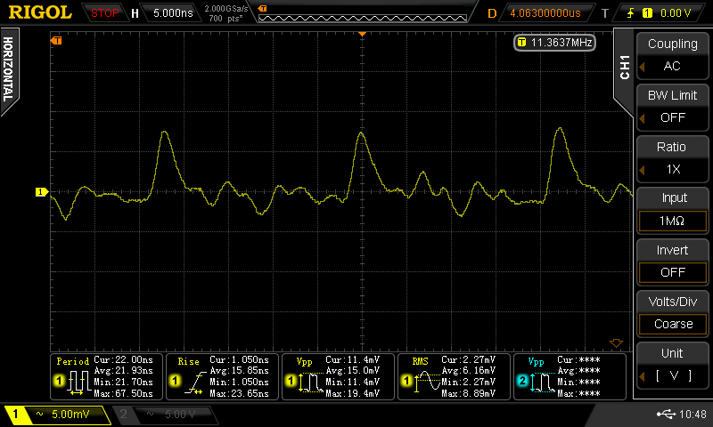

I measured the resistance between two AVCC pins on ES9018. They're internally connected (proof: current drawn by one channel shows up on all the AVCC pins) but the resistance was surprisingly high, a few tenths of ohms. I agree that it's quite surprising and I expected much lower. I'm quoting from memory, unfortunately that ES9018 is soldered on a test board, so I can't measure it now.
But the OP asked about analog signal at the output,
ES9018 output in voltage mode. It looks spiky, but the amplitude of HF clock leakage into the output is actually quite tiny. The spikes have ~ 1ns rise time and ~10mV amplitude. This is only 10V/µs ! Not worth panicking IMO.
As far as OP's TI DAC is concerned, probing with a scope would answer the question.
A 25 um thick gold wire of 4 mm long is about 0.2 ohm. Above 10 MHz or so the inductive reactance dominates.
Not sure what you mean by “current drawn by one channel shows up on all the AVCC pins”, perhaps you mean voltage? If what you measure is correct, this men’s all AVCC pads are not shorted by the metallization layers, but through diffusions. Meaning that it is absolutely required to connect all AVCC pins to the power supply.
