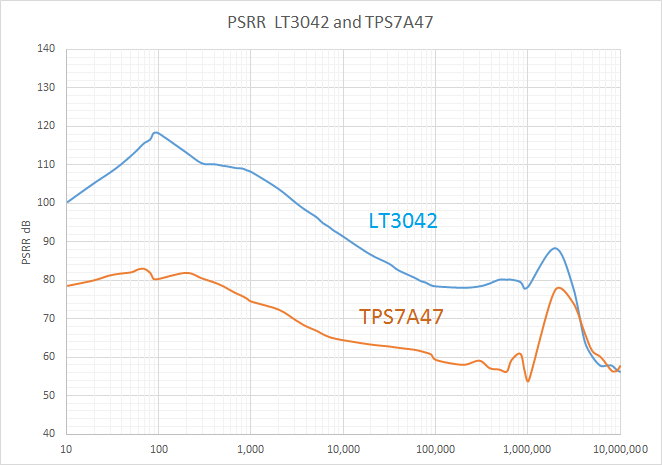

Interesting part, no? Compared to an LT3045 it has lower RMS noise, lower voltage dropout and twice the maximum current. It seems to recover faster from transients too. LT3045 continues to have the higher PSRR over most of the range (the entire range?).

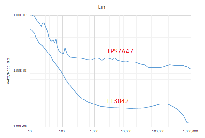

TPS7A94 has unfortunately quite high LF noise (2-3x LT3045). RMS noise it not very important. Besides TPS7A94 is max 5.5V part.
